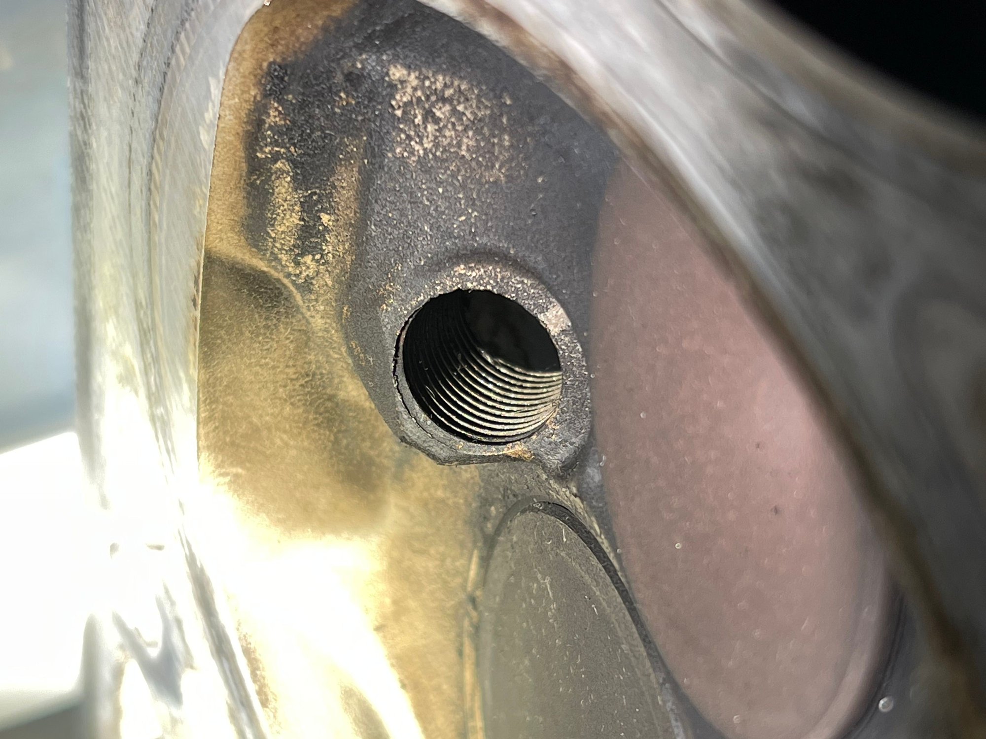

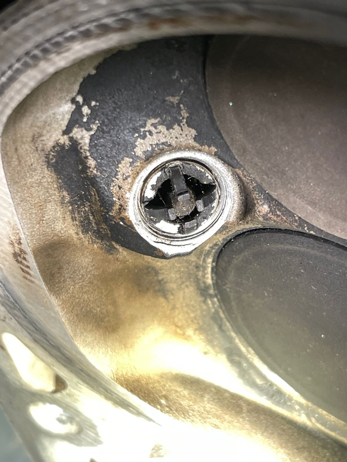

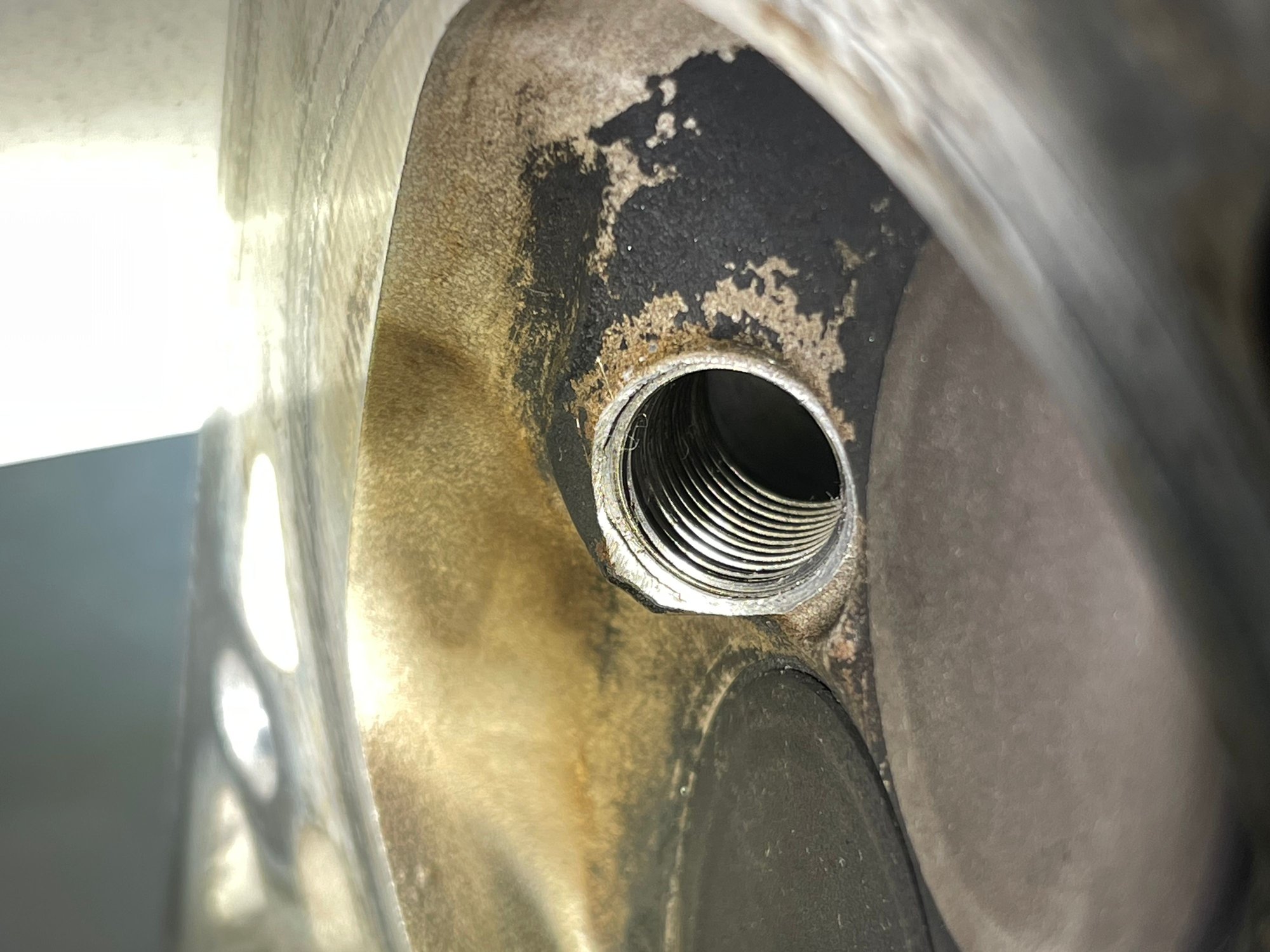

If we are talking about Time Sert, only some of their inserts are aluminum. Their standard inserts are steel. Another issue with inserts on LS heads is that, unlike DOHC heads, the inserts don’t match up well to the inside of the combustion chamber. You tend to get a messy, sharp edge from the enlarged hole. And the insert does not extend all the way through. This can be largely cleaned up with a small file if the head is off. But if it is done over the hood without removing the head, this could be an issue in terms of creating detonation-promoting hot spots.
This is a spark plug hole in a 243 head that has been rethreaded with a Time Sert and filed to make it cleaner.
For comparison, this is a spark plug hole on the same head with good threads.
This is the repaired hole with a spark plug.
