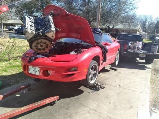

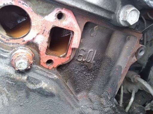

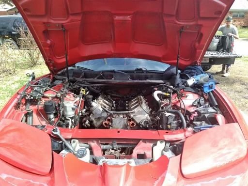

If you want to hang with the newer cars and get the most out of your car the first question is your 02 TA an automatic or a stick?
A high quality torque converter (Vigilante, Yank, Circle D) will do more for an automatic transmission 02 TA than a cam swap.
Given the car has a 6.0, headers, cam of some sort & was tuned, that should make a very good starting point. How are the tires on the car? Good tires are as much safety as performance. Check the date codes, check for cracks & condition etc.
Can you share a few pictures of your 02 TA with us?
Yessir here are a few of when I got the gaskets replaced and just a whole picture. My transmission is automatic and I just replaced the tires with 295 continentals.
