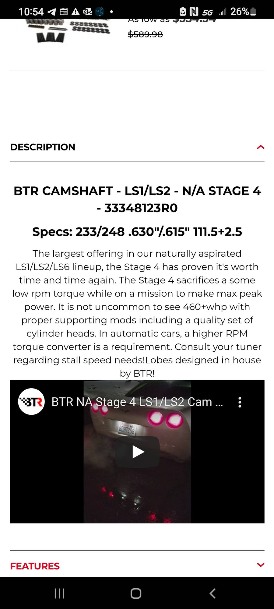

I'd look. at a Brian Tooley cam, they have everything from mild to wild but the NA stage 4 with their .660 spring kit, titanium retainers and chromo pushrods would be where I started as well is making sure you have a trunnion upgrade. On a 6.0 I'd expect 450-460 rwhp with all the rest of the supporting mods on a good tune
I was actually just looking at this last night and didn’t seem too bad for me but since it just says “n/a stage 4 cam” how would I know if it won’t be too much lift or duration for my heads until a valve breaks or something like that?
I can tell you it's fine if you get the full kit because they are leaders in the lsx world. Everything they have has been tried and true for years. You can always call and they will custom spec you a setup fit your exact needs. I ran a PDB Cam on my ls3 with a gpi intake and was over 480 rwhp, without a blower, Brian Tooley himself helped me spec out my project and it was probably the best running C6 I'd ever been in. 464 hp before intake and tb on CAM ONLY! through a 6l80e
thats going to 100% be your best bet, or GPI Gwatney Performance, though they mostly deal with ls3s and newer now

Here's your stage IV Specs from their page
Old Feb 17, 2022 | 11:02 AM
baalic's Avatar
Joined: Aug 2009
Posts: 1,229
Likes: 12
From: Amarillo
Their 460 hp claim isn't hype, they rely on people to send them dyno from their products. I've seen dozens on ls2 gtos with that cam, all around 460 rwhp.
