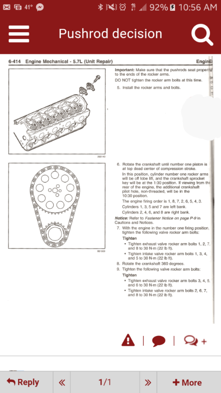

Here is some guidance I have used in the past

I did the method that was posted above me. It worked well and I found easier to do.
