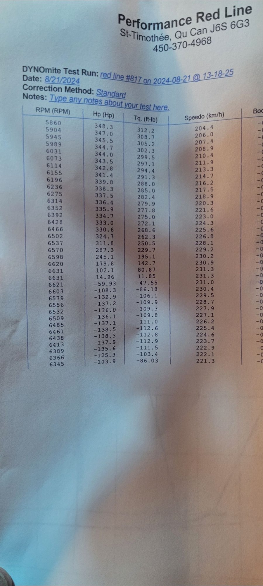

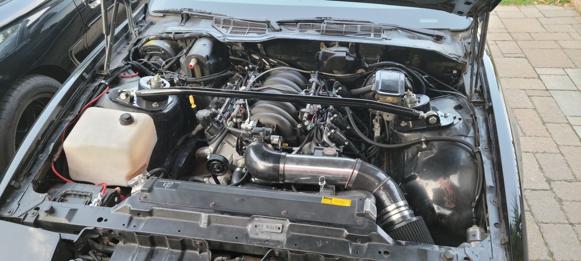

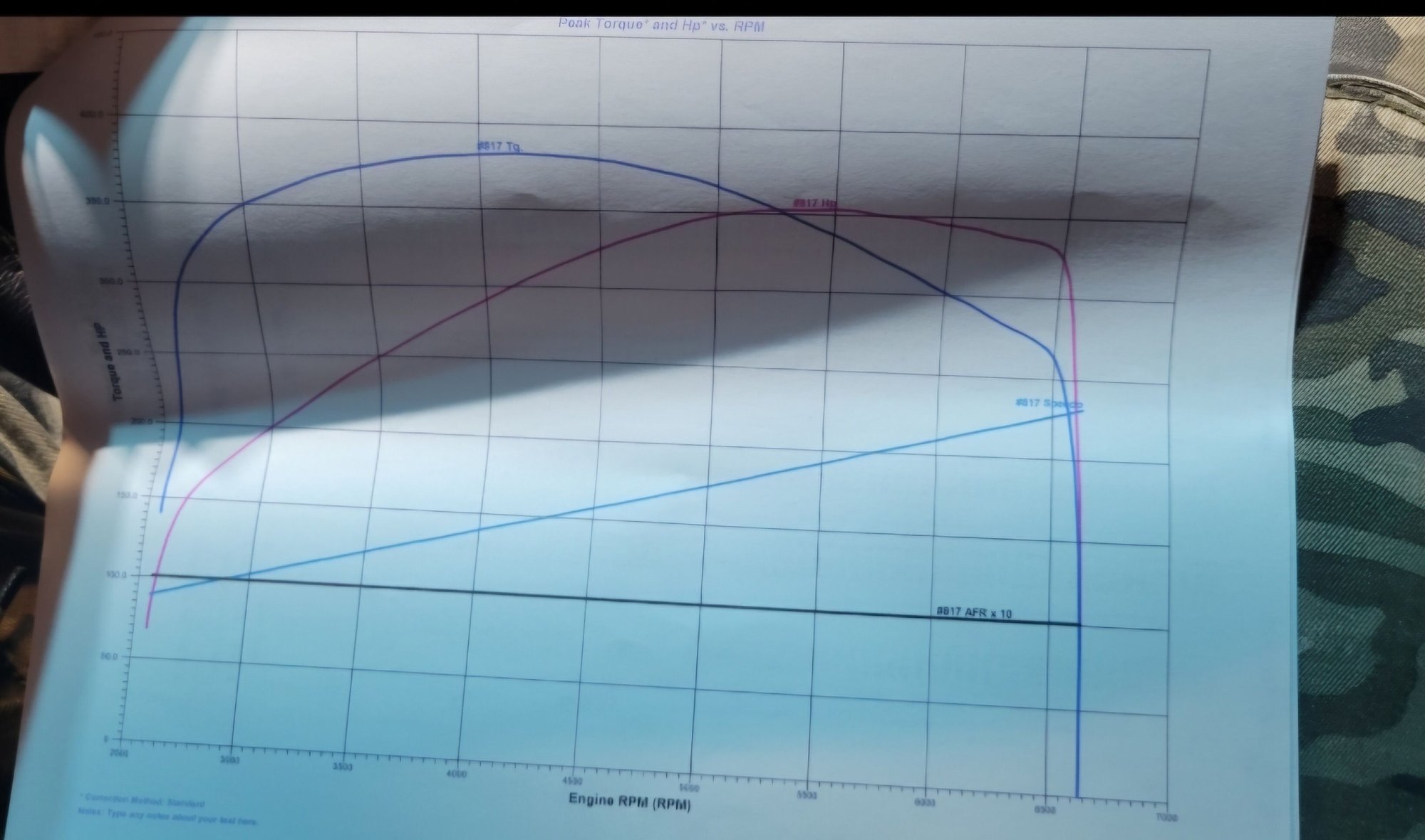

Old Dec 27, 2024 | 08:56 AM
GeorgeKlass's Avatar
Joined: Mar 2022
Posts: 10
Hey everyone, thought I'd post an update!
Ended up performing the swap from late May until mid July.
Had it tuned Aug 21st and put down 353 whp on a Land and Sea dyno.
Went back a couple of weeks later for some street pulls and setting shift points because it was raining dyno day.
When driving back to the shop the tuner asks me "You have 4.10's right?"
I tell him "No sir, 3.42s" He looks at me and goes "What!! I could have sworn you have 4.10s they thing it pulling! Wow!"
View this post on Instagram
Street manners are amazing. It runs/feels/drives like stock. Got stuck in a 2 hour traffic jam, no problemo. Drives like stock. Put around 1500 miles on it so far so good.
No victims yet but had ZERO issues keeping up with a 22-23 Mustang GT on the highway.
Fume smell from being catless not as bad as I though, but I did buy a 4" cat and will run it as a tailpipe to see if it cuts the smell. That is literally the only place we have room to place it. It also has a bit of an ugly rasp if driving a bit aggressive at around 2300 so hoping the cat will eliminate that.
Currently building a nicer cold air and got some great Ebay hi tech parts lolol
- aluminum overflow (probably paint it black)
- aluminum rad cover
- aluminum dual fan shroud (let's see what fans are supplied, maybe upgrade them)
Will be adding A/C back in there, has to be top mount just deciding who's brackets and what compressor we will use.
Also shopping for tires. The General GMAX RS worked with my pavement pounding 305, can't really hook up now haha.
Last edited by GeorgeKlass; Dec 27, 2024 at 09:13 AM. Reason: Dyno link wasn't working
