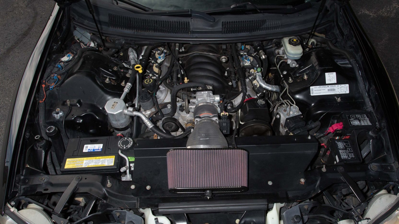

I tried searching this but couldn't find it. What size are the EGR bolts on the 806 heads from a 98 Z? I'm pretty sure they're metric.

Actually I think its part of the AIR system. The bracket bolted onto the front of the passenger side head in this picture. I'm mounting a catch can and need the correct bolts.

Yeh like I said I was fairly certain they're metric. I just don't know the size. I've pilfered through every bolt in my tool box but can't find one that fits. The hole is about an inch deep. Just don't know the thread size.

Should be M10x1.5, about 30mm long IIRC

Thanks man.
