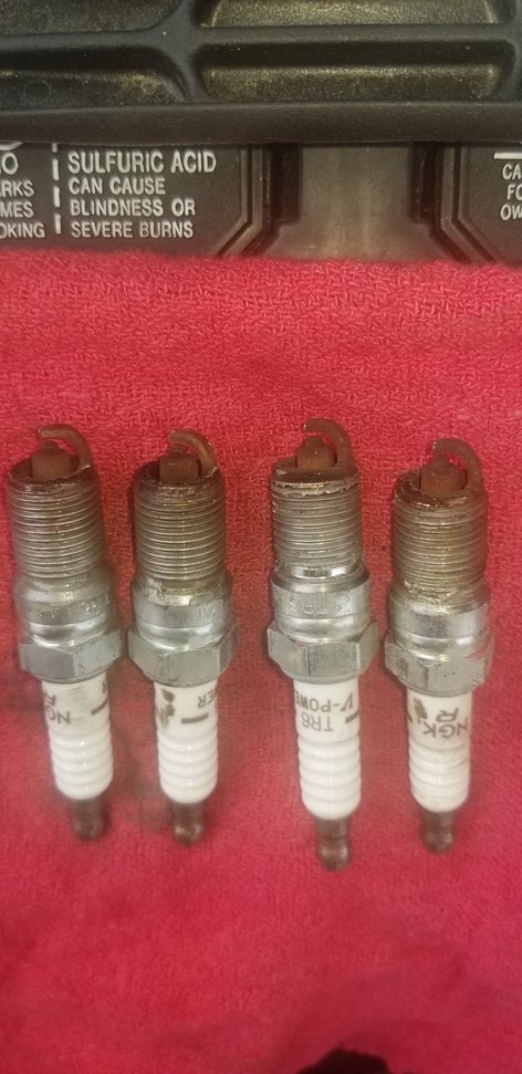

Ok guys here's an update. First pic is plugs from cylinders 1,3,5,7. I'm almost ashamed to post it. They were obviously way past needing to be changed. That's my fault. Cylinders 2,4,6,8 looked the same. Good news is there was no sign of oil on any of them. So no oil in the cylinders.

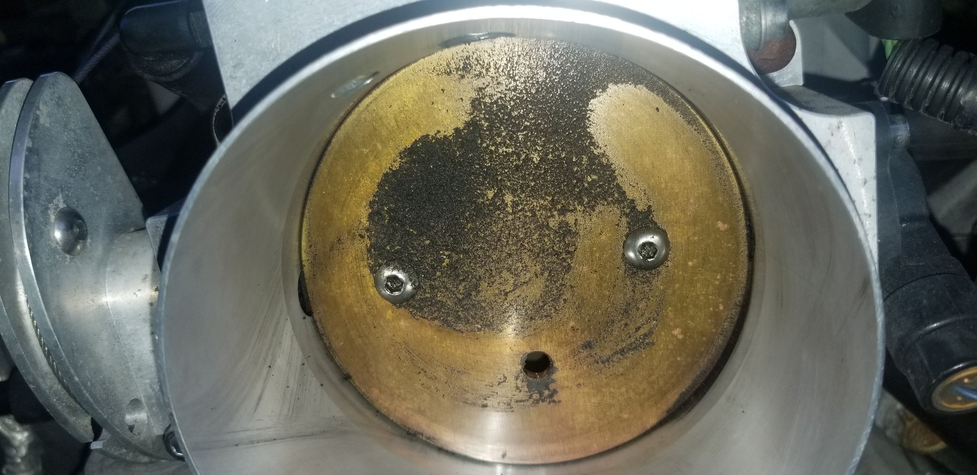

The next pics are the throttle blade and inside the intake. The blade appeared to have oil on it. Its black. But could be dirt to I guess also. I pulled the lid off right after I parked the car from driving it. There was smoke in the intake. Not sure if you can tell from the pic but it is wet and oily looking inside the intake. I'm thinking a catch can is definitely in order.

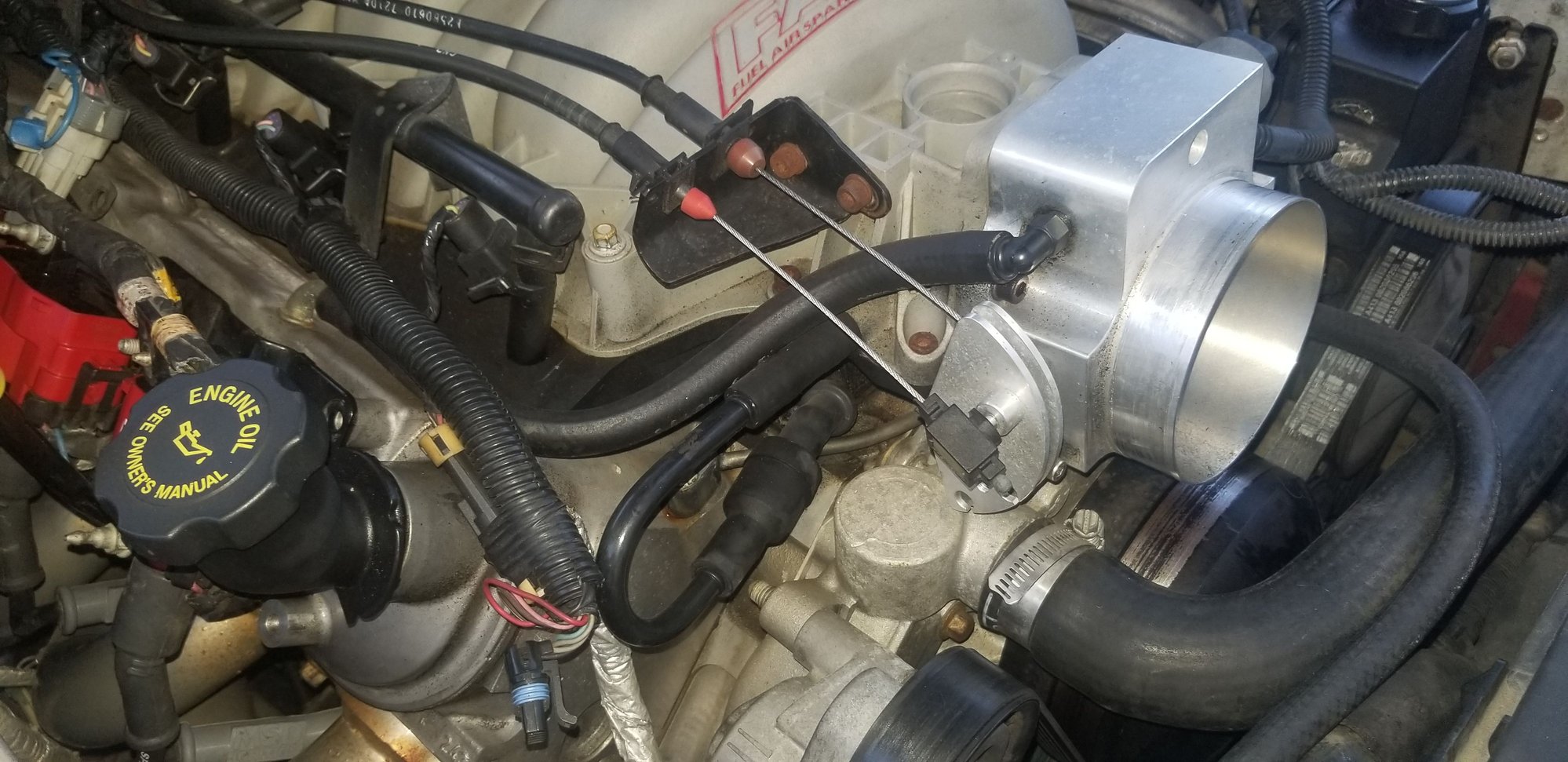

Last couple of pics are the pcv set up. As you can see the driver side valve cover just has a nipple plugging it off. The passenger side has the hose from valve cover to tb. Then the hose from intake to the valley cover.
I'm thinking a catch can is what I need. What do you guys think/recommend? TIA.

Looks completely normal, I honestly think your engine is fine and like previously mentioned is just burning off condensation inside the engine.
The smoke from the exhaust during the shift looked like fuel (rich) not oil.

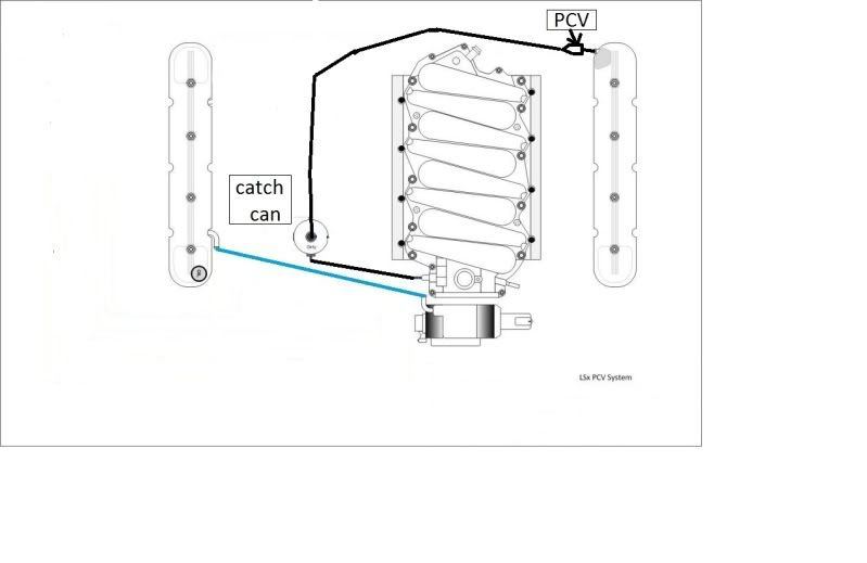

This is how I have mine routed but the PCV valve is in the stock location. If you have the LS6 valley cover it'll be a little different.

If your going to stay with PCV then be sure to purchase a sealed catch can and not a breather can otherwise you will be adding un-metered air into the intake manifold and that will cause an issue. MMS has a breather can setup with a check ball and built in PCV that would suit your needs but if you don't want the sight or smell of the smoke/moisture under your hood then run a sealed catch can and send it through the intake manifold. I'm sure the manifold, engine valves and catalyst will stay clean for many years to come. In a factory LS1 setup the PCV valve is in the line just before entering the intake manifold and from your picture you have an LS2 or LS6 valley cover which has a built in PCV so no inline valve would be needed and the sealed catch can would connect between there. BTW..There's no such thing as clean air and dirty air, it's blow-by and it's the same stuff being circulated. That is all..

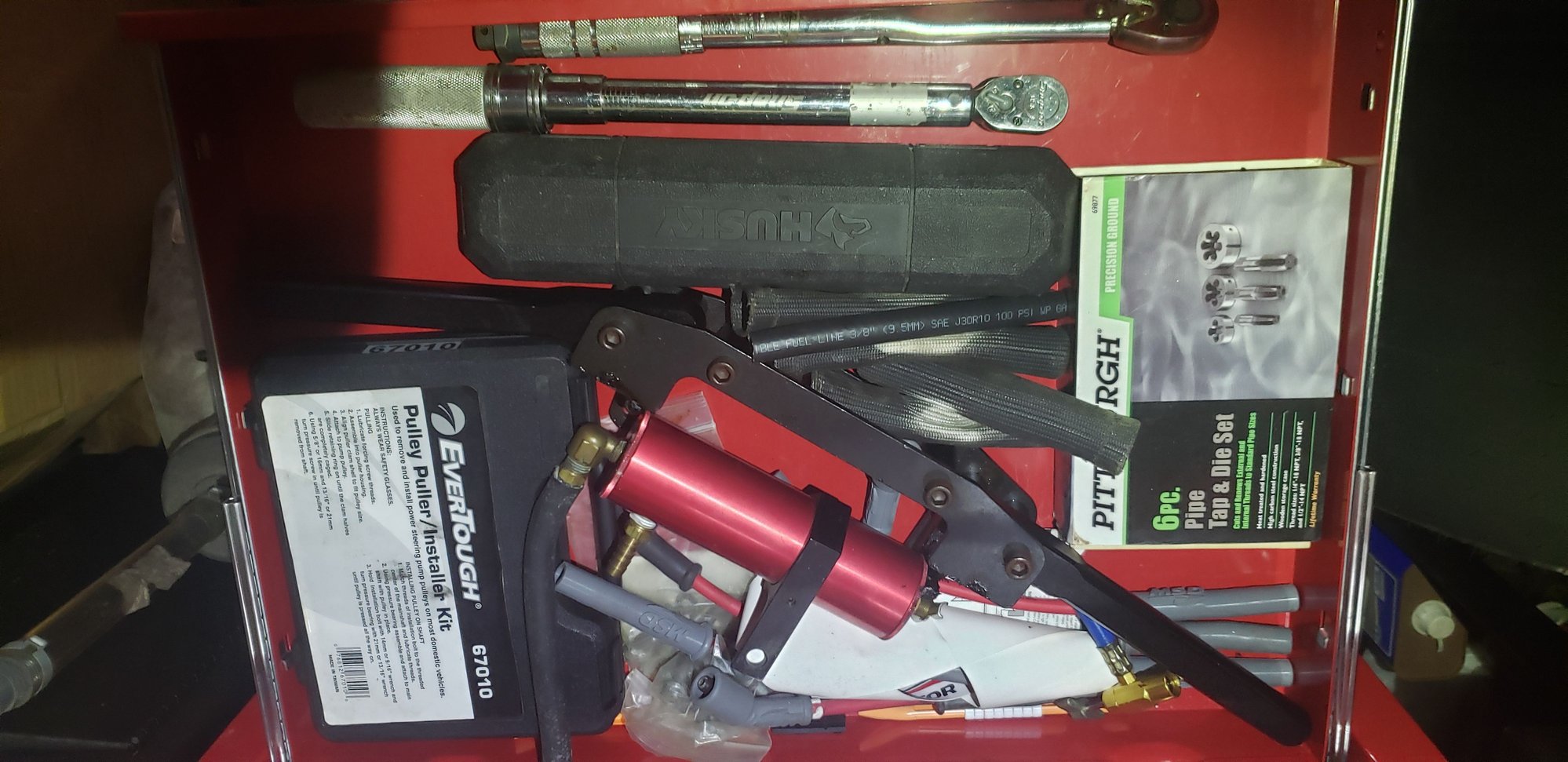

Old Apr 15, 2022 | 11:38 AM
01CamaroSSTx's Avatar
Joined: Feb 2015
Posts: 5,986
Likes: 2,280
From: Conroe, Texas
I have no use for it so $40 plus ppl fees and shipping and it's yours.
