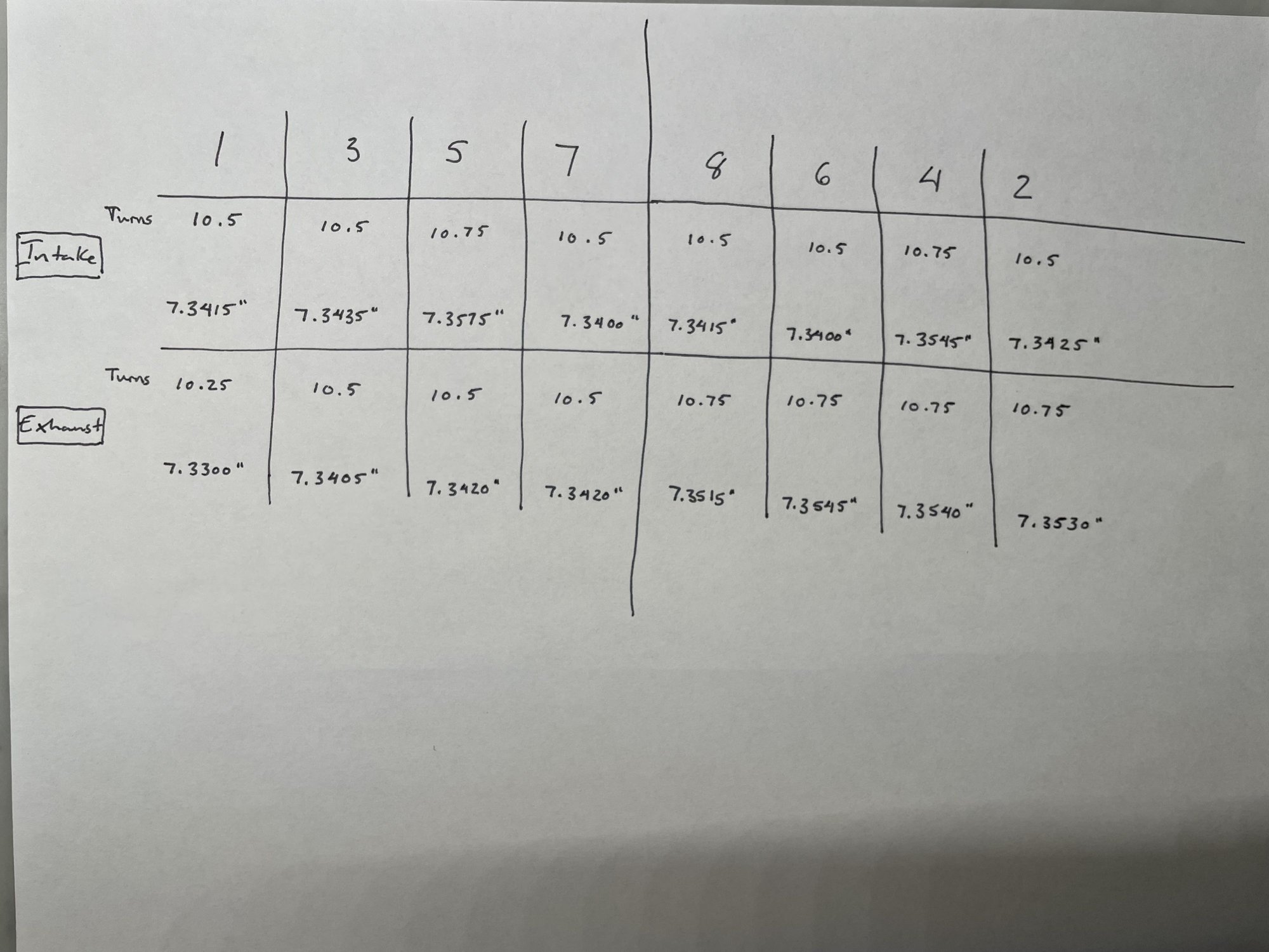

I bought a comp cam pushrod length checker to perform the measurements. I watched several videos on how to "finger tighten and count the socket / ratchet turns by hand" but this seemed subjective and I kept getting different turn counts.
I ended up using the method in this video
I had already purchased some Tick 7.400" / .080 hardened rods which came with the cam kit (with the understanding I may need different ones).
Turns: this is the number of turns on the 6.8" comp cam tool (1 turn = 0.05")
Measurement: I pulled the tool out of the engine and measured the length with calipers
This measurement table
6.8" + (tool turns x 0.05")
So my question is what length pushrod should I run? Now I have not added anything lifter related in these measurements.
Also I'm not sure if this is the correct way to measure with calipers, but is there a reason why the 7.400" pushrods measure longer?
Stock pushrod for comparison
Thanks!

I've been searching the forums and to keep it simple, will use the pushrod tool turn method to calculate the pushrod needed.
So based on this table:
Now the pushrods I have currently are Tick 7.400"
This would give me somewhere between 0.0625" - 0.0875" preload on the stock LS6 lifters. Does this sound appropriate? I don't know what the plunger travel is on the stock LS6 lifters.

I recently went through this on my build as well. I measured mine to where there was no lash on the rocker with the comp cams pushrod tool, then I added my lifter preload to that number and I to am running 7.4 pushrods on my build. The reason the 7.4’s run longer is because of the ball end at each end of the pushrod is not measured from the manufacture because the ball end sits inside the rocker and in the plunger of the lifters. I’m guessing we’ve watched most of the same videos and your measuring on the base circle of the camshaft. Not always the case but if you don’t change the base circle size the pushrods will almost be the same as OE. (Head gasket thickness, milled heads, and different lifters can effect this though)

Thanks that makes sense now. Since the car is down right now for the supercharge install, waiting on parts, etc...I was able to did double check all of the measurements on the base circle. As far as I know, Tick did not change the base circle size on this cam, so I think the 7.4s will be good with the preload range I calculated. There def is no lash when I checked.

I've found that It's not so much the camshaft that will cause the different lengths in PR's between the intake and exhaust but more so the valves. Most of the time you can lay a straight edge accross the valves on the cylinder heads and all of them will be even but not always the case.
