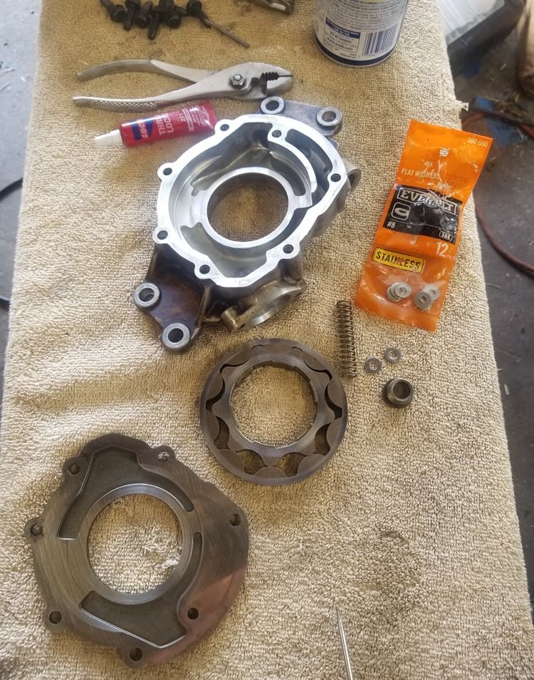

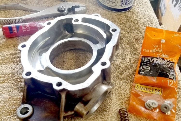

I installed a Melling M295 on my '01 Camaro and recently on my brother's '05 Vette; he cruises his C6 and I run my 4th Gen hard. You can go with one of the other models, but the stock replacement oil pump will do the job.
You can also mod the stock oil pump for more volume; here are a couple pics. I have a bench to work on parts, but sometimes my lifting bench becomes my second parts modification bench lol.
