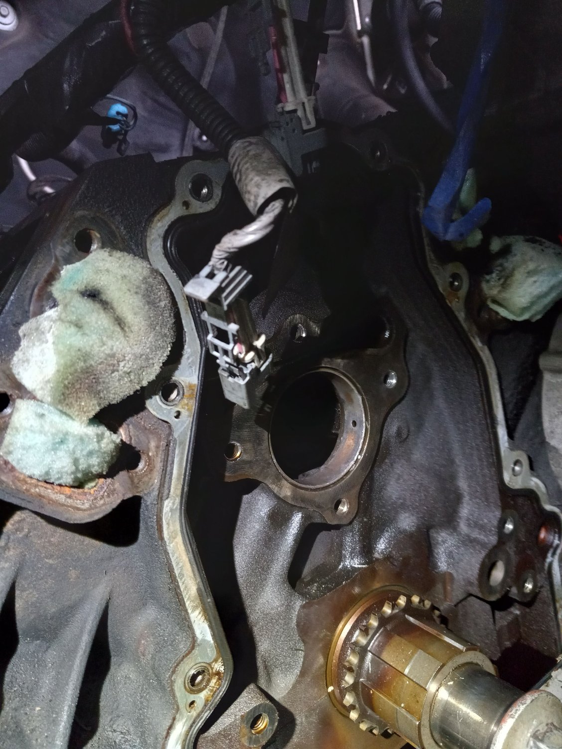

Guys,This 4.8 chewed up a lifter, cylinder 8. Cam lobe ground the roller in half. I've been tearing it down for a Melling replacement. The cam is not coming out.
I'm stumped. It came out easily to this point, now It won't go any more. It's loose, I can go back, not out...
YouTube un-certified newbeee.. What am I missing? Lifters are out, nothing in the way as I can tell.

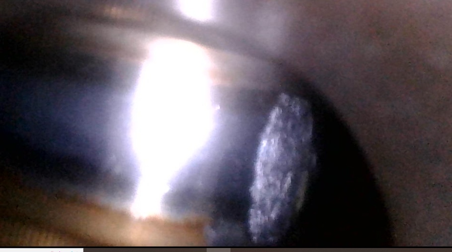

Yes. I've been trying for hours to get the journals to center and go through the next bearings. I just took a look with an endoscope camera from the lifter bores and from below. Nothing seems to be blocking.
Theres the damaged lobe. Journals are all clean looking,

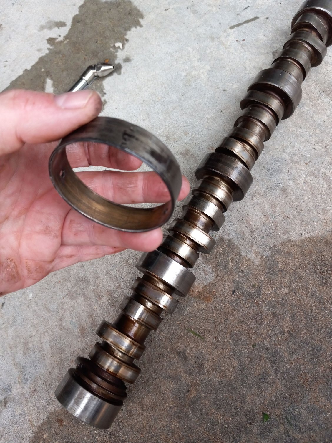

Theres a loose bearing free on the shaft. Probably the third from the front. It's rough and wont slip over the bearing of the camshaft. Must have been off for while running, Probably what caused the whole failure.. Can't get it from the top. Any thoughts on how to get it out/off?

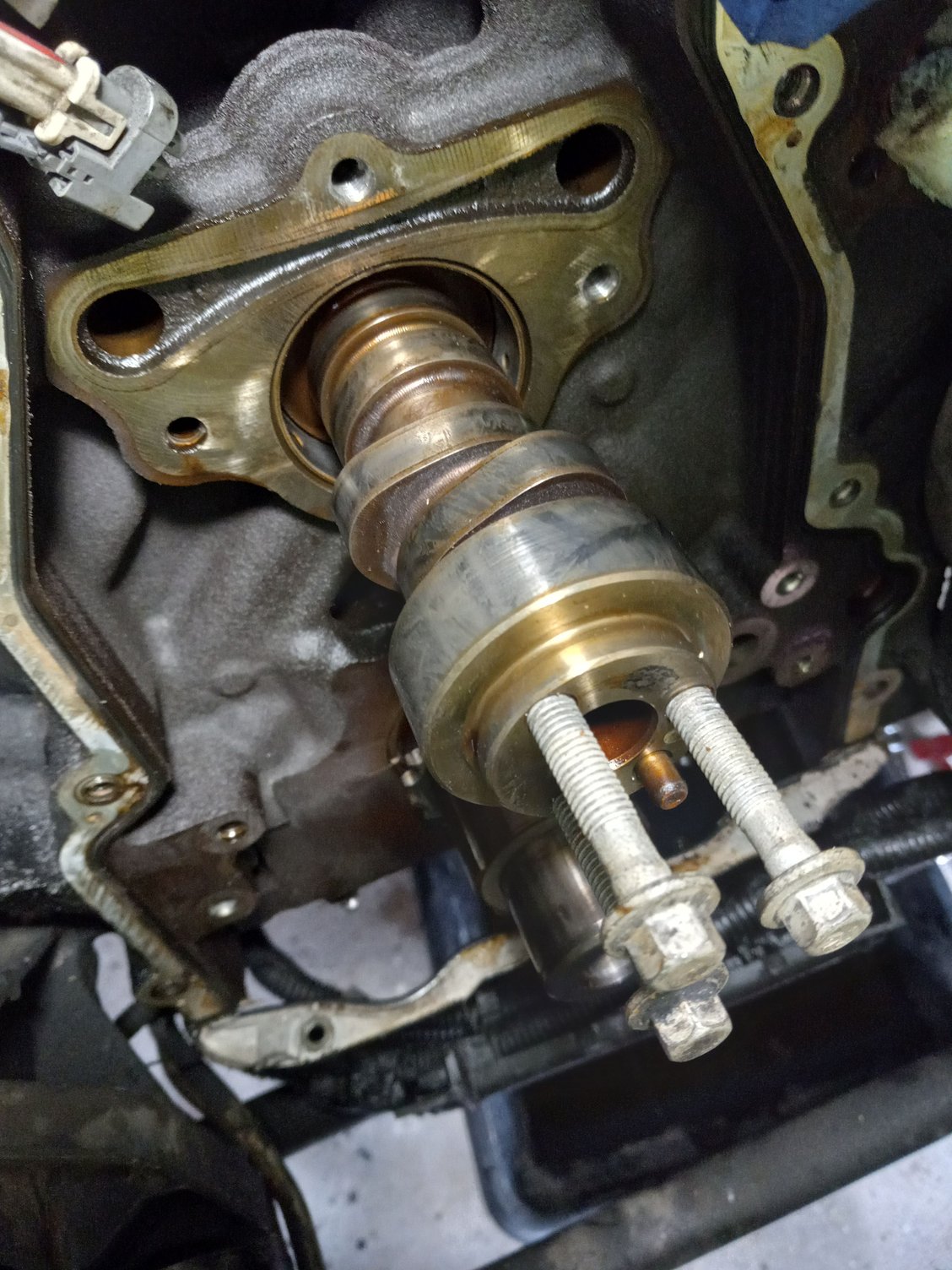

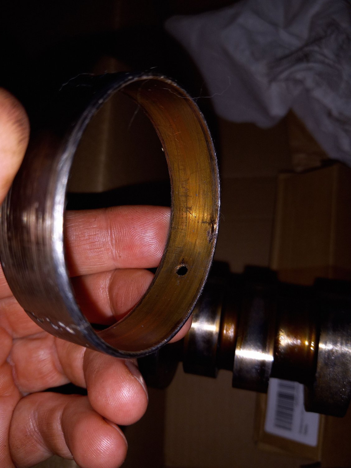

I really appreciate your insight and advice. I went in from the bottom and was able to position the bearing on the journal. It was just snug and it did come out with a push from inside and a pull. One man job. The last journal was nothing. slid right out through the loose bearing as it was centered on #2 bearing.
The cam has one lobe ground down badly, three lobes with severe wear, no journal damage at all.

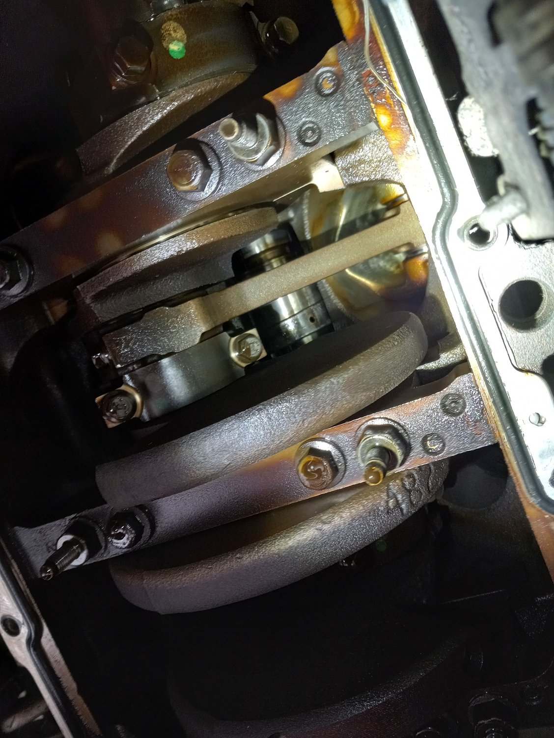

The free spun? bearing is nasty looking. Bearings one and two are tight in place and look rough but I don't know if that's normal? Maybe metal in the oil has caused this damage?
I'm wondering about the crank bearings now.

Cut open the oil filter. That'll tell you the condition of the mains. Stripper Glitter = toast
