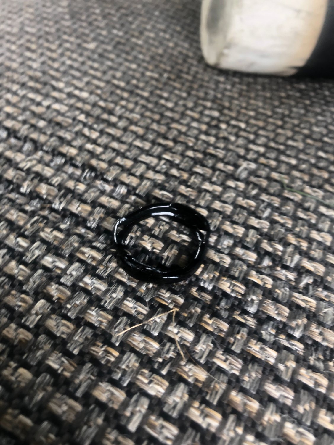

I THINK I have figured it out. Changing the oil pan and therefore the pickup tube, the o-ring came out torn. It did not come out hard removing the tube and I do not remember it being hard to put in when I assembled the motor. The motor I guess was so new the oil pressure was just high enough to not cause alarm, but since switching the pan setup with a new oring, pressure increased A LOT. Have not had the tick yet, but tomorrow ill be taking the same up-hill route on my way home and ill know then.
