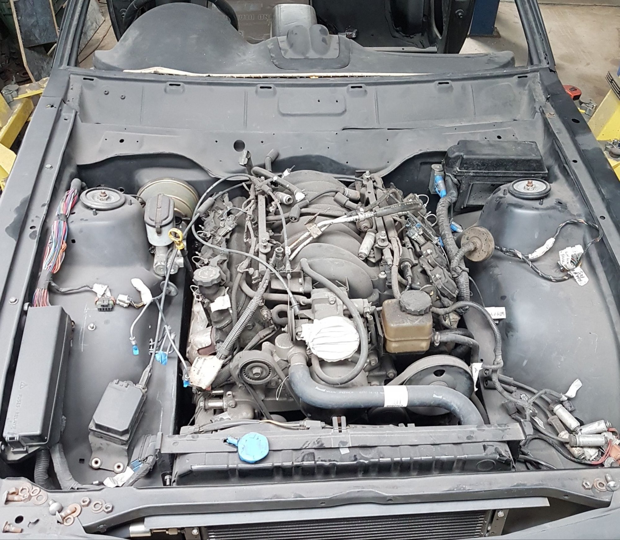

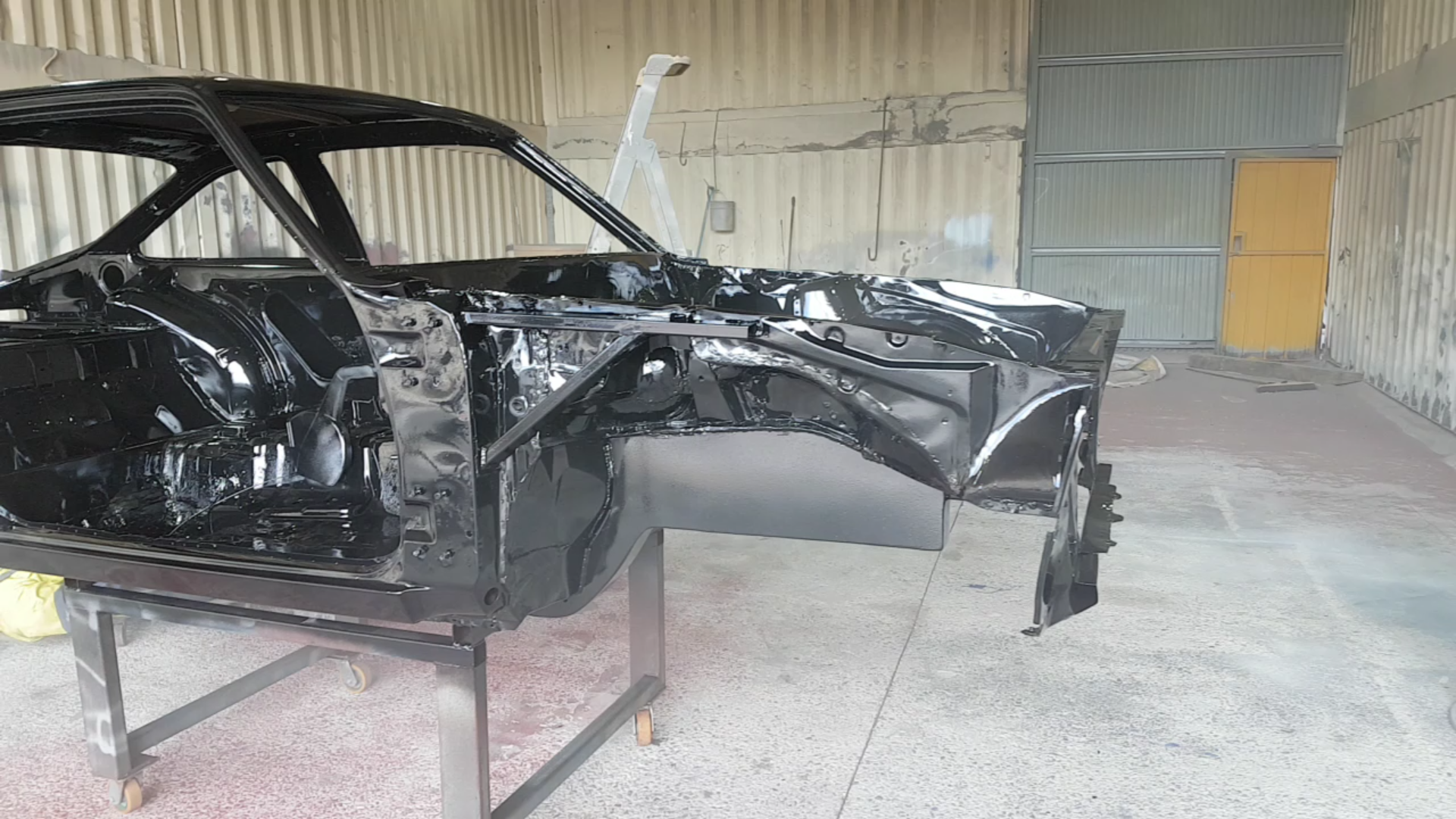

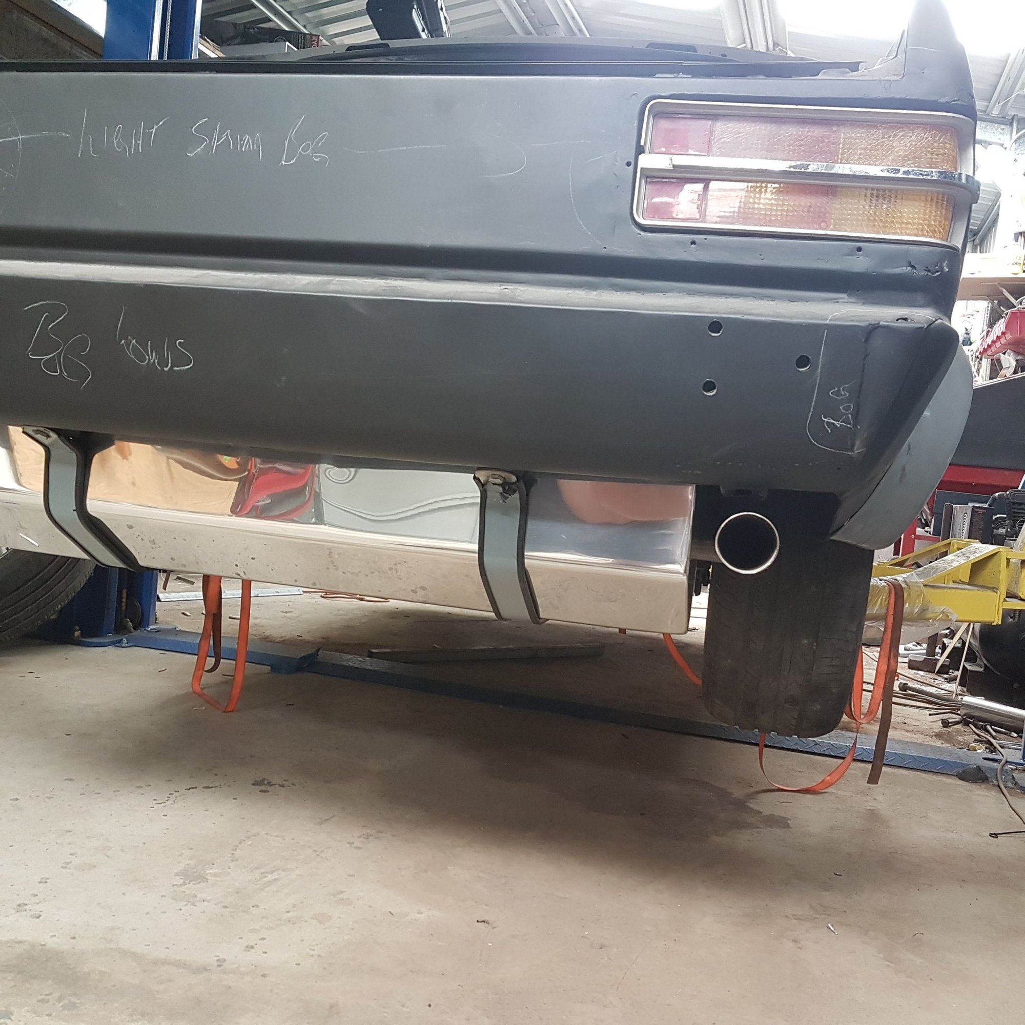

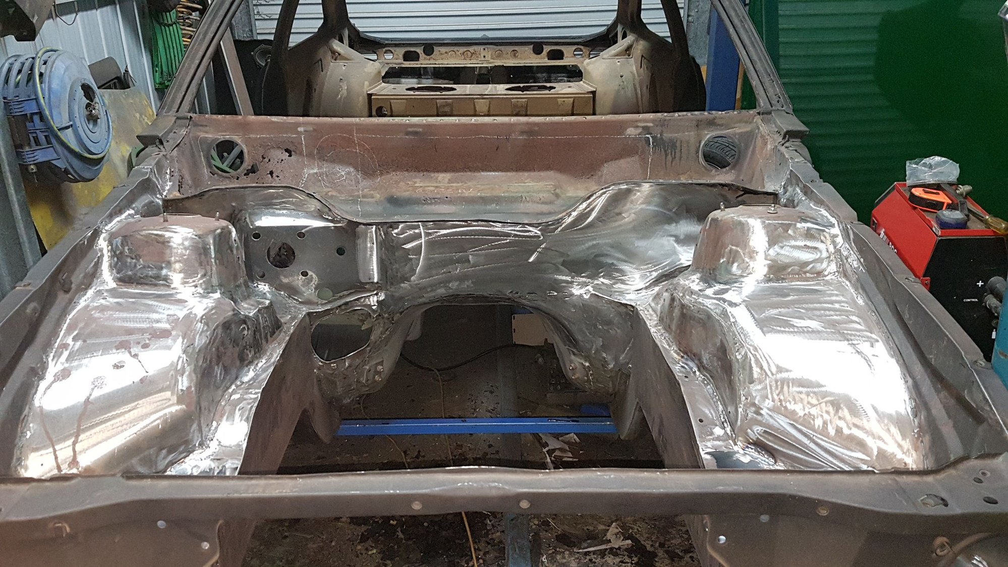

Front seats console and dash have been test fitted now. Time to fit aircon unit and electrics.Car has been fully sand blasted and painted in KBS Rust seal to prevent any unwanted rust ever again.McPherson strut towers grafted into the torana engine bay along with custom chassis rail adapters to except the different K frame.AWD driveline fitted. Ls1 4l65e gearbox transfer cas front diff k frame and all suspension in the car.32''17/8 equal length 4 into 1 custom headers i made to suit the car.225 55 17 tyre on a 8''rim so plenty of room for big wide rubber. Custom120L alloy fuel tank​​​​​​​

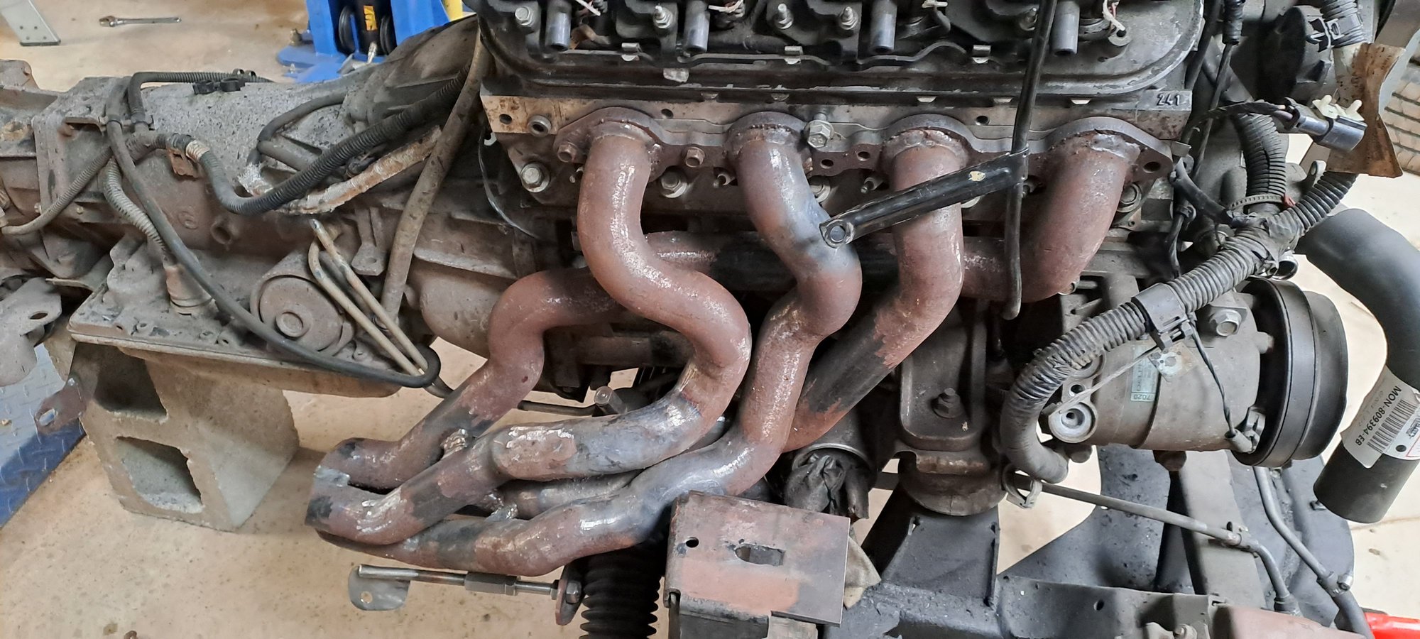

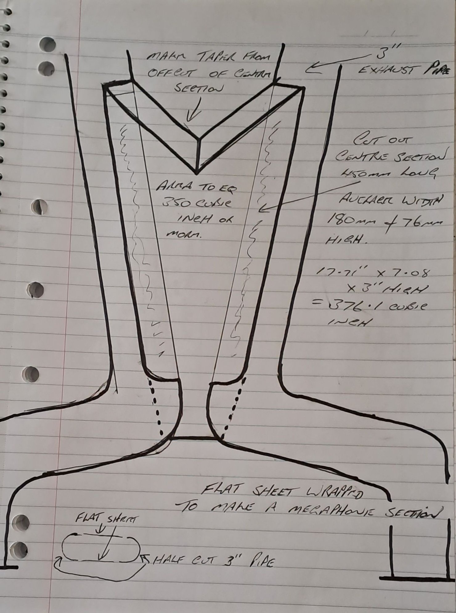

Well I've been doing research and development for my exhaust system.
watched David vizard you tube video and like his open header street legal sound exhaust setup.
So I'm using his idea but have changed it slightly as he says to use a reverse cone shape that is normal used in 2 stroke exhaust system.
I don't have the room for that shape so have gone with a cone in the opposite direction. This should create the same effect and also force the exhaust gasses to expand faster and accelerate volisity creating suction behind the exhaust gass pulse.
hopefully this will help scavenging on cam overlap and exhaust stroke.
It's not finished yet just starting tavk it together.
Twin 3 inch system with 100 cel cats and race style mufflers that flow over 700cfm each. More than enough fore my hp target.
the hand drawing will explain how it shout work.
GM used this design in a Corvette and it worked perfectly from what David Vizard says.

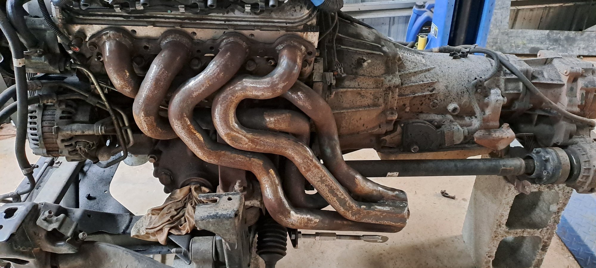

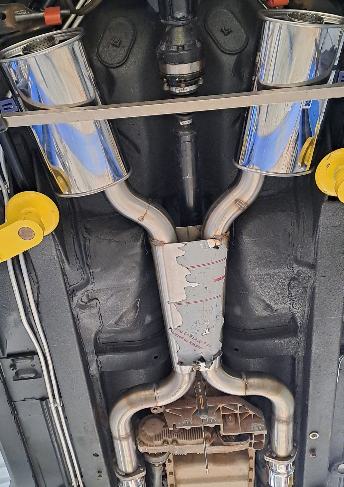

Where I'm upto with it.
