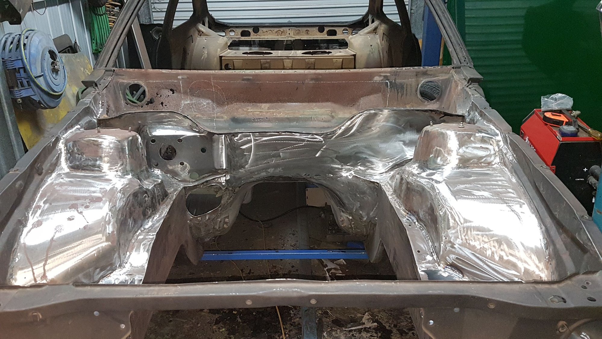

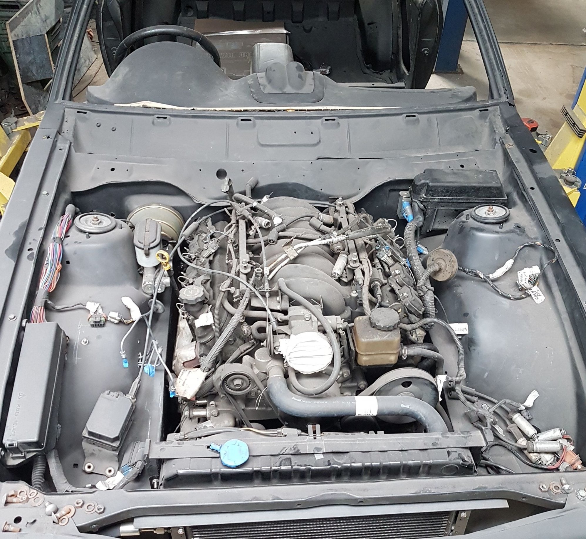

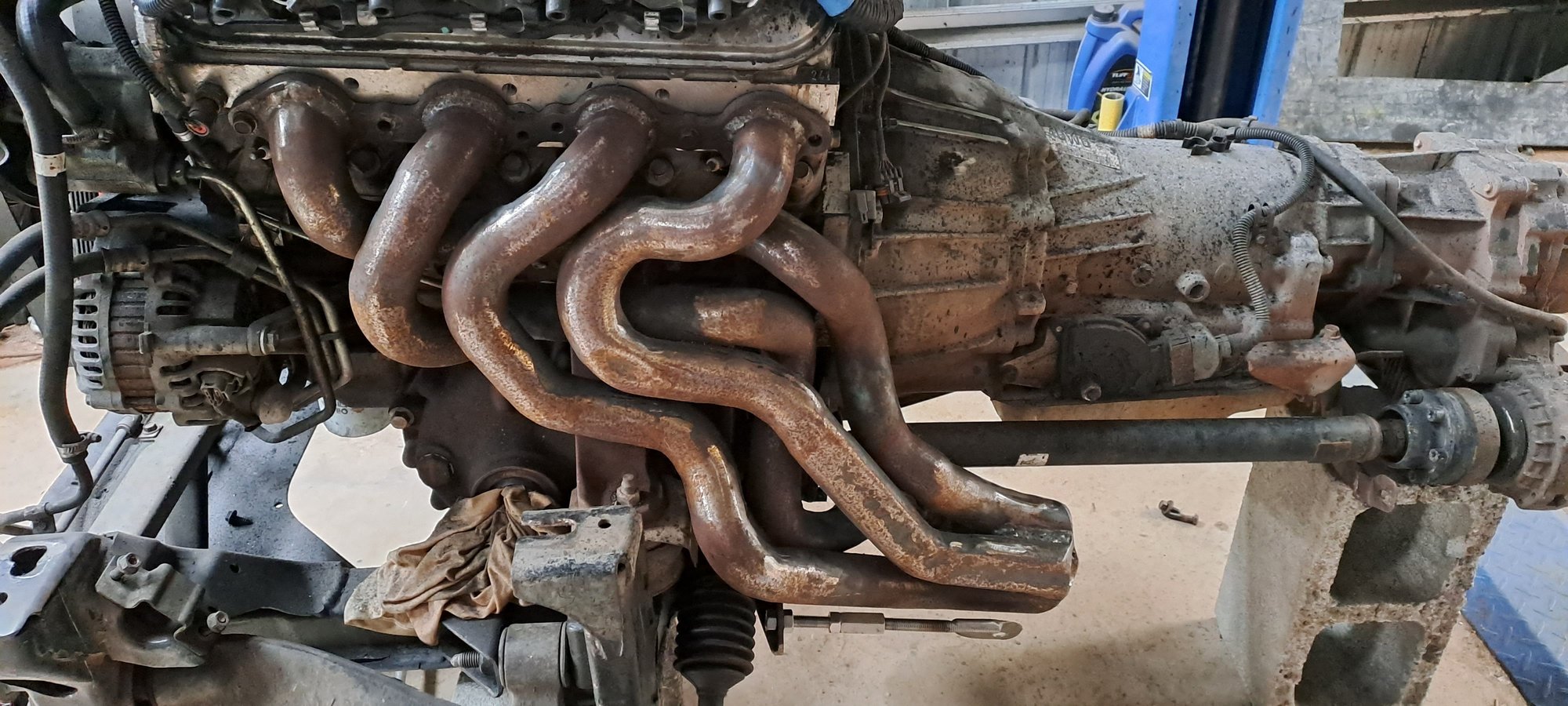

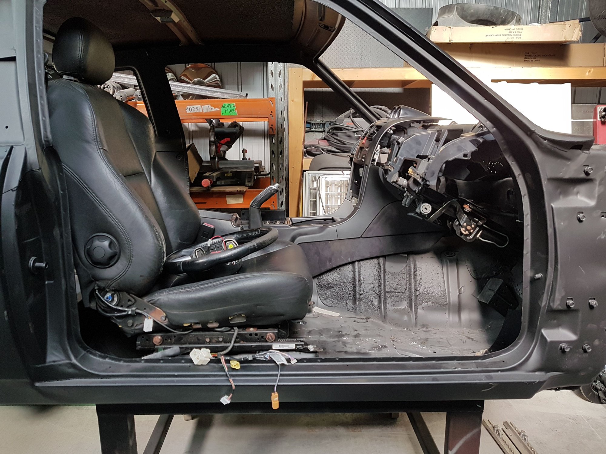

Here's some photos of the conversion also the metal work and my custom made 4 into 1 headers ive made. Over 100 hours in and not much left to do before i disassemble it for paint.
