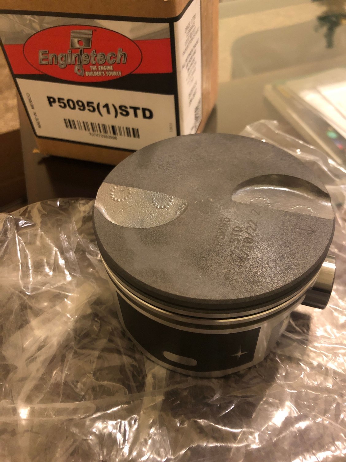

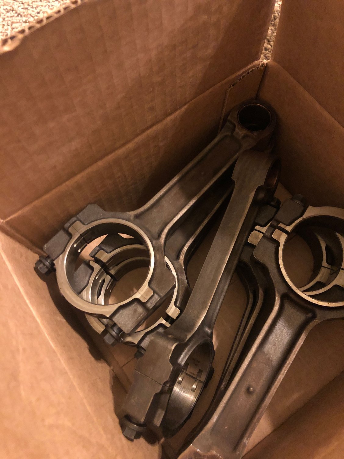

So i got myself some used gen 4 rods with brand new gen 4 pistons, ik these rods can hold there own but what about the piston at 900-1000 on a single turbo on 16lbs of boost?
putting these into my stock block & crank 5.3 ls engine & dropping it into my 4th gen firebird

Motor lasting with forced induction is always more about the tune than the stock rod strength at the level you mentioned.

Stock hypereutectic pistons, and stock rods, will take a lot of power. 99blackbird is right about tune. Though stock pistons and rods will take a lot of power, what the pistons won't take is detonation. If you have a great tune, stock pistons will live fine at the higher power levels obtained with FI. The only problem is there's no forgiveness in a marginal tune. No "insurance" that forged pistons offer. Get a really good tune, run premium fuel, and it's amazing how much power the stock bottom end and pistons will hold.......

I made 800 whp with an 80e on a turbo gen 3 5.3 pump gas and 20% meth mix. timing conservative pulling some additional peak toque. loose converter 4000 stall.
3000+ pound s10 street driven. the rods bent at 850 whp. still ran but the rods were all slightly bent. I made hundreds of passes at 800hp no problem gen 4 rods be even better1000 +

Since it’s boost and nobody mentioned it (that I seen) make sure your ring gap is set properly.
