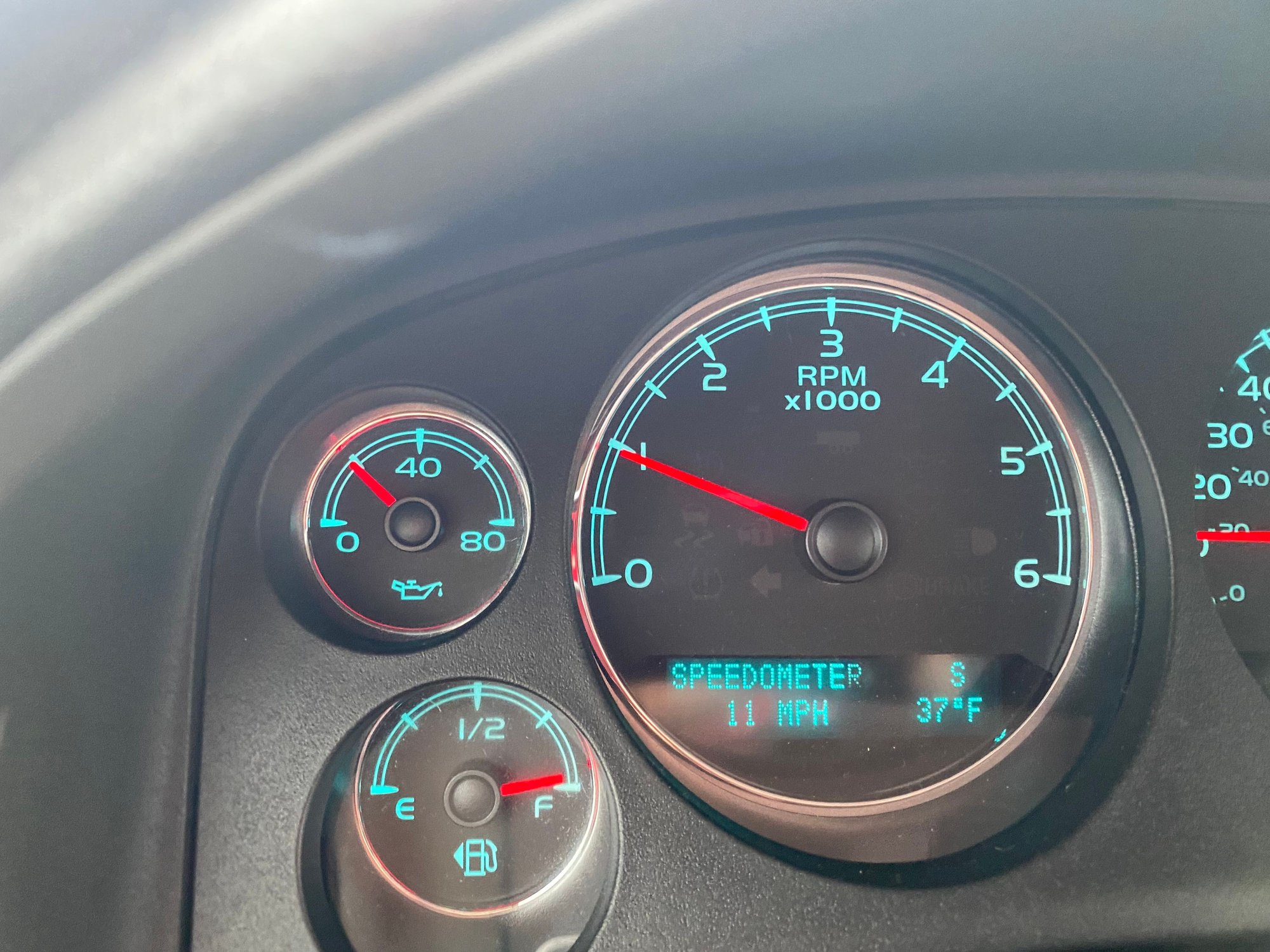

My 13 Tahoe 5.3 sits about 21-22 psi at operating temperature when cruising when I coast it will drop to about 19 is this normal or should I be pulling the pan now and checking the pickup o ring has 114k miles.

That's normal

My 2013 Lade used to be at 24psi at cruising speed and would go down to 20-22 at idle and up to 35psi at WOT
My dealer said this was normal but I had them install a new oil pressure sensor screen as well as a new oil valley cover when they replaced all my lifters. This only raised my OP to 28 psi at cruising.
Seems these engines just have lower OP than what were used to in our Fbodies.

I think the GM safe spec is something like 7-8 psi @hot idle

The rule of thumb is 10 psi for every 1000 rpm

Glad I posted this its bothered me forever but I always forget about it 5 minutes after Im done driving it. Kept the picture on so Id remember
