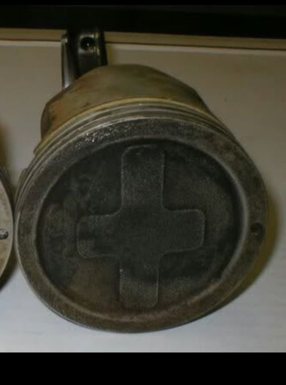

This is an example of the style i have
That's an LQ4 piston. Are you sure that is what you have?
Old Apr 7, 2023 | 07:42 PM
Posts: 22,308
Likes: 3,625
OOPS! Looks like he has a 6.0, not a 5.3.
Described in Summit specs as "dished, 6.7cc" No mention of the cross...
I am 100 percent that my pistons are like that. I just put the heads back on maybe less then 2 weeks ago and i seen that my pistons looked like this and i did some research on them trying to figure out what pistons they were. Something told me to take a picture of them but they definitely do look like that. What made me notice is because they were supposed to be flat top and when I removed the heads and changed the lifters I noticed the cross
