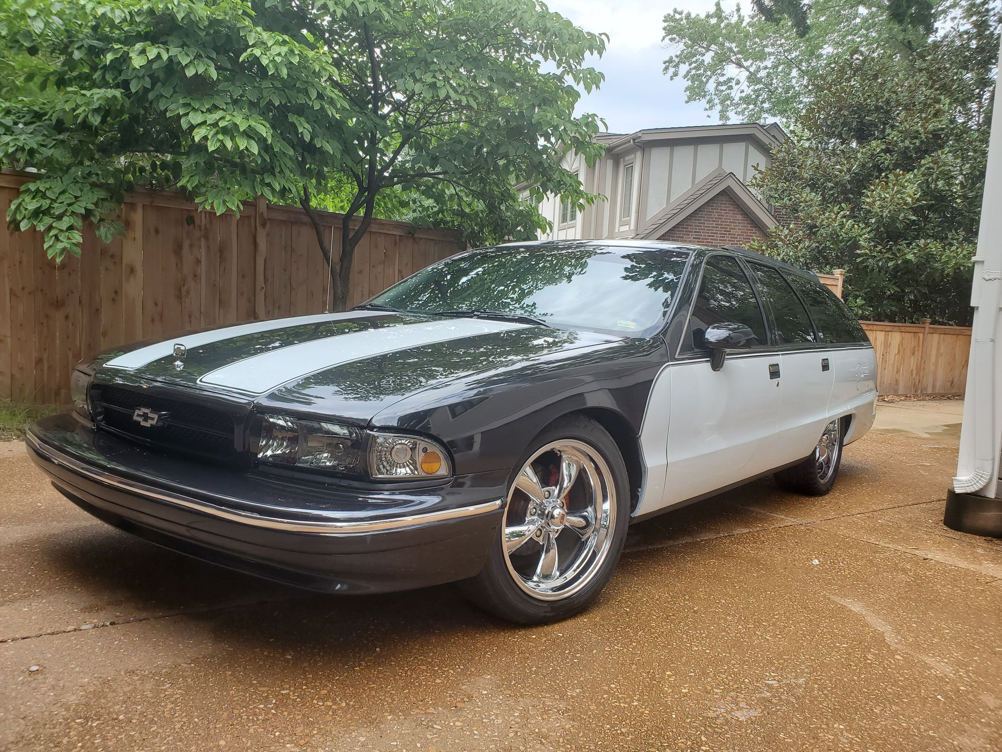

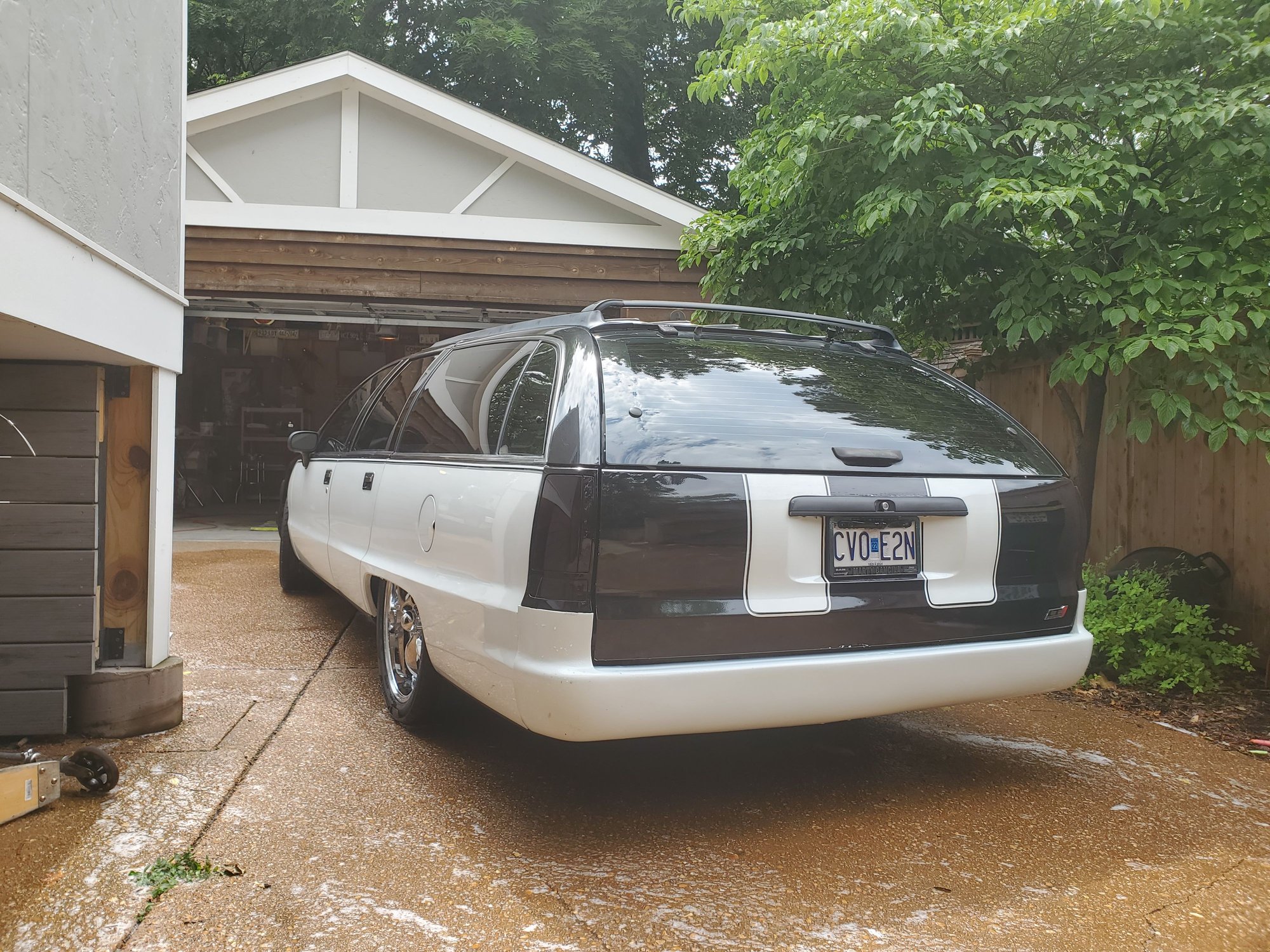

Default LQ4 mild cam build 94 caprice
I'm a journeyman collision tech and not super familiar with engine internals.
I'm building an LQ4 to put in my B Body 94 Caprice Wagon.
I'm looking for mild performance, but mostly reliable performance without having a temperamental crybaby for a vehicle.
I'm leaning towards the Sloppy Stage 2 cam.
Do I need the whole setup with everything, springs, pushrods and all? Or just the cam?..
I'm keeping the stock heads, but using an LS1 intake manifold with larger injectors. For clearance issues.
Also I'm planning a 2600 stall converter and rebuilding the 4l60e.
Ive already got posi rear end....
Trying to keep everything cheap and easy.
I'm not racing this thing....
