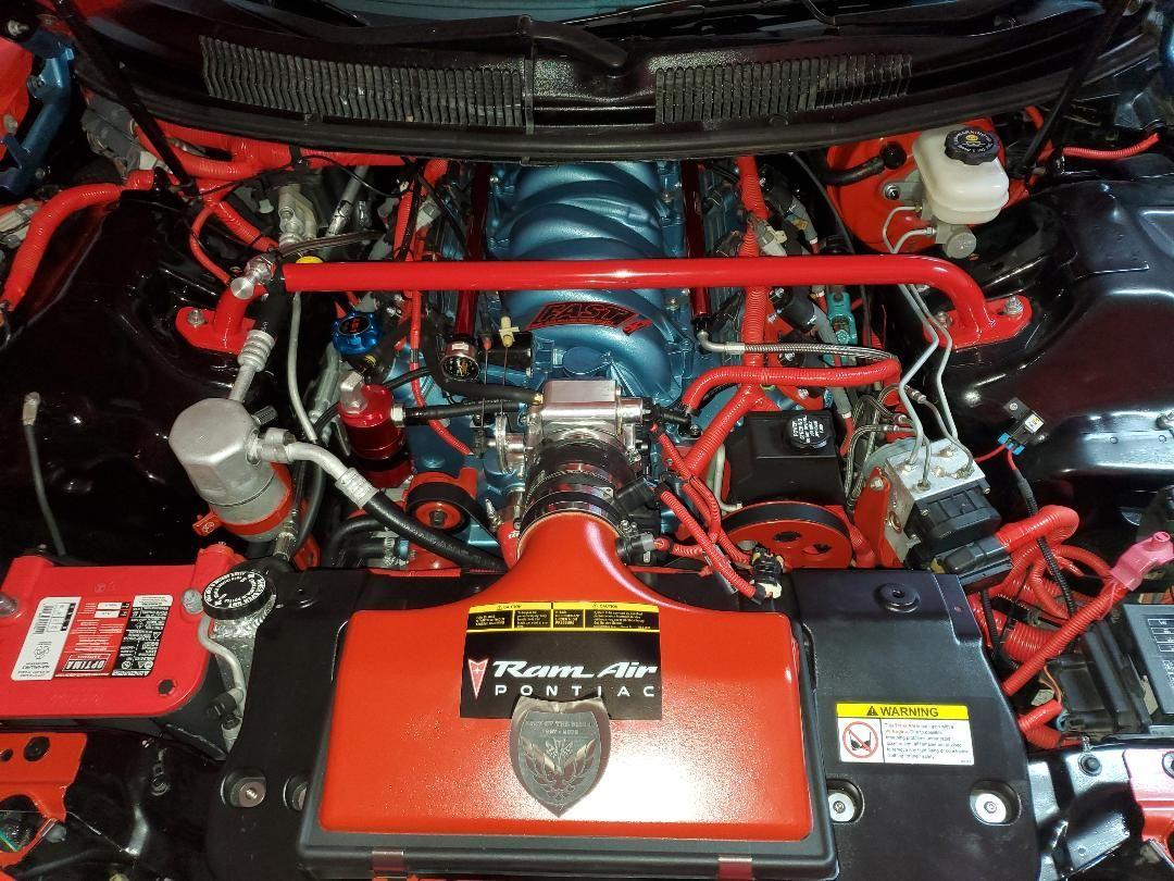

I have looked all through the threads and found nothing that can relate to my issue. I have recently completed a new build for my 2002 TA with original LS1 motor. Here are some details.Original long block built at Texas Speed. Wiseco Forged Pistons all new strong internals etc. I got the long block, but the rest of the build I did myself.
Gen Info.
LSA 111 cam 231/234
Compression 10.33:1
Heads PRC 2.5 5.3l CNC Ported
Bosch 42 LB Injectors with plug and play adapters
Fast 92MM Intake
Fast Fuel Rails
Nick Williams 92MM Throttle body
85MM MAF
Standard AC coil packs
Fuel Pump Racetronix FPA-001C 255 LPH Turbine Pump
2-7/8 headers with 3" Texas Speed true dual exhaust
3600 RPM Stall with RPM Transmission Level V
Fully Tuned by Pat G tuning in Victoria
Ok, here is the issue. Car runs great. Have had it on the road now 8 months and now issues. EXCEPT 1. First noticed when needing gas. I would take the gas cap off and notice a rush of air. Like a vacuum was released. Then after gasing up, hard as hell to start. Like it was out of gas/not getting gas for about 8-10 seconds, then catches and starts, but runs rough for about 20-30 seconds. Then all is fine. As well, I live in Houston, and during the cooler months, no issues while driving. drive all over town, stop and go and nothing. Now that it is hot, I drive around for 30 minutes and the car starts acting like it is starving for gas. Let the car sit for about 10 minutes, runs fine again for about 20 minutes ( again I am driving in the heat ) and it starts acting up again. It almost like a vapor lock in the old carb days, I sure there is something in the fuel supply, but I am looking for suggestions on where to start looking to fix this.
I am hoping to get the community help on this one.
Thanks
James

Start with verifying good fuel pressure and I take it you've replaced the fuel filter. Hard to see from the picture but is your EVAP connected or capped off? You could also have a defective gas cap but my EVAP is still entact and I've never noticed any pressure build up in the tank when I open the gas cap.
