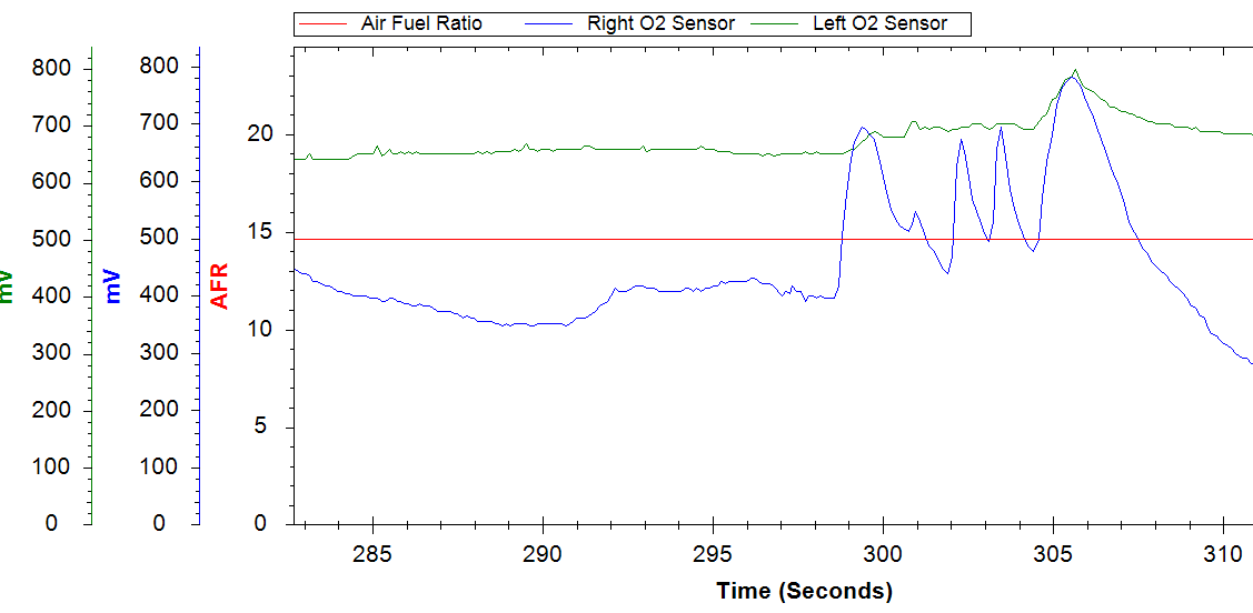

I tracked both O2 sensors as well as the AFR (Air Fuel Ratio). I've included a snippet of the graph below.
The AFR remains constant at 15% which seems unusual ? I would expect it to be changing quite rapidly in response to the changes in the O2 sensors.
Both O2 sensors start out at around 400 mV and track each other for the first 45 secs. At that point the right O2 sensor (blue trace) starts falling to around 400mV. If I rev the engine I can see the right sensor respond by increasing in voltage by about 200mV but the left sensor only increases by around 20~30mV. I would expect both sensors to track each other fairly closely however the right sensor wants to settle at around 300mV and the left sensor at 650mV. The right sensor is responsive to changes in rpms but the left sensor seems very lazy and doesn't respond much to rpm changes.
The leaky fuel injector was on the left side so I suspect that possibly unburnt fuel has contaminated the left O2 sensor.
The graph below was taken at t= 285 secs to t = 310 secs. The engine should have been well and truely in closed loop by this time.
Graph of O2 sensors and AFR
Comments appreciated.

I'm thinking the reason for the smoke was due to residual and rough idle could be contributed to fuel delivery. Do you have a fuel pressure gauge installed to monitor PSI when running?
Old Aug 1, 2023 | 08:06 AM
carmodyg's Avatar
Joined: Dec 2020
Posts: 88
Likes: 16
Yes I was thinking initially the smoke was due to some residual fuel in the exhaust but there is a lot of it and it doesn't seem to be abating (although last time I started it there wasn't any smoke?). I have a fuel pressure gauge installed and it is steady at just under 60 psi (I think for an LS1 it should be 58 psi) so close enough.
Its just that the waveforms for the two O2 sensors are so different. I expected they would closely match.
Greg

Time to start with a "clean slate" with a pr of new sensors.

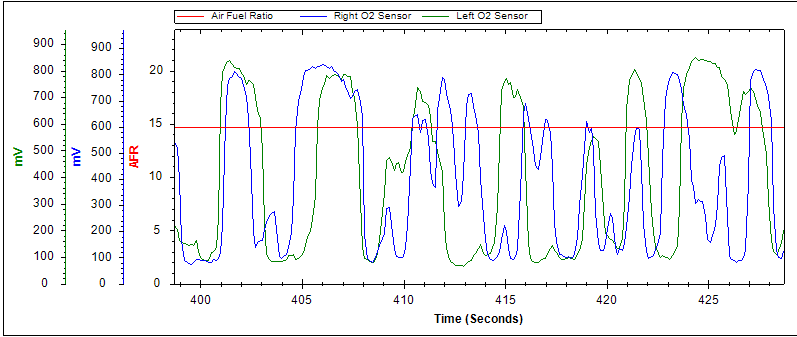

I've just installed the new O2 sensors. This seems to have fixed the problem! No more rough idling and hesitation on acceleration. The waveforms of the new sensors appear to be switching the way I expected them to:
