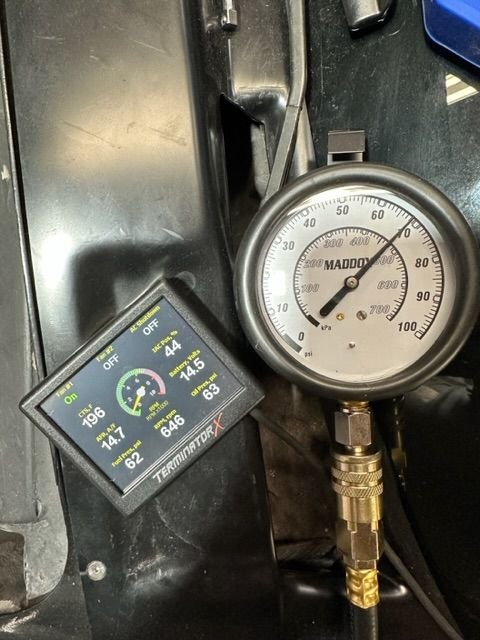

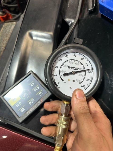

Update, put it all back together and oil pressure is highhhhhh haha. Kind of expected with the HV pump but it has 75psi cold and warmed up to about 60psi. Alittle worried about overall pressure now though… 111psi I saw before the gauges maxed out oof at around 2500rpms. Thoughts on this high of pressure? I didn’t even really rev it that high so I have no idea what the overall pressure would be but i can’t say I’m comfortable with this High of pressure.

yea, but given the low pressure I figured it could have been loose bearing tolerances as the car has never really Been warmed up long enough to get the oil good and hot and when I did I had zero pressure. What are the cons of 100+ psi on the street? Besides blowing up a filter or pushing past a gasket? I could run a 20wt oil to help with the pressure and I left the spring that it came with which is the medium pressure. Lower pressure spring should knock off 10psi.

engine is back together and didn’t pull a cap, 111psi of oil pressure with M355HV pump at 2500rpms with 5w30 conventional.

Ive read from a few places that High oil pressure isn’t bad unless you cavitate, aerate or suck the pan dry (plus not blow up the filter). Some stock LS7 engine run at 100+ psi oil pressure.
what I don’t understand is how I’m getting so much pressure as the relief valve should Open. I’m running the standard spring too and not even the high pressure. Oil temps also aren’t up, this is just idling in my garage for 15-20min. I suspect oil pressure will drop a good bit once it gets warm. I can also always swap to a lower pressure spring and drop oil weight to 5w20 or even 0w20. I actually run 0w40 in my other car that has a turbo 5.3 with the LS6 “GM hv pump”.
anyways here is one thread I pulled from.
“the Simple answer is...as long as you dont collapse/blow up the oil filter, and as long as you dont cavitate the oil, or suck the pan dry.... you can never have too much
the low side all depends on the use....
of course you already know the 10psi per 1000 rpm rule...
but some engines dont even need that much...
I know some diesels spec out at 2psi minimum at idle.....because that is all it takes to float the crank and prevent bearing damage because of how well they are built and how much tighter their machining tolerances have to be to support the power they make.
on my setup... at idle I have 75-80 psi cold, and 60-65 psi hot.
at WOT, I have 130-135 psi Hot (I dont know about cold because I dont go WOT until all Fluids are warmed up
I know some promod guys, and they all have 70-90 at idle and 130-150+psi at WOT(some have more than that)
again.. they key is that you dont suck the pan dry, and you dont cavitate the oil or froth it up...
other than the oil filter, there is nothing you can hurt from high oil pressure
so just be sure to use a Wix or K&N filter that have been tested to over 300 psi with no issues.
if you have turbos or an oil fed supercharger, you may need to restrict the feed line to keep too much oil from going into it and overflowing it.
get a high flowing oil pump like the Schumanns Race pumps, and you will see a rise in pressure because of the rise in flow(you can only flow so much fluid thru the passageways, so pressure goes up because flow cannot increase without a pressure increase if the oil passage stays the same size)“

Idling for 15-20 minutes there and the oil is hot. It will get a bit warmer at rpm under load, but it was already at 180 after 15 minutes. Too much pressure/volume in the crankcase and you’ve got windage issues. Windage both in the crankcase and under the valve covers. Windage causes power loss and oil frothing. Frothing is foam and along with cavitation, puts air bubbles in the oil. Problem with air in the oil is that air is compressible and doesn’t show up on the oil pressure gauge. As Grinder said above, you’ve went from one oil problem, to an extreme other oil problem. 100 lbs cold and dropping to 50-60 at temp is acceptable, but if it’s staying at 100 when hot, you’ll have problems. If your running the factory PCV setup, you’ll be sucking a ton of this mess into the intake, causing more problems.
The Pro-mod guys are running dry sumps. A dry sump setup can allow an engine to survive with extreme pressures because the vacuum pulled on the engine from the dry sump removes the “atmosphere” from inside the engine. All splash oil from the bearings and associated windage is pulled out the bottom very quickly with a dry sump setup, so there isn’t time for cavitation or frothing. I’ve never seen an Oem ls7 with 100 lbs of pressure personally. I have the Melling 10296 pump in my 434, with middle of the road bearing clearances. I have 75 lbs at cold start and I will jump to 100 if I touch the throttle. It goes down to 40 at hot idle and 50-52 at cruise.
