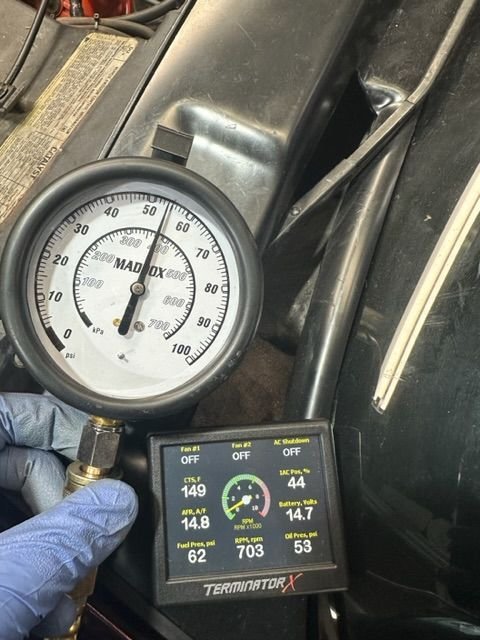

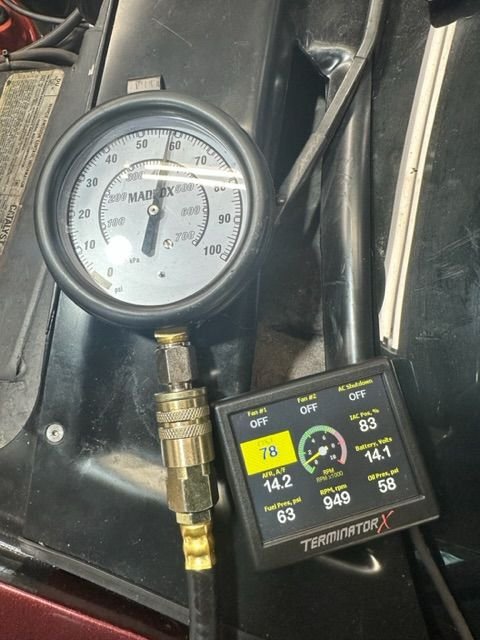

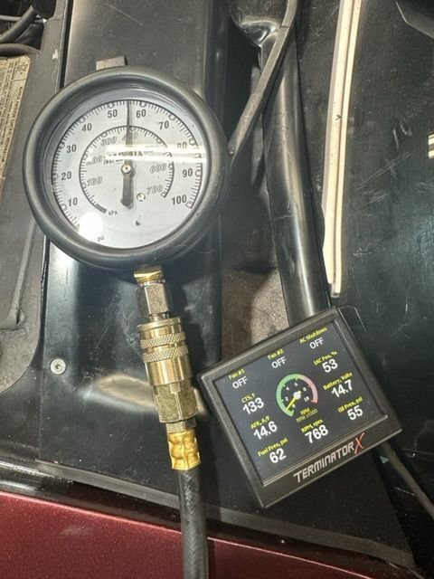

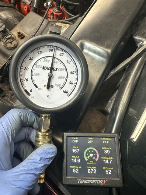

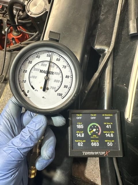

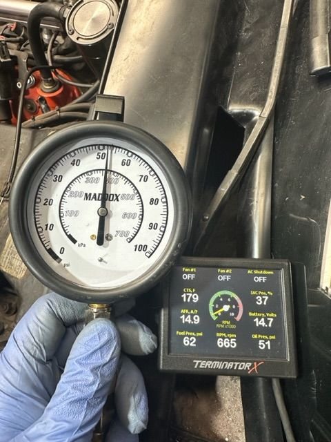

Got the melling M295HV installed and decided to not use the pickup girdle this go around. Reused the conventional 5w30 to verify oil pressure. Oil and inside of pan looked fine oil is slightly dirty but nothing crazy and no real anything in the pan.
pressures seem ok, kinda high but will see what it’s like on the road with hot oil. I believe I saw 90psi on a free rev 4k+ and it shoots to 70psi as soon as I touch the throttle. I will post a video and link.
Cold start 58psi
Operating temp coolant wise 50-53psi
Edit: video of oil pressure free rev and quiet accessories! Looks like 80psi at 3500rpms
