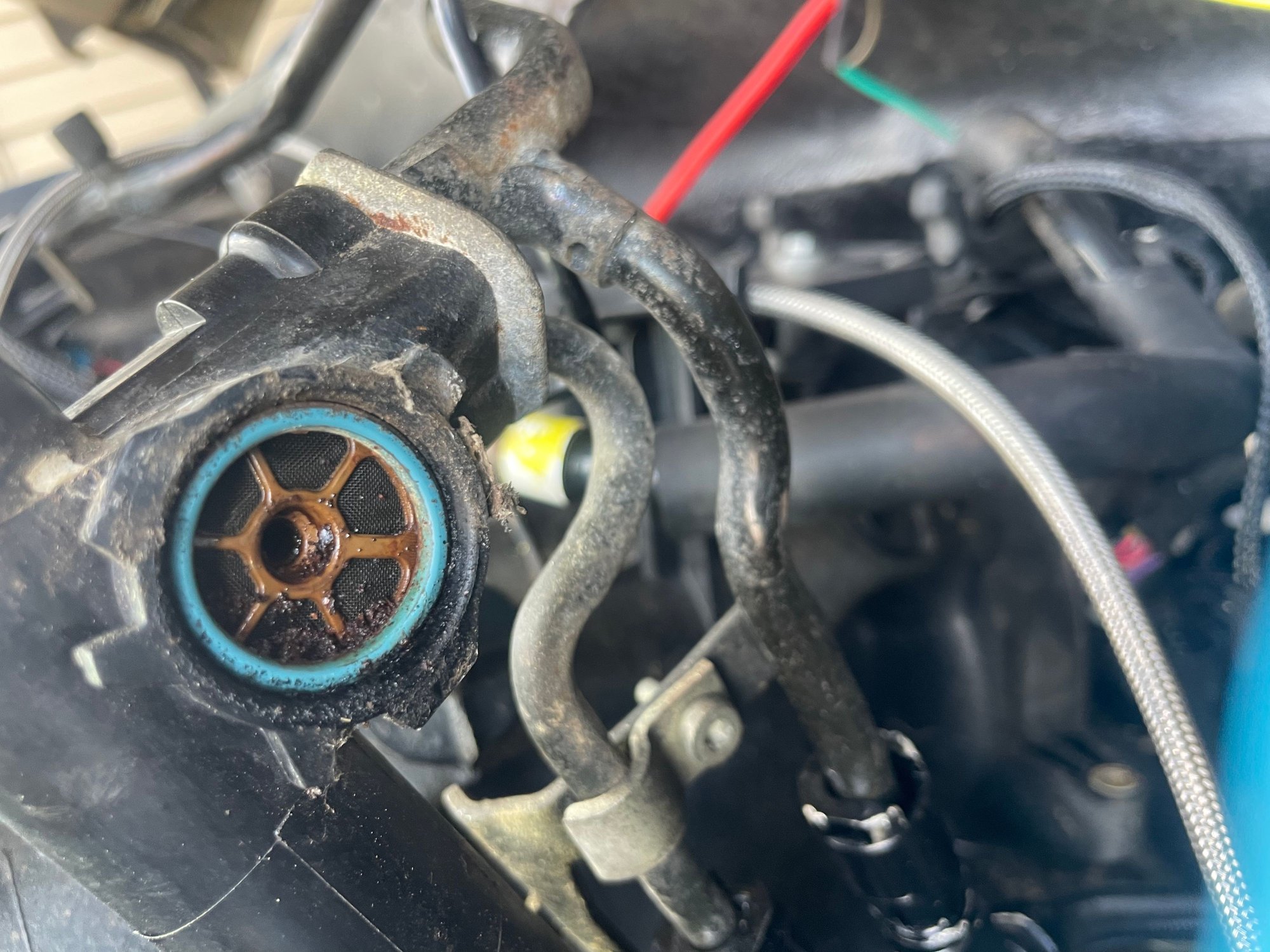

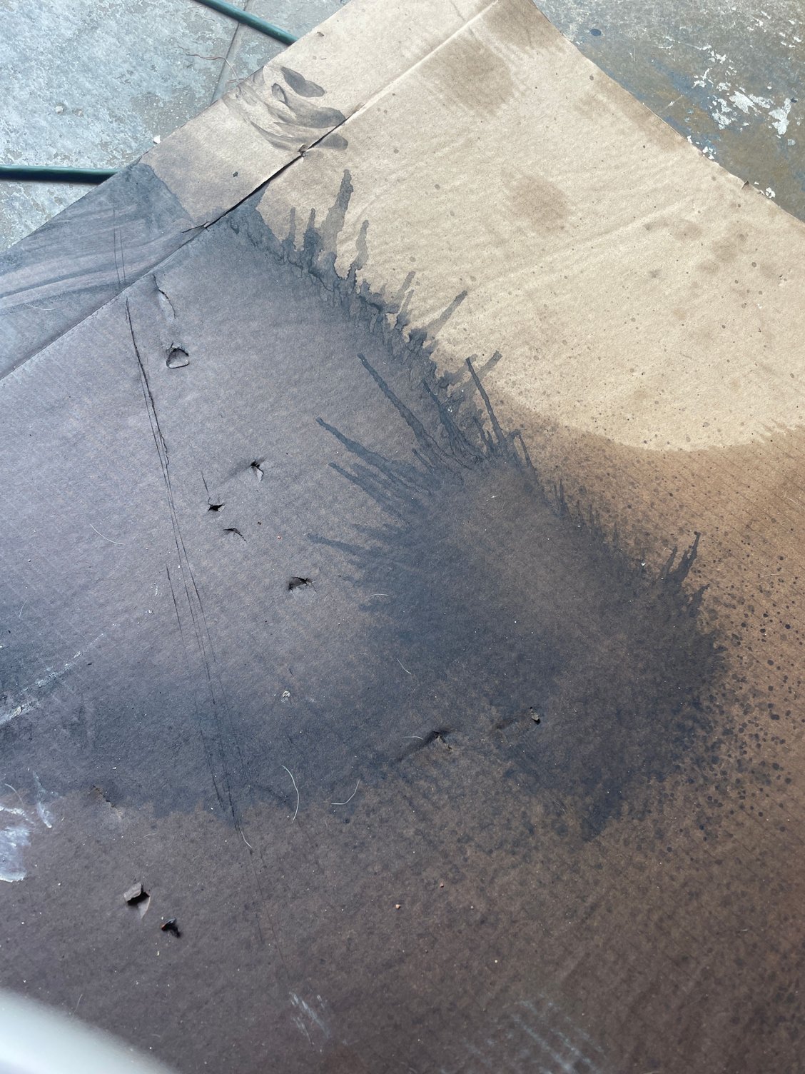

Have an 2002 ls1 swapped into a squarebody. Just finished swap and on startup and acceleration motor blows an oil and blue smoke from drivers side tailpipe. Running 3” duals on headers. Any ideas? Valve stem seals or rings? Motor sat for over 3 years. Thanks any advice is appre
Cardboard after 10 mins of running and revving engine
ciated

I would check valve seals first, as it is easiest.

. Would it be a lot of oil or say just some small amount on the head? I’ve got the vc off and do see a small
amount puddled around every spring. Gonna do a compression check also

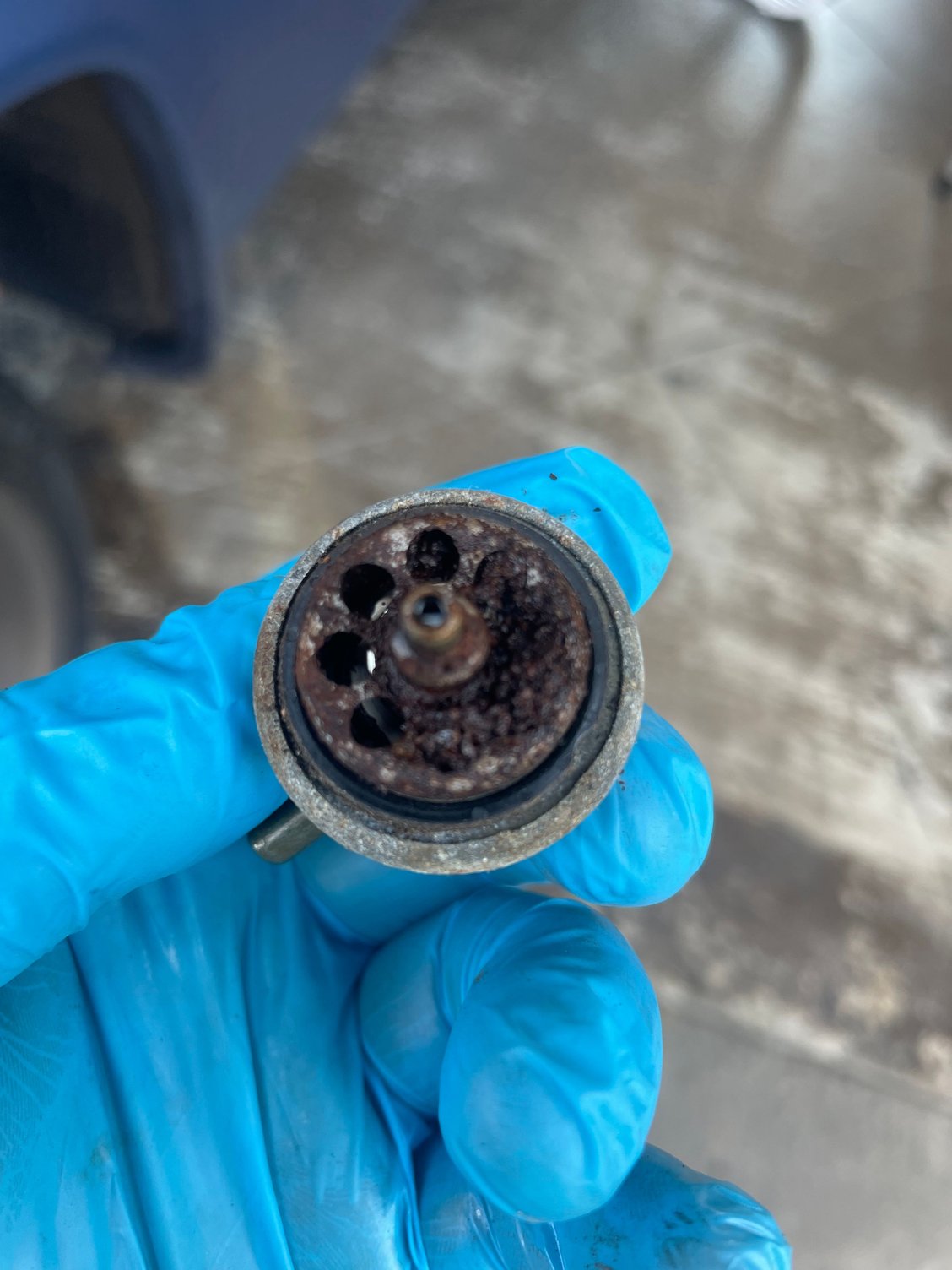

Thanks for the replies on my fuel problem. Def had 2 that were leaking and one stuck open. Replaced the fpr on the rail also. Think this could’ve been some of the problem too. Never seen this much trash Good ole cheap low octane fuel.
Horrible trash at the fpr
