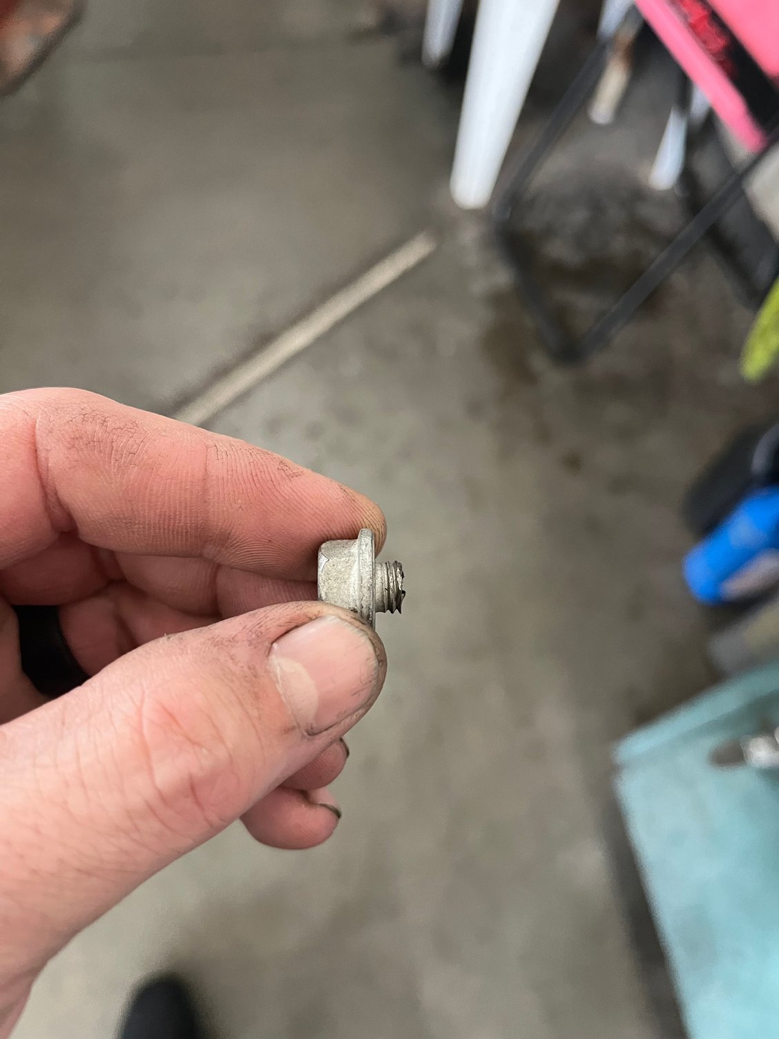

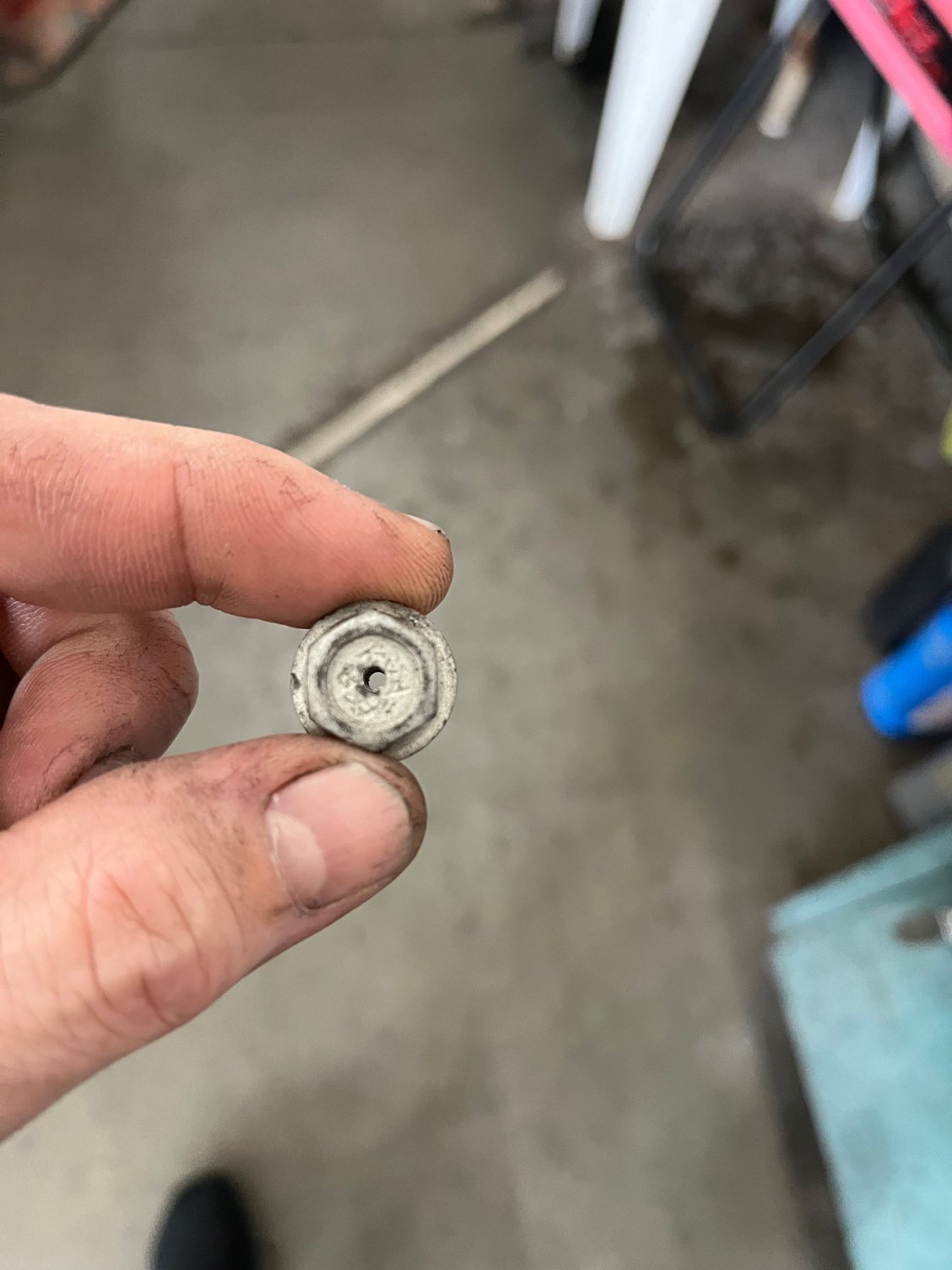

If you really want to drill them and they are deep in there, I have a way to center drill them. Take a 8x1.25 bolt and cut it down to where there are 2-3 threads showing then center drill it with a small bit. Then thread it in the hole and run that same bit through to center drill the bolt. I'll post a pic of the one I made in a second
Old Oct 12, 2023 | 03:44 PM
00pooterSS's Avatar
iTrader: (40)
Joined: Mar 2008
Posts: 4,920
Likes: 531
From: Dallas
The bolt I made for center drilling them
But again I would weld them.
Best scenario if you still choose to drill is to use the mayhew pro screw extractor kit if you still decide to drill them
