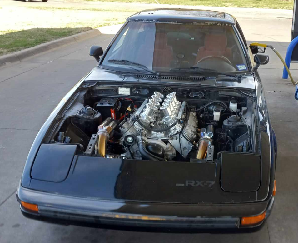

revisiting an old thread. Anyone actually use these types of adapters with NA setups and run into obvious performance issues. I run a set on a set of ITB’s as for some reason the ITB intake for a square port were half the price at the time. I have no doubt I could throw a TBSS On here an pick up power. That’s not really the question. I was just curious if anyone had glaringly obvious issues with the adapters.
My setup is JY 5.3. milled 706’s .100. Around 13:1*ish with a small (228/232 .550"/.550" 110+5) cam. With the above mentioned ITB’s. Setup acts like a diesel, lol. Pretty much the exact opposite of what I was shooting for. Pulls like crazy from say 2k to 4600 or so. Done at 5600 and falls off a cliff at 6k and above. Fun to drive and sounds pretty neat which is all I was really going for. But I’m thinking the adapters may be to blame here.
Don’t believe I can toss on a factory intake to test with this much milled off the heads. Was just curious if anyone noticed performance above 5k pretty much being neutered with the adapters.

the adapters absolutely kill power, runner length of the itb can change powerband significantly as well, e85 im assuming with the comp ratio?
706's are also the worst flowing ls head and the cam is way too small if you were looking for a high rpm screamer
put 243/799 on it and a cam that makes power up top and then adjust itb runner length from there

Not sure I agree. Esp. for a low buck small bore motor setup. People hype up the 799’s too much IMO.
706’s flow 230CFM 799’s only flow 20cfm more. Which is why swapping 706’s for 799’s picks up power on most mild NA applications. I knew I wasn’t going to need the additional 40CFM on a cheap little cam only 5.3. So I didn’t see the 799’s being worth the inflated cost.
I paid $500 for the motor and sold the 799’s for $400. Picked up the 706’s for $100.
I wanted the smaller chamber head to get the most compression possible out of the mill job. Since you get roughly 4% NA gains off each point of compression the 706’s make a better choice to get the most bang for your buck.
Similar deal with the cam. I went with a lower lift and duration to keep PTV issues down. According to the 5.3 test mule at TSP this cam made 428@ 6500RPM at 10:1. With 706’s It would have made more.
I’m was curious if anyone had actual before and after data with and without the adapters.
A friend linked me to the Holdner video below.
He dyno’d them back to back with a cathedral headed 6.0. LS2 intake VS LS3 intake with adapters. .
The LS3 with adapters made more power to PK TQ, then lost 10ish hp at a peak near 6500. So a 2% power loss past pk TQ isn’t bad at all IMO. I know the car would pick up a ton with a stock intake, but I was going more for sound and driving experience with this setup.

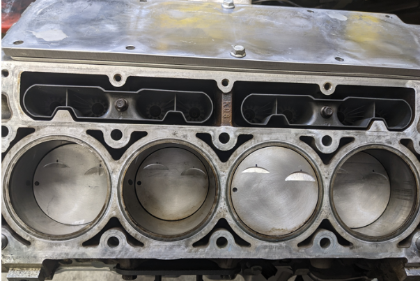

Thats the issue though. I couldn't mill enough off the 799 to get the same compression ratio. Was afraid to go much larger on the cam. I cut these heads down to 44cc.I had to fly cut the pistons .070 and .040 as is. Larger cam and larger valve would require much deeper cuts. Not sure how far one can go on OEM pistons. There's no easy economical way to play with runner lengths on this setup either. They angle towards each other. If I make them any longer they would interfere.
This was just a super mild NA build to see if I could find some extra "free hp" with cheap high compression and E85 on an SBE JY motor. Was hoping for something that sounded more "exotic" and less classic mild SBC is all. Really wanted the exotic exh note more than anything.
Just a fun daily commuter. Was surprised when It fell on its face well before 5.3 tested by TSP though. I could live with it pulling to 6500rpm as they show.

whats your ptv clearance currently? i flycut my 6.0 pistons .120" so you should have some more room there if you wanted

Around.0100 on the exh and a bit over .080 on the intake. Hoping to leave this thing together awhile. Plan was to find/build a budget gen3 6.0 and put some square port heads on it. Haven't seen a deal on one yet.
