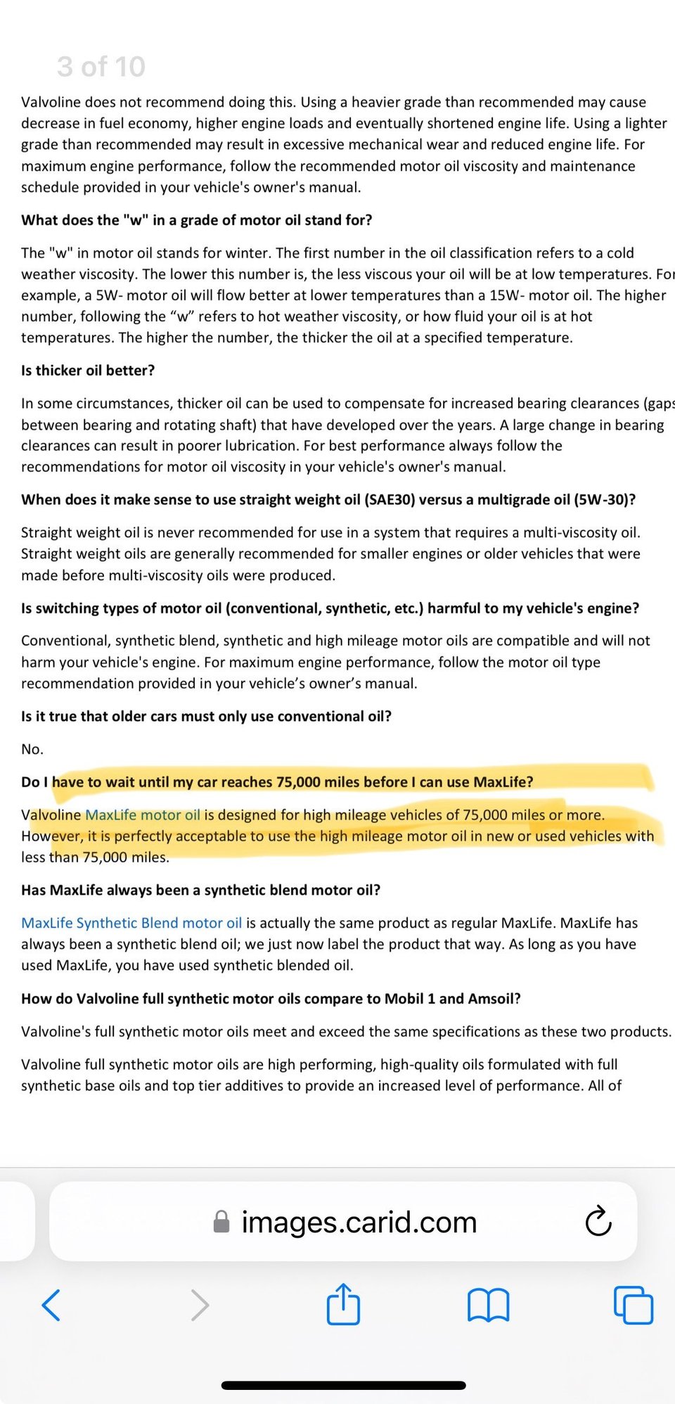

I think you’re overthinking it a little. I bet Valvoline Maxlife would suffice. I’d even opt for the high mileage variety. It allegedly has more robust additive package for seals and such.
what it has is seal swelling additives to prevent leaks in older cars, and additives to prevent engine gunk deposits from being wiped clean which could also cause seal leaks and clog oil pickup tubes and passages.
definitely something I don't want in a fresh 4000mile motor
It won’t swell new seals to where they’re larger than their original size. I doubt it actually “swells” old seals really. At any rate Valvoline says it’s ok to use in low mile motors, and I’ve use it for years in new cars and they’re still not leaking now that they’re no longer new.

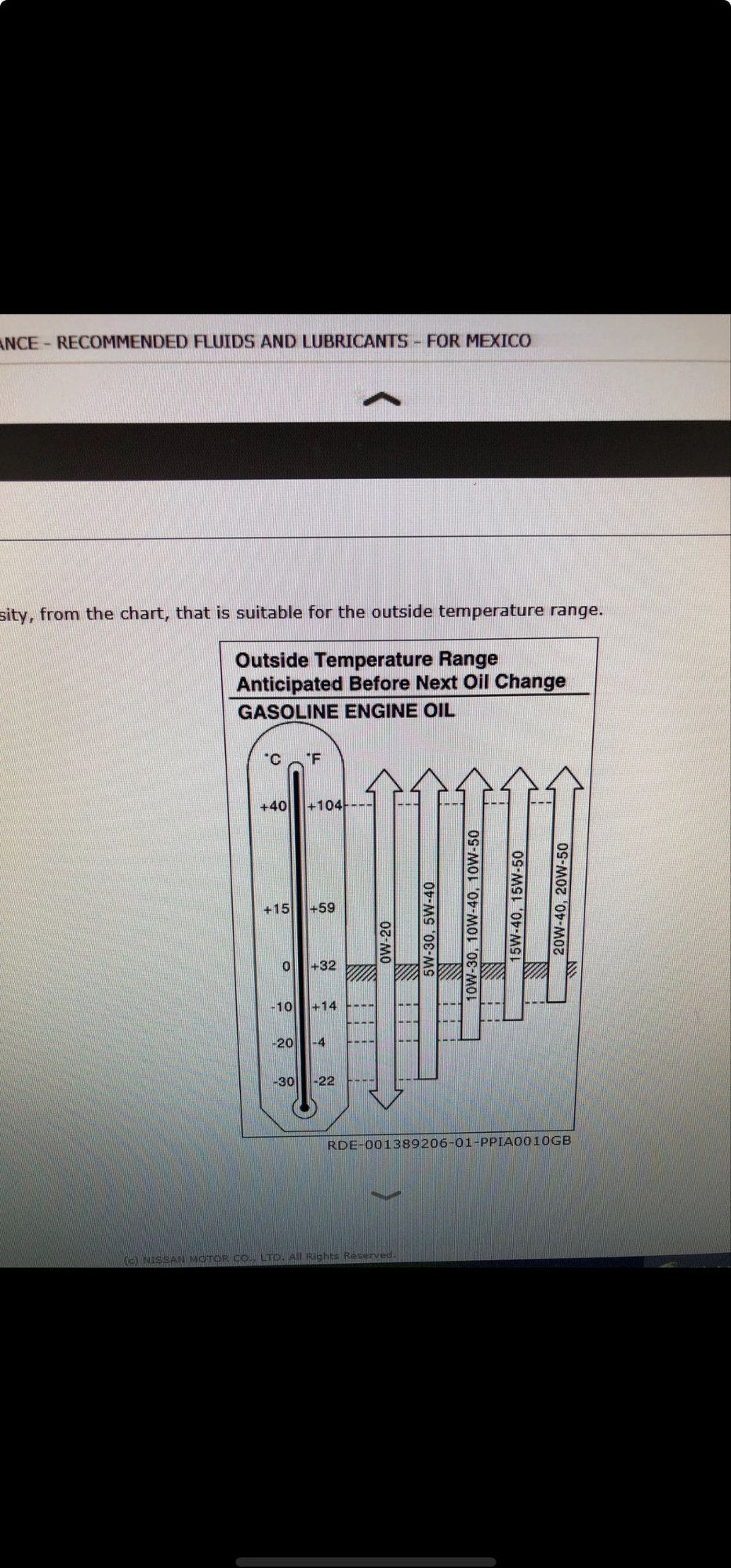

I have to ask…why are you going to a 40w oil? Stick with the 30w with your clearances. Absolutely no need to go 40w.
I bet the 40w won’t lead to anything breaking though. The engine might be a hair less efficient than it would with a 30w but I bet not by much.
Look at this chart. This is for a ho-hum everyday vehicle and the manufacture says that it can use as thin as a 0w-20 and as thick as a 20-50 depending on the ambient temp. That’s a pretty big spread. I imagine ole boys new motor has a little bit of wiggle room as well. The word on the streets is that the 0w-40 flows well yet is “robust.” The 40w’s are allowed to have more ZDDP than the 30w and lighter oil due to CAFE standards. I believe the 30w’s can only have 800 or so ppm of zddp, and I believe Mobil 1’s 0w40 “European blend” has something like 1100.

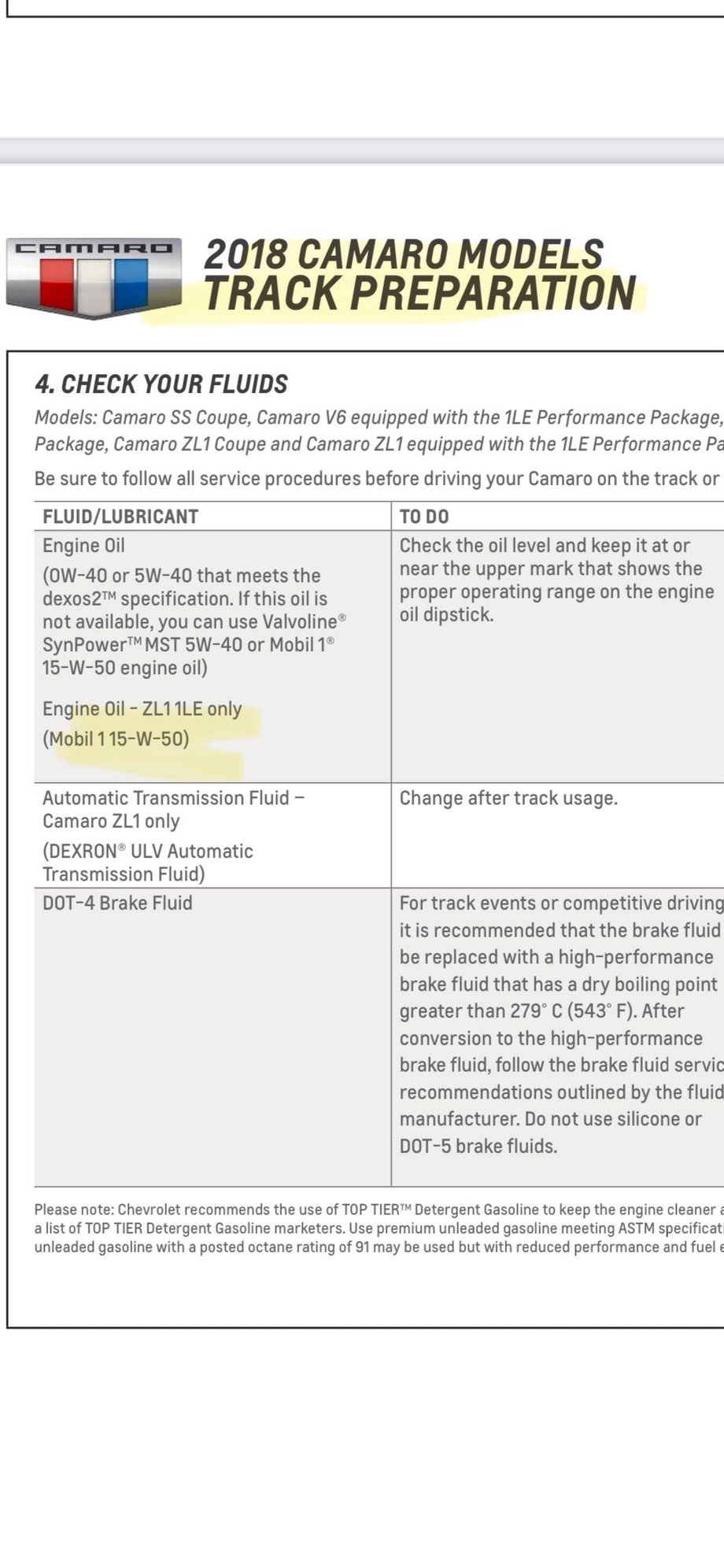

Originally Posted by RB04Av
Couldn't have said it better myself.
My personal juice of choice is Mobil1 5W-30 or 5W-20, depending on whether it's gonna be summer or winter before I change it next, respectively. If it's summer and I think I'm REALLY gonna be beating on it, like towing or something, I'll step all the way up to 10W-30. All the rest of that is just noise and distraction. You can get it in ANY town ANYWHERE that has a Wally World, or even most truck stops beside the freeway, and it's ,.. entirely adequate.
One thing to remember about oil is, the wider the range between the W (cold) and the other (hot) #, the less stable it is, the less oil it has in it and the more addiditves instead, and the shorter it will last. 0W-40 is a worse choice than 5W-30 if for no other reason than that.
Sometimes "perfect" or "best" is the enemy of "get it EFFFFFING done". Of all the things that's gonna make or break your build, the brand and weight of the oil is REAL LOW on the list. Barring a complete screwup of some sort, like straight 50 or something royally stoooopid like that, of course.
I pretty much agree with all of the above. Speaking of 50wt, GM recommends 15w50 when tracking an ‘18 ZL1. Like a thicker condom I guess.
