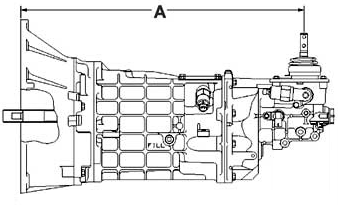

10. ( possible shifter relocation bracket, idk if I will need or or not just yet, will have to measure the BRZ or FRS's original FA20 Engine's transmission's mating surface on the bell housing to the shifter's distance, and compare that data to the CD009/CD00A's bell housing's mating surface distance to the shifter location when the CD009 is adapted to a T56 bellhousing via ICT Billet adaptor, so idk if I will need a shifter relocation kit or not just yet, because I can't find the data on that distance on the internet anywhere so far. Here is a picture of what I am talking about for reference )
The distance of A is what I need to find out about the stock FA20 engine's own OEM transmission. And also I need to find out whats the distance A for the CD009/CD00A transmission when the CD transmission is connected to a T56 bellhousing via ICT Billet adapter, then I can determine whether I need shifter relocation kit or not.
(This graph is only for reference, I am not using T56 transmission)
