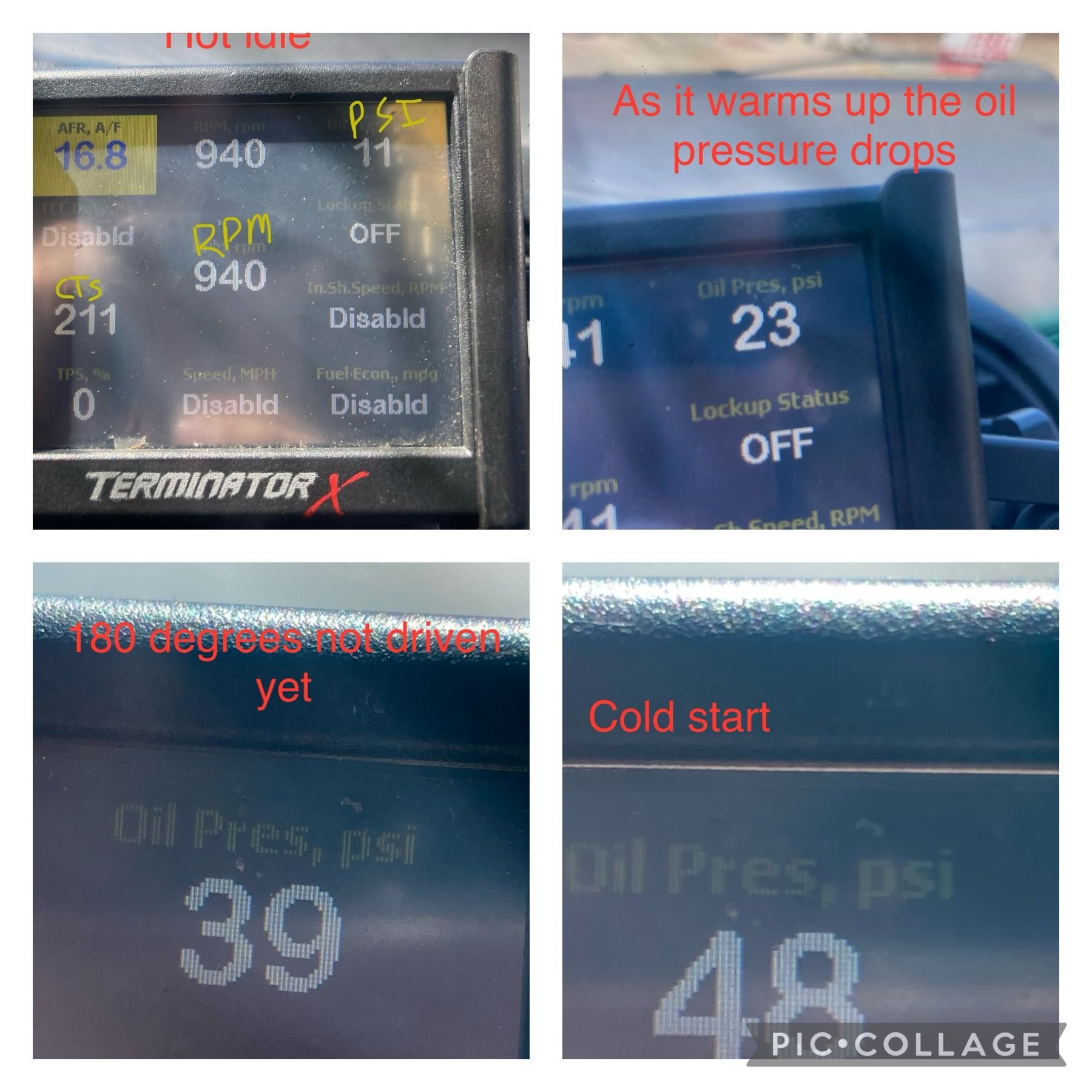

Then I noticed low oil PSI (only when hot) so I drained the fresh oil
PSI numbers were as follows:
cold start 50 PSI drops to 40ish
warmer (coolant tmep 190) I was seeing 30 PSI even at 4500 RPM
HOT coolant temp 210 and I started seeing a slight reduction in PIS like mid 20's and idle was 10 even seen it hit 8 once

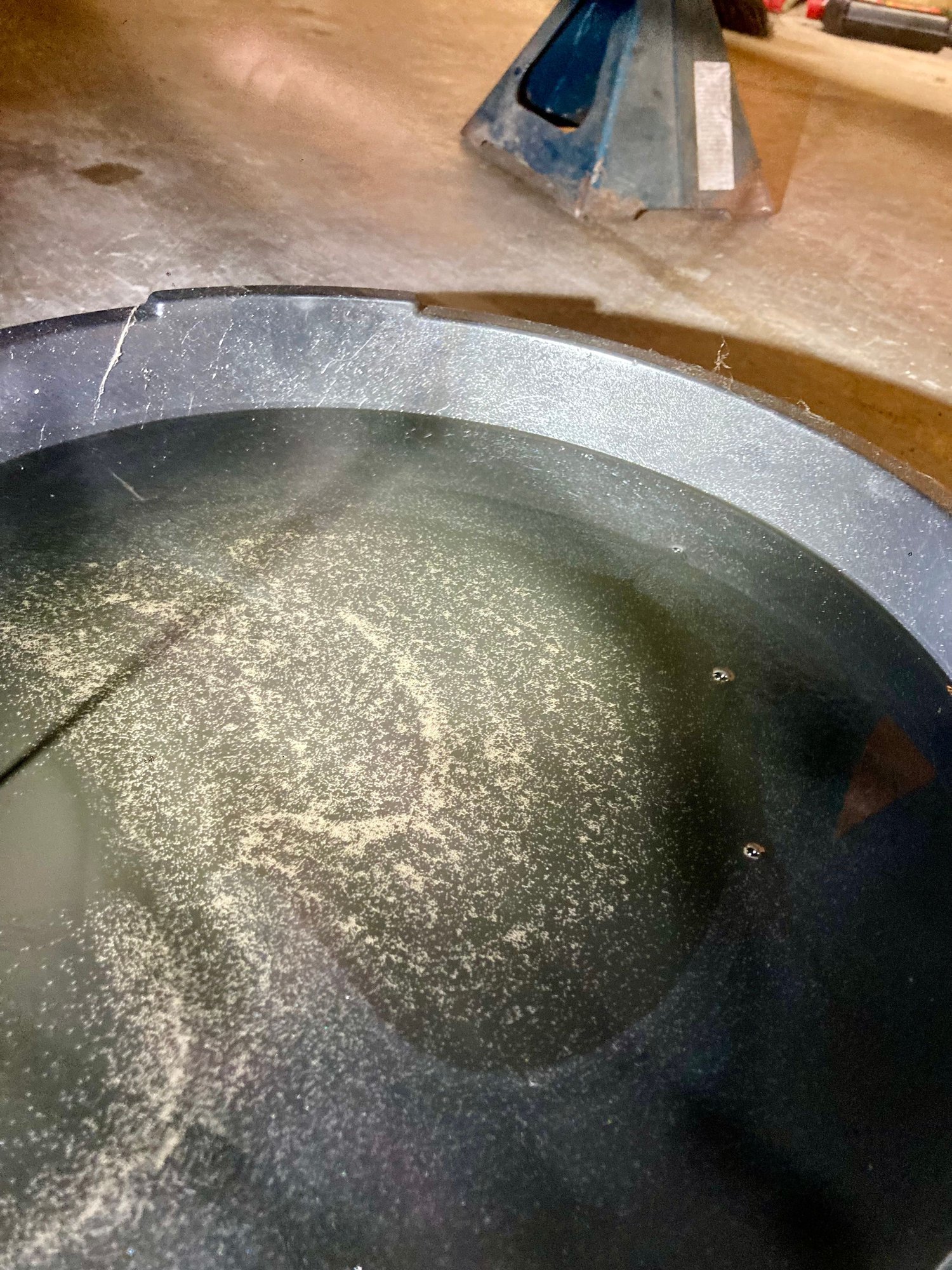

Now I know the oil sensor is not that great and the screen may be clogged. (ill know soon as I have the motor mostly undressed just have to pull the cam sensor to get the oil sensor out) anyway this prompted me to drop the pan but as I drained the oil I seen the glitter in the oil..

I believe the top right image was taken while moving. THe rest are at idle and you can see as temp goes up PSI drops barely acceptable levels. IF the glitter was not present I would not be so worreid.
My next step is to use a coffee filter on the container I empteid this into, but the bottom of this container looked like a gold panners dream

Copper from the bearings.
Yes, it has to come completely apart and be cleaned/inspected.
What the hell are " 100 lb injectors" doing in that engine for a 400hp build?
Pooch the tune, wash the bearings with fuel, and you have the mess you now see.

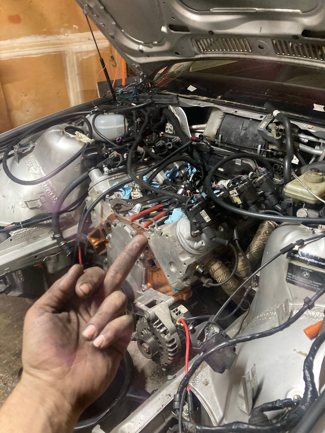

Her
its on its way out waiting for a cherry picker now
