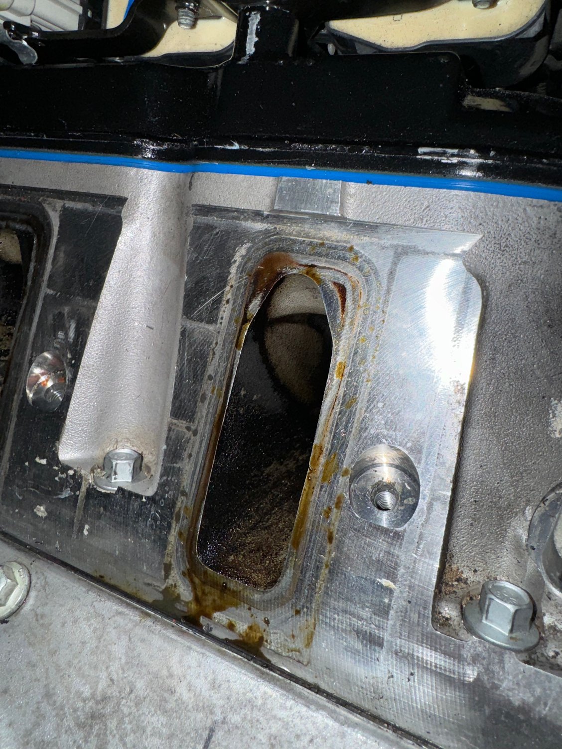

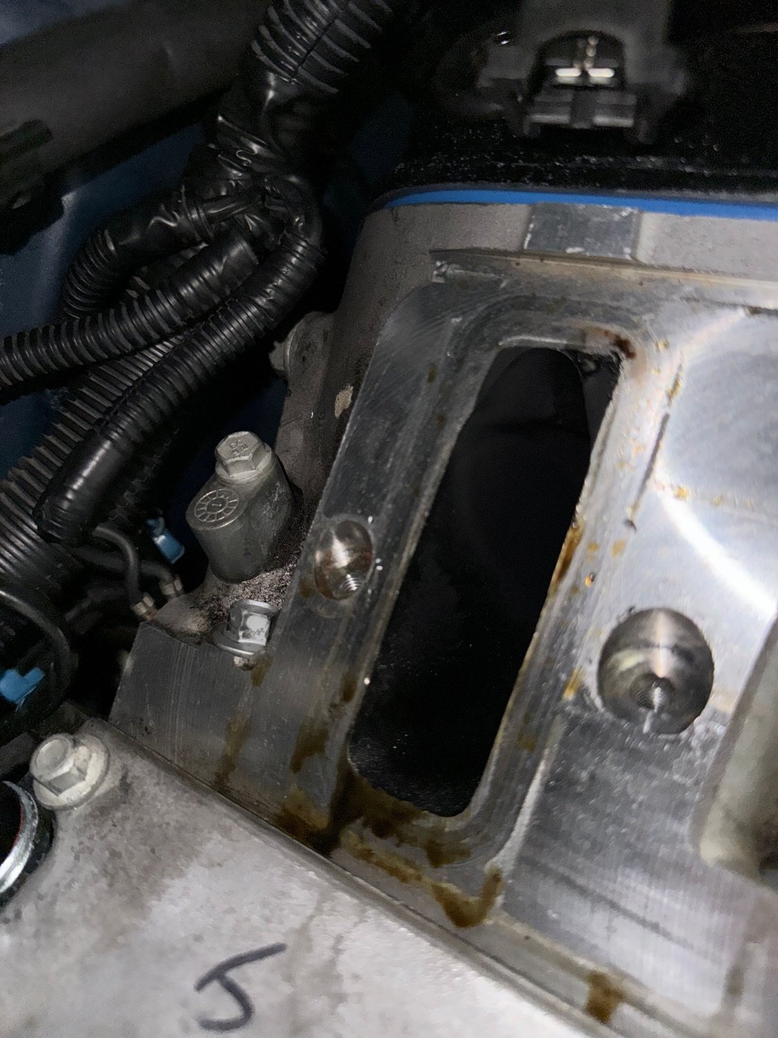

Cylinder #7 is black as hell
Compared to the clean #1
