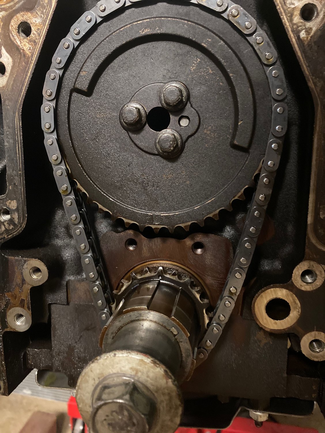

So I’ve got the guts open on my LS, replacing the oil pump. There’s slack in the timing chain per usual. Should I throw a dampener in? I don’t want the plastic to break or chip with high rpm or anything but I don’t want to lose almost a half degree of timing. Any thoughts?

The plastic one-piece block that bolts to the 2 holes in the middle has proven extremely durable while doing its job of stabilizing the flapping chain action..
Plus, it's relatively cheap and no-brainer to install if the front cover is already off.

Zackly. It keeps the chain from trying to wrap around the crank gear, which is surprisingly stressful to it. A good cheeeeeeep effective little gem.

It's more stressful to the chain. If it can't let go of the sprocket teeth when it needs to, it ends up trying to get pulled apart. Which is why that simple little block helps. Sorry my wording didn't make it clear.

No, im reusing the factory single roller timing chain.

I would at least put a new LS2 chain in it with the LS6 chain guide/Damper.

The factory timing chain dosent have a lot of stretch, just normal slack. ill just throw a dampener in and call it.

Yeah it's probably fine, I just look at it as cheap insurance. They are only 30.00 from Summit.

The motor has around 110K miles, if im changing the chain, i might as well get a new sprocket and gear. brand new timing set.

Most timing chain kits come with the chain and cam and crank sprockets. I'd suggest replacing the chain and sprockets while you are in there. An LS2 timing set is a good choice that is stronger yet doesn't require clearancing anything for it to fit. I put an LS2 timing set on my 62k LS1 when I was doing a cam swap, the old chain was really stretched.

It all depends on the block. The early LS1s and LS6s used a dampener with a wider bolt spacing and those dampeners are harder to find and more expensive. All other LS engines, not including the LS7, use the same much more common dampener with a narrower bolt spacing. (And some early LS1 blocks aren't even drilled for those bolts.)
Whatever block you have, you should measure the bolt spacing to make sure which version you need.
The chain pictured in the OP's first post looks pretty tired and stretched.

Doesn't the LQ4 fall under the LS2 designation? Mines an LQ4. would the LS2 timing set mess with the timing if its a tighter chain or am i just overthinking?

You are over thinking it. A new chain would actually improve timing, making it more accurate.

LS2 is just the term used for the chain first introduced on the LS2.
It will do well on nearly any LS engine. Including the LQ4.

will this chain dampener work on my LQ4 with a new factory style chain and cam gear?

Yes. Your block already has the holes for the attaching hardware.
It is all made to work together.
