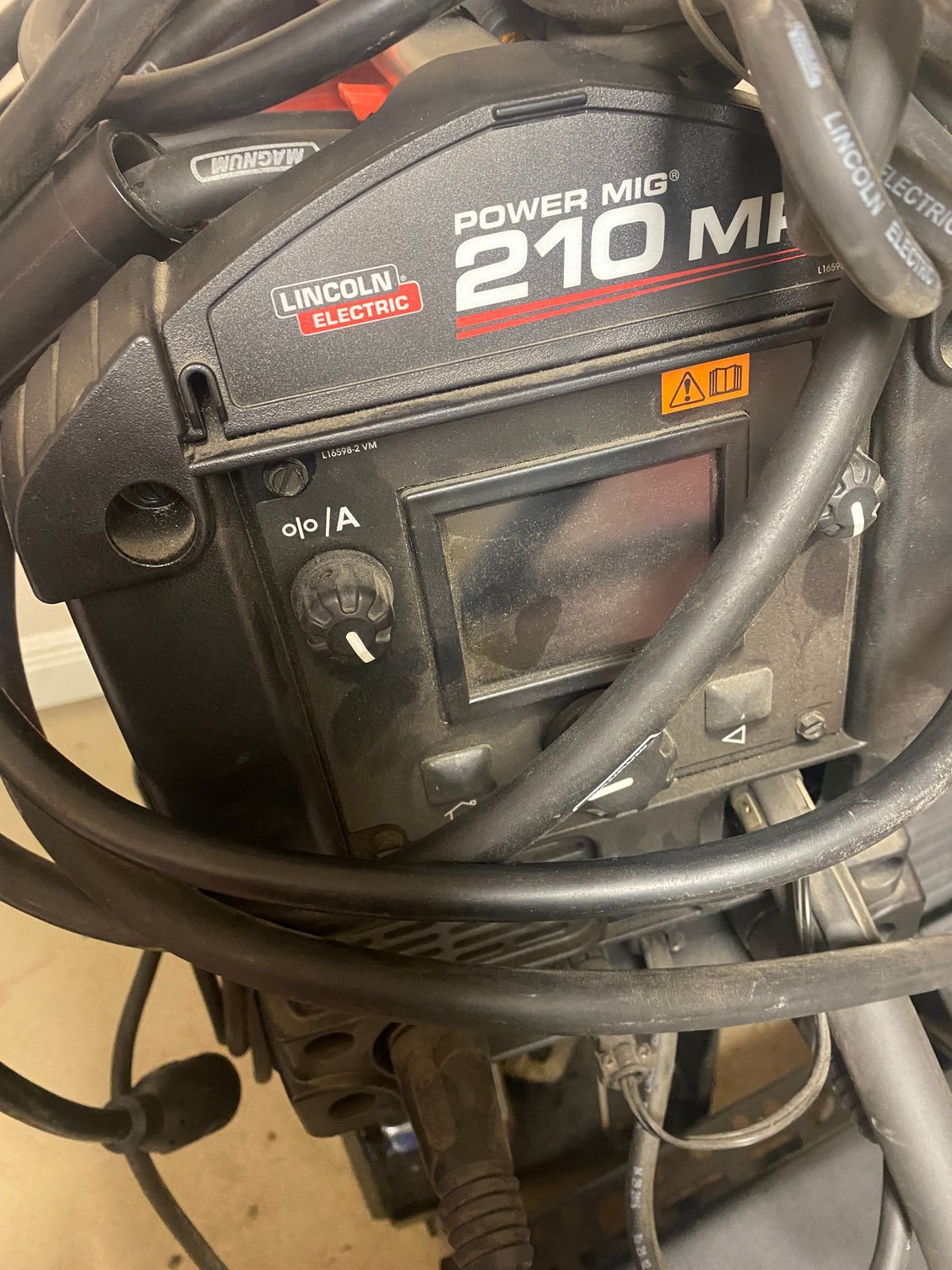

Made about 3-4 passes with the high heat setting,
I turned the heat up to D the highest it’ll go, adjusted the wire speed. Used HF nuts, grade 8 nuts. Pushed the nut as flush as I could with the screw surface. Sanded both surfaces with a 150 grit sandpaper. Let the welds cool down. As soon as I put an ounce of torque on the ratchet the welds give loose like butter. Is there something I’m missing???? This is astonishing to me, burnt through 15 nuts so far.

I don't know much about Flux core wire, but I suspect that might be the issue. You mentioned haveing another welder that uses argon mix gas. If you can, try that. Other wise you will have to drill the head off first. Then use an extractor.

Yes, it’s a Lincoln 210HD welder. Never knew how much argon it needs or what the ***** do so I didn’t go fouling with it. I’ll upload some pictures soon.

Open the bottle all the way and set the regulator to around 15 CFH. Don't go past 20 CFH.
