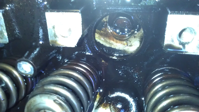

If so, pop off a valve cover. See if there's nice puffy yellowish foam in there. If so, check the casting mark on the head castings and see if there's one that looks kinda like a D cell battery, toward the right (front on the pass side, rear on the driver's) kinda under the rocker stand rail. If so, check all the head bolts in the center row (upper row of large ones) for places that look steam cleaned. If so, you have the ever-popular Castech 706 crack. It'll look something like this.
If so, I see new/welded-up/other heads in your future.

I actually have a video of that leak in one of them 706 Heads, buddy of mine built a 5.3l and a couple weeks later it had water in the oil. He looked into it and found that Head issue. We started it, let it run till hot, shut it down and pulled a Valve Cover. Watched the Coolant literally come out of the metal.
​​​​​​​That's hyeeenous. And I thought mine were bad...

Not even lying, I'll see if I can speed it up and post it, it's a few min video but it's literally Dexicool growing out of the Head.
