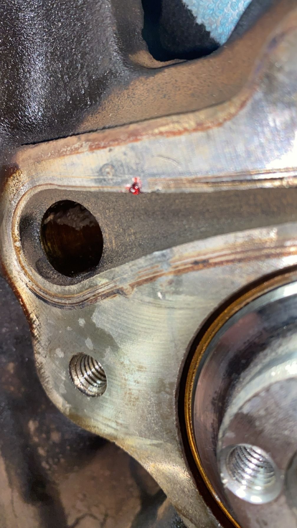

That is why I said what I said above, it's oil soaked so you have to take that into account. I've welded cast aluminum and that's even worse.
I suggested the weld because I have the capability, most don't for this here. This one is tricky.
I'm thinking my idea if a plug might be the trick. but again that's if it's even needed. As I've posted, block it smooth and see if it even leaks.

The photo i posted not be the best angles but the divot is very small. like small enough as in i could use a syringe to squirt a little bit of silicone and that would be enough (example). I think ill just clean it as best as possible and do the silicone method. ill let you all know how it goes.

picked up some sealant and cleaned the area with brake cleaner for about a dozen passes. Put some gasket sealer in the gap, couldn’t ask for the sealer to be anymore flush with this gap. Now to let it settle for a few days (which is when I will be able to get to this next) and throw the retaining plate in. But before that I’ll be blasting metal shavings out of the lifter oil ports. Shavings got everywhere when I used the carbide bit to cut the plate. I blasted out shavings around the cam and main bearings. Now just to use the air and I should be on my way.
