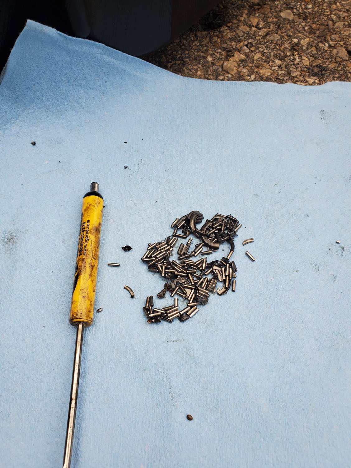

SAPPER's Avatar
iTrader: (10)
Joined: May 2004
Posts: 1,593
Likes: 267
From: Halfway back on the Highway to Hell...again!
CHE FTW. Otherwise you end up with this in your oil pan using needle bearing style.

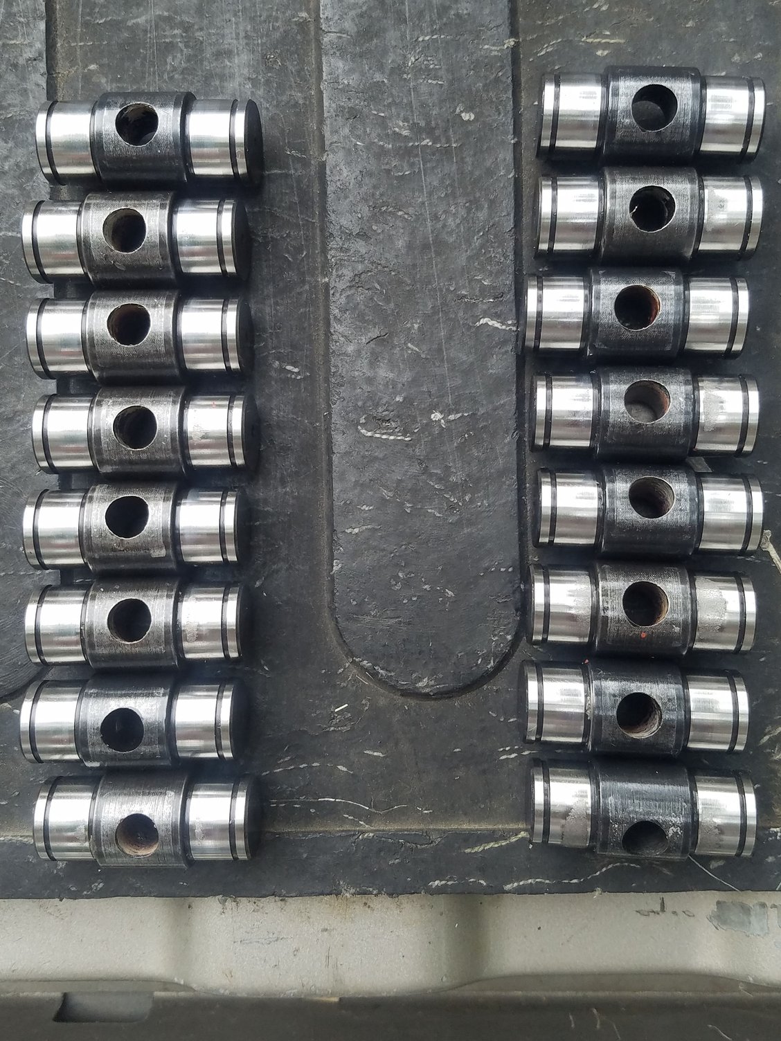

Old Sep 27, 2024 | 07:36 AM
01CamaroSSTx's Avatar
Joined: Feb 2015
Posts: 6,014
Likes: 2,294
From: Conroe, Texas
Or what you see flaking off of these Comp trunnions. These were purchased in 2015 and only had about 3,000 miles on them.
Old Sep 27, 2024 | 11:28 AM
grinder11's Avatar
Posts: 3,212
Likes: 1,612
From: Michigan & Florida
Looks exactly like mine did. I have to believe Comp has redesigned them by now. At least I'd like to think so. Comp is a good company...
