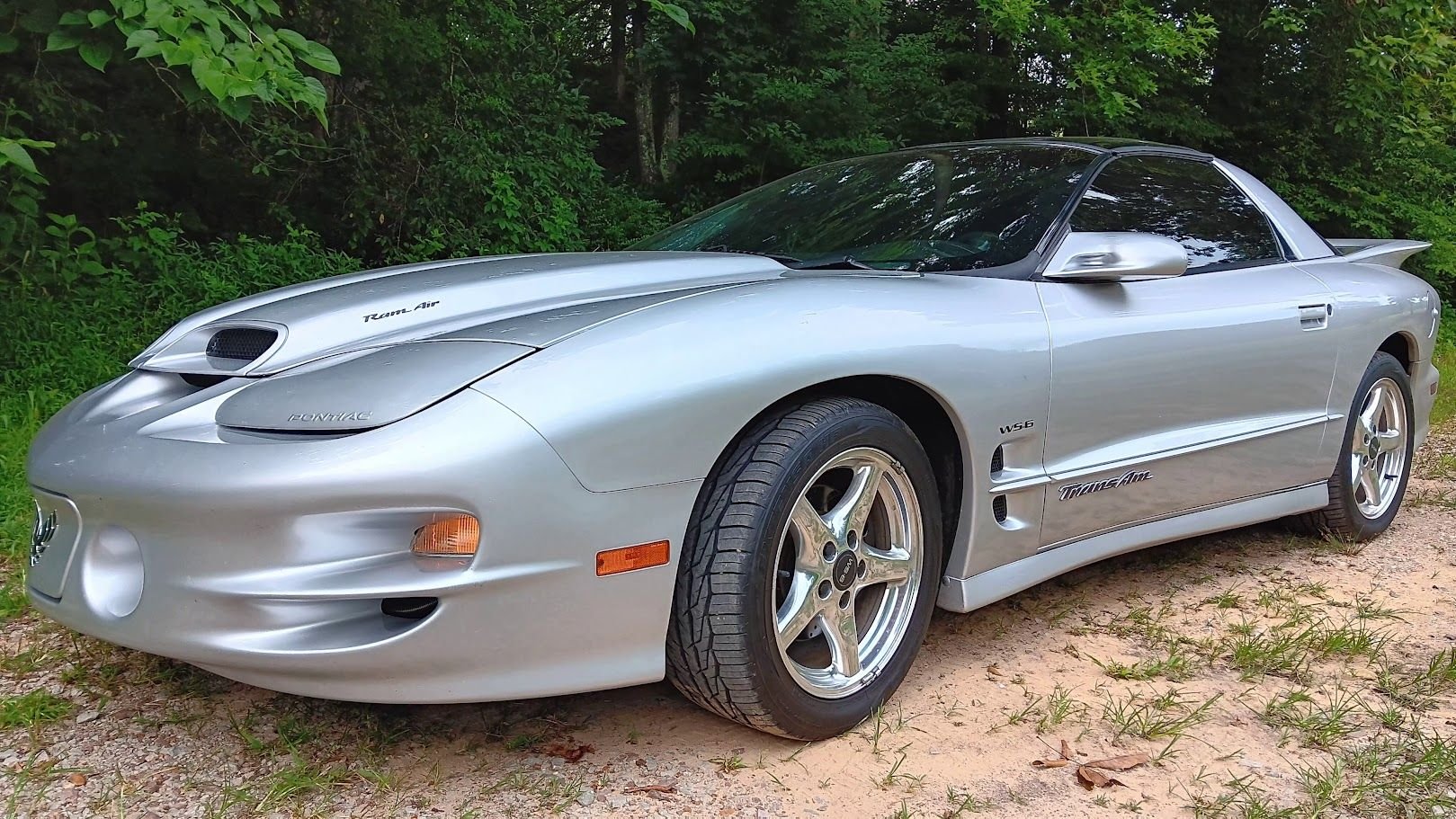

I’ve seen 40w oil quiet down these noisy lifters…worth a try before you put it on jackstands for 2 years and sell it off for parts. We need pictures of this car BTW…
lol I have tried everything..... thinnest oil to thickest oil, best thing Hot shots lifter additive has worked the best, they gave me a bottle at LSfest to try.
PICS!!
Welded on some quad tips to fill out the rear
