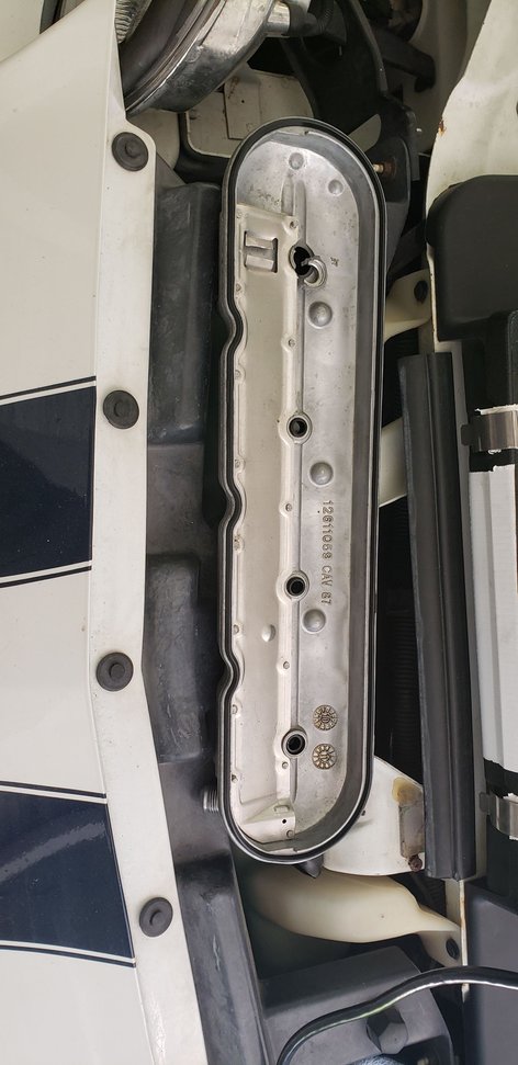

Find some valve covers with this type of baffle.
Find some valve covers with this type of baffle. Running these with T&D billet adjustable roller rocker arms and a 3/4" valve cover spacer.

Do NOT remove stock valve cover oil baffling. The GM system isn't all that great to begin with. Removing the baffling will make a bad setup even worse. If you need extra clearance, get thicker seals or use cover spacers.....
