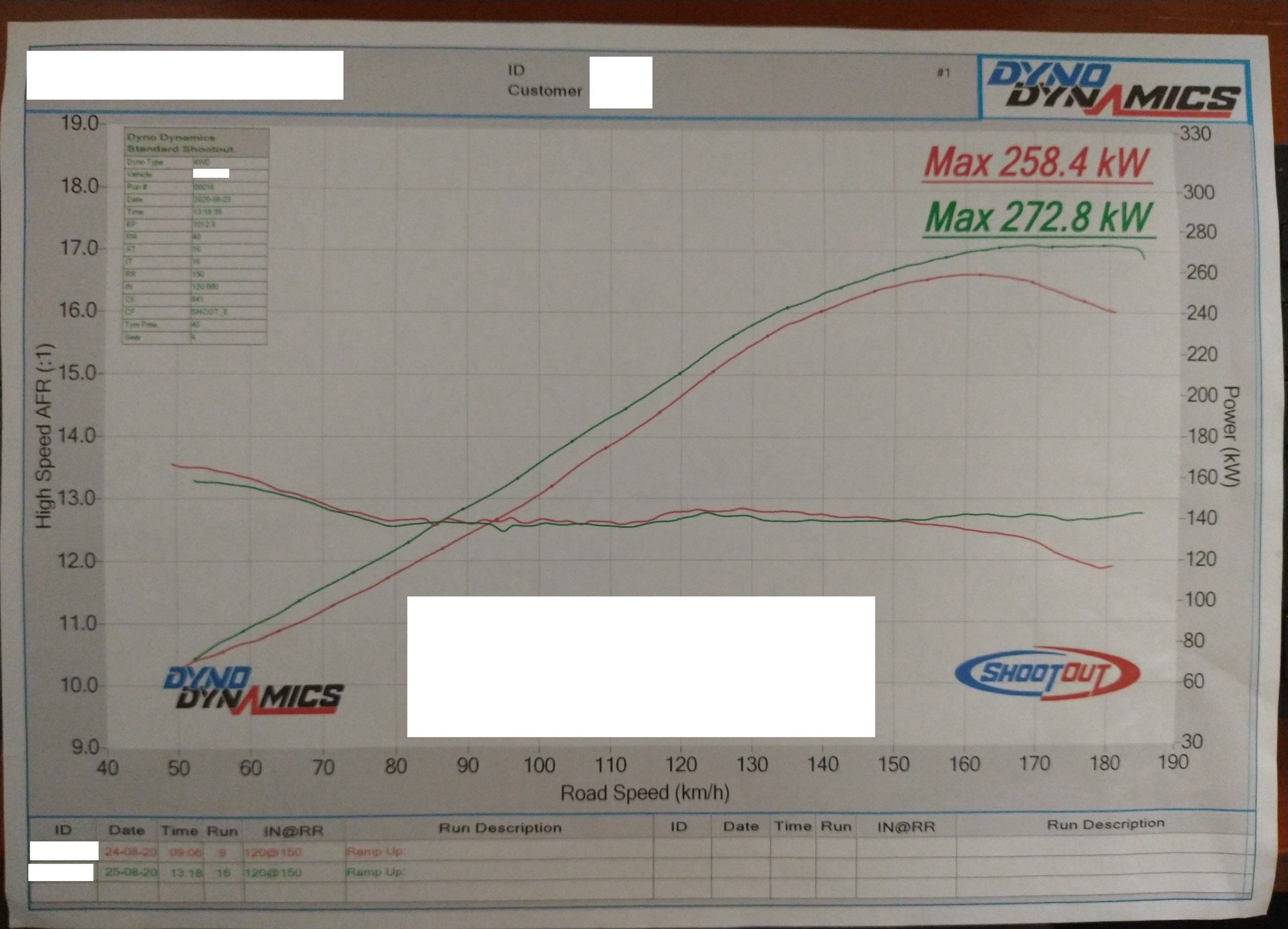

Thanks for the kind words. It's awesome getting to talk about this platform, as I'm a huge fan of these cars and LS engines.
Correct, I have an M6 LS1 with a 216/220 .600/.600 112+2 TSP cam, with heavily CNC ported 241 heads and all the other bolt ons. The Crow Cams are really good stuff, my shop uses them exclusively. But yeah, if I were in the USA I would certainly just buy local. You guys are spoilt for choice with amazing Cam manufacturer options!
I really like the TSP cam I have and the combo in general, very punchy on the street. Still did ok at the strip, mid 12s in the stinking heat in 100% street trim many years ago. Just drove it on, chirped to clean my street tyres and launched at around 2200 rpm and off she went. Not for everyone, but I like it.
Cams in the 218/227 range were very popular back in the day. They seem to work well on an LS1. I jumped on that band wagon to replace my prior baby cam and imported a Cam Motion 218/226 .595/.587 116+4 as they recommended for my requirements. Unfortunately it didn't go well for me. Was a real slug in comparison and the dyno reflected that. Excuse the KW and very low figures, our dynos read much lower than the US and this one was extra stingy (and the shops proud of that! ). So, I went back to the a baby cam, the TSP this time.

wow yeah that 216 220 cam is better everywhere. This is just my hunch, and i think we talked about this before either here or ls1gto, but I have a feeling that if you had that cammotion cam ground on a 112+4, it would have performed very similarly to the tsp cam.
Cam motion cams are a bit more conservative in their ramp rates compared to tsp. I believe they have a 55 difference between advanced and .050 durations. Tsp is without a doubt 52.
SurprisIngly, the young man who won weingartner's camshaft challenge used standard cammotion lobes. So they can make more power while remaining very valvetrain friendly. TSPs current lobes are also pretty friendly. I might go with the summit 218/227, .600, .600, 112+2 cam. 49 ramp rate though. Has performed great in Richard holdeners tests.
Independent Motorsports in Australia had great results recently with the cammotion little chopper cam (222/232, .595, .587, 108+3). That 108+3 is gnarly and the overlap is kinda high at 11 but the tuner said it was a pretty easy tune.

The TSP certainly felt better everywhere! Low down and in particular up top as you reved it out. First drive and I was so happy with the car again.
I'm sure you could get similar results to the 216/220 cam out of a similar cam to the 218/226 by tightening up the LSA. For my choice with the 216/220, I was trying to keep the overlap at a certain point to keep the manors where I wanted them. For the 218/226, I just bought what Cam Motion recommended for my needs, which was the Torque Titan on 116+4.
​​​​​​In my experience, there was nothing in it for lobes between TSP and Cam Motion. My valve train actually seemed quieter with the TSP.

good to know about the tsp lobes.
Wait so what are the two lines in your dyno graph? Are they the two different cams or just the tsp cam before and after tuning? The lower line really dies off in power up top.

You read it correctly initially. Green is my current 216/220 TSP, @272.8 rwkw. Red is my previous Cam Motion cam @258.4 rwkw. Only change was the cam, moving from PAC single springs to Crow dual springs and a retune. But yes, the Cam Motion Torque Titan drove exactly as the graph shows, completely died up top. However, I guess it was meant to be a low down performer despite the larger duration.
