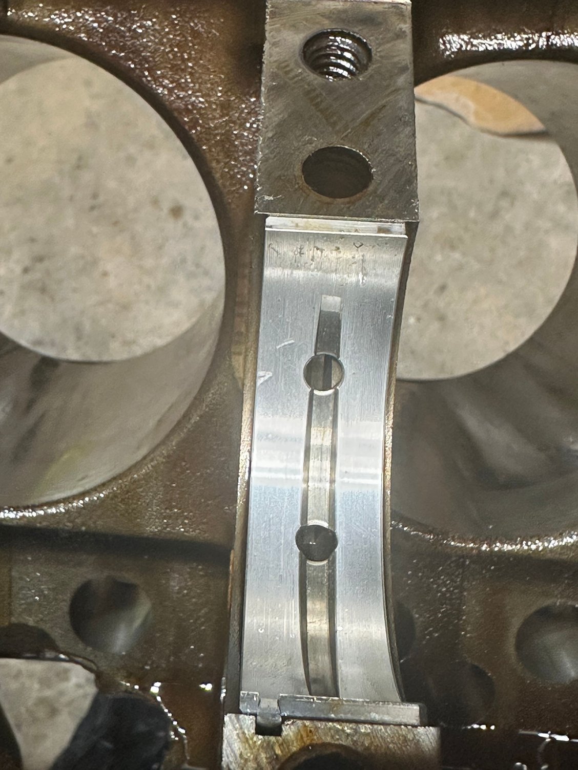

Thanks for the advise on the cam and springs. What went wrong with my last build. The springs I use weren’t strong enough for the cam. I didn’t know any better. Super rookie mistake, costing me time and money.
in positive news I got my box from Summit today lol with my lifters in it, lol and my head gaskets.
I thought I was just gonna shove this Elgin cam in and save the BTR cam for my aluminum build that needs some undersizing on the bearings. But my longtime friend( the Ford guy lol ) convince me that my car bearings were bad and needed to be replaced. He’s built many motors. I’ve leaned a lot form him over the years. I kept repeating t what most the LS guys say. Run it! This damn motor ran I drove the totaled truck it was In all winter So when I pulled the block apart, everything looks great, but I damaged one of my mains sadly.
Just an extra week and some plastic gauge I guess. I’d rather have the machine shop set it up tho and should just do rings too since I’m this far in and they crusty AF. Long story short if you’ve got a running motor, don’t ******* pull it apart. Shove the camera in and ******* run it. If you drove it and you know, it ran just ******* run it. Now I’m looking at a full rebuild of a running motor. I could’ve went to the damn wrecking yard months ago and done this.
