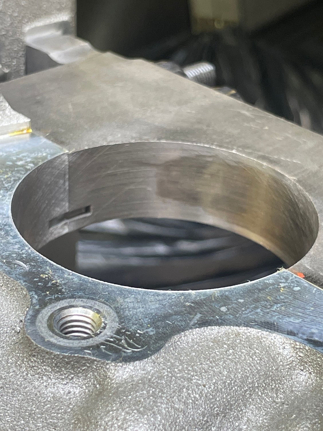

Here’s a picture that proves you must line hone with ARP studs. I took this picture last summer while building an engine for a client, just to show others why. The dark “shadowing” area is where the hone did not touch. The bore is 100% out of round due to the extra clamp force from the studs. This picture is the finished product, after honing was complete.
