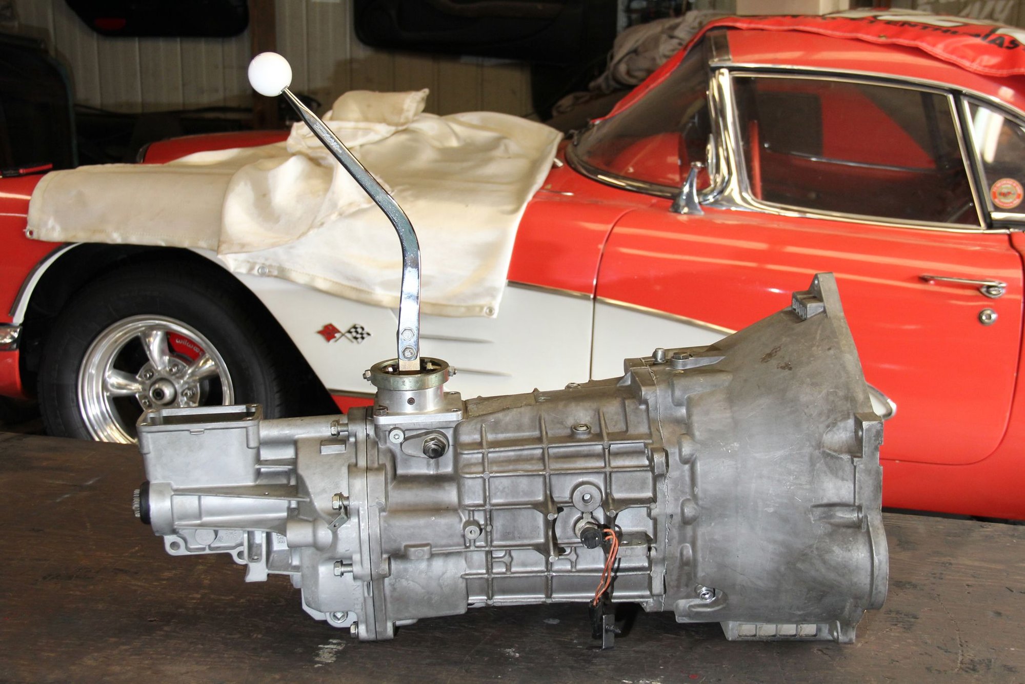

01CamaroSSTx
The T56 is a monster compared to an old 4 speed.
No problems staying together when 12 to 15 inch tires grab, repeatedly? Any modifications needed for around 500 hp beating on it?
Wandering where that shift tower would place on a ‘82 GMC. I don’t mind fabbing the hump. We’ll mock everything up and cut accordingly.
It will get some bucket seats, but that thing looks like it would come up through a bench seat. Ha!
I’ll look into what I can get on for around here. Thanks

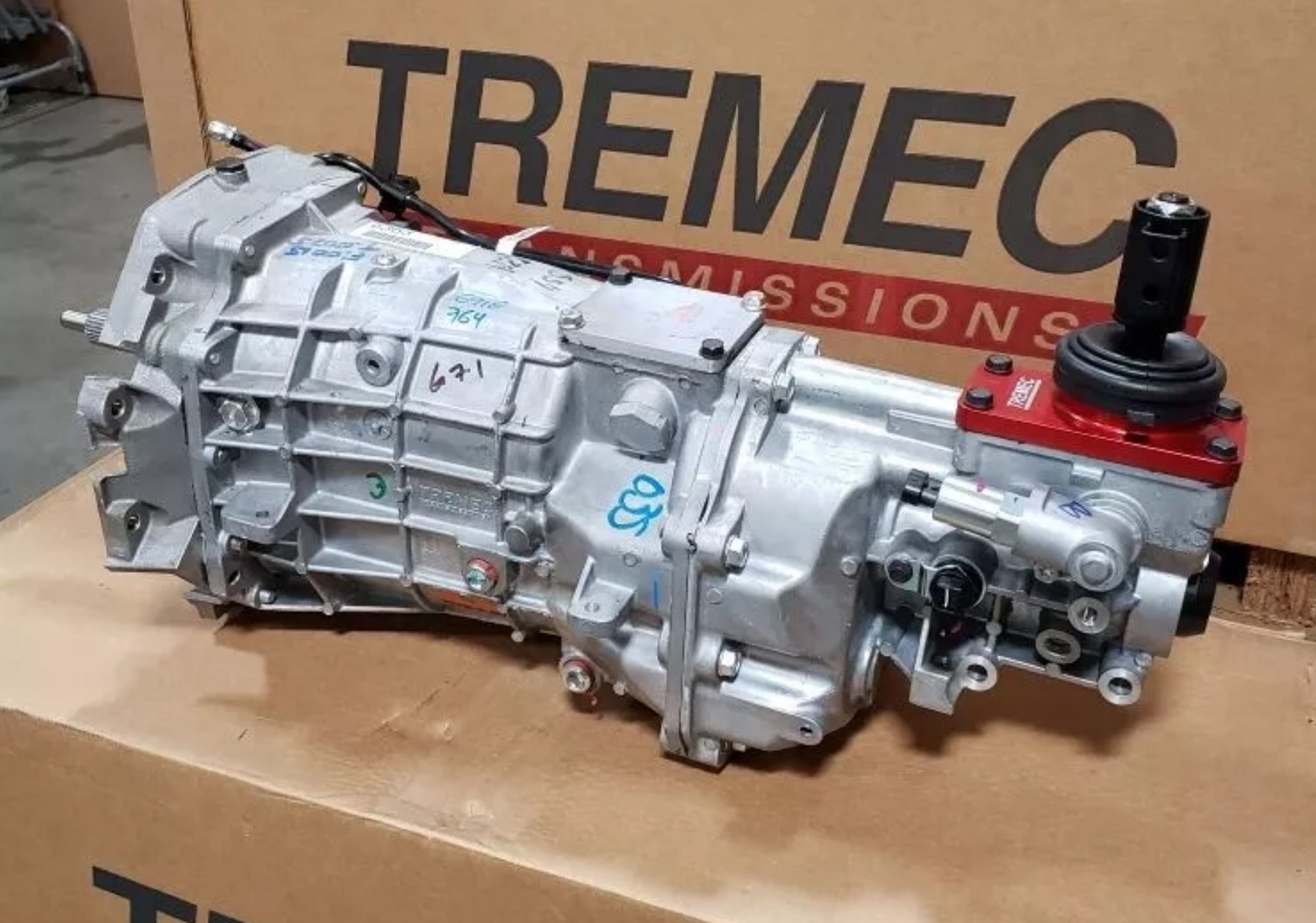

Well if budget allows you should look at upgraded versions of the T56. The stock T56 from what I've heard is not going to like the abuse 450+ ft lbs of torque. It may take it for a little while but if you're gonna be beating on it then look to have it built to take abuse. RPM Transmissions and Tick Performance are places to look for modified T56's

01CamaroSSTx
yeh man, I will have to put that off. Maybe something to consider later on. I would have to get the T56 Magnum and that is about $4000+ and would need a shift tower forward relocation kit to put it in a truck. That’s another $500+. It was a good thought for the moment. One thing for sure though, the T56 Magnum would laugh at 500 horses like it’s nothing. Very nice.

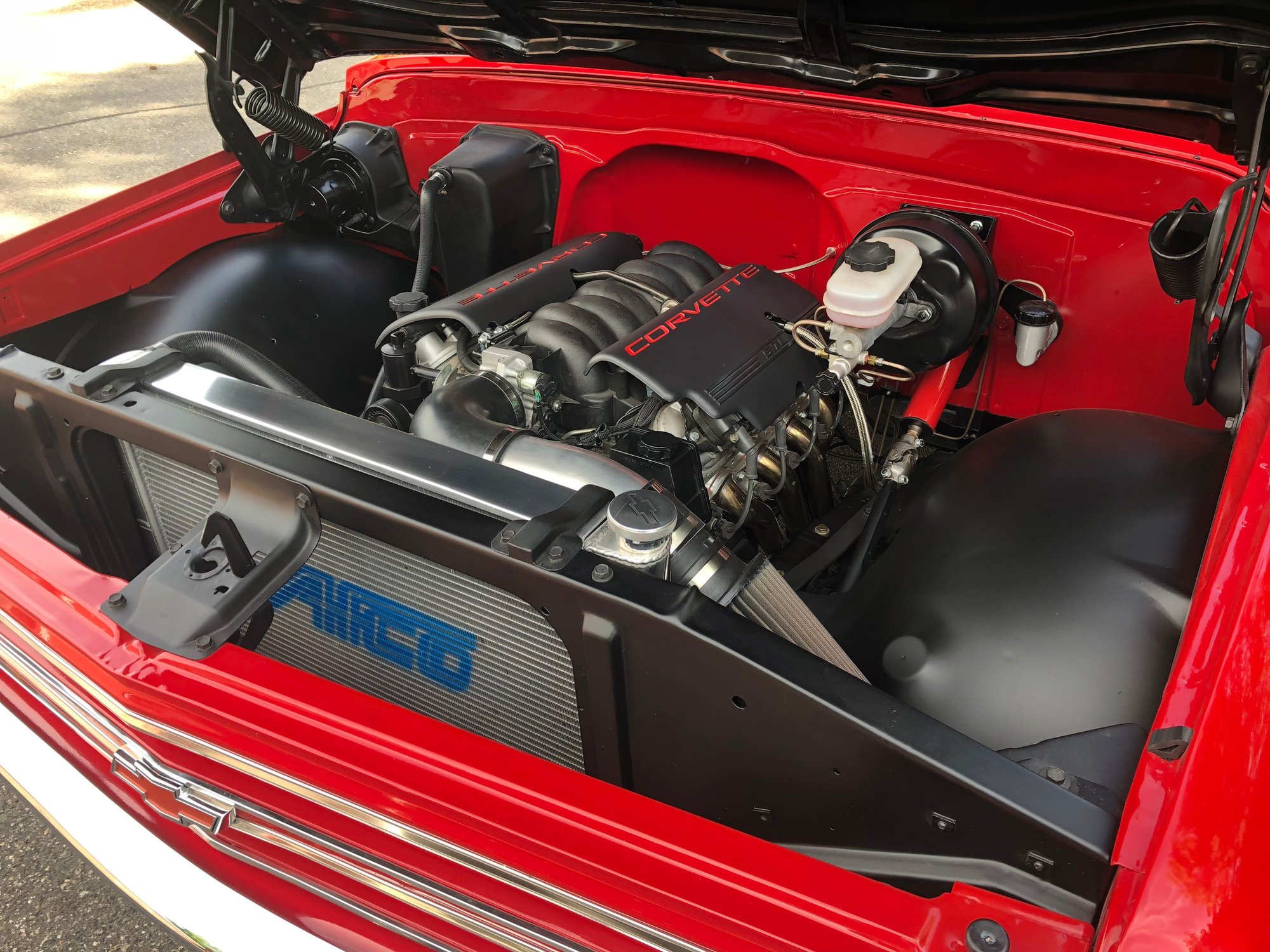

Not an 82 but on my 68 C10 with a LS6/T56 magnum. I added a "high hump" trans cover to make room for the T56. Left the T56 shifter in the rear position. Worked fine.
Pic before carpet. I used a LS7 clutch and pressure plate. 2002 Camaro slave cylinder. Wilwood 3/4" master.
