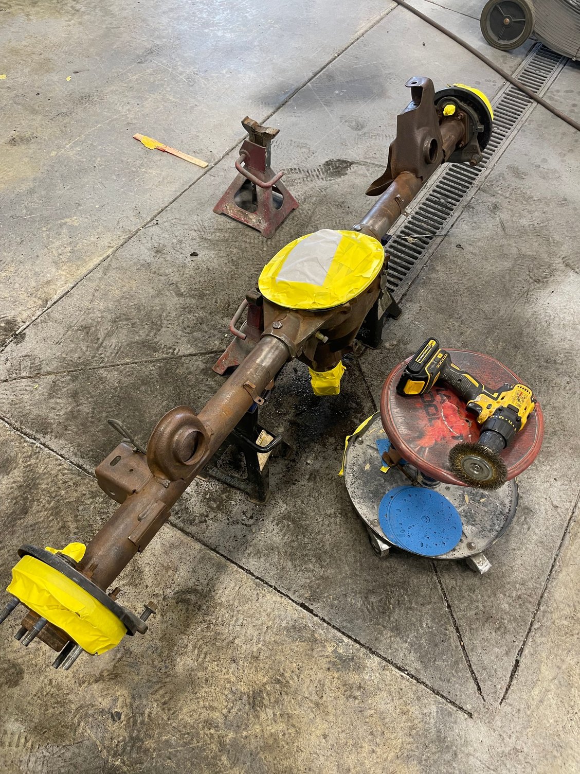

3.73 it is! I pulled the whole assembly.Gonna clean up the housing maybe spray some POR 15 on it while it’s out. What fluid / friction modifier are you guys running? I was told the bearings don’t like synthetic even tho that’s what GM says to use?

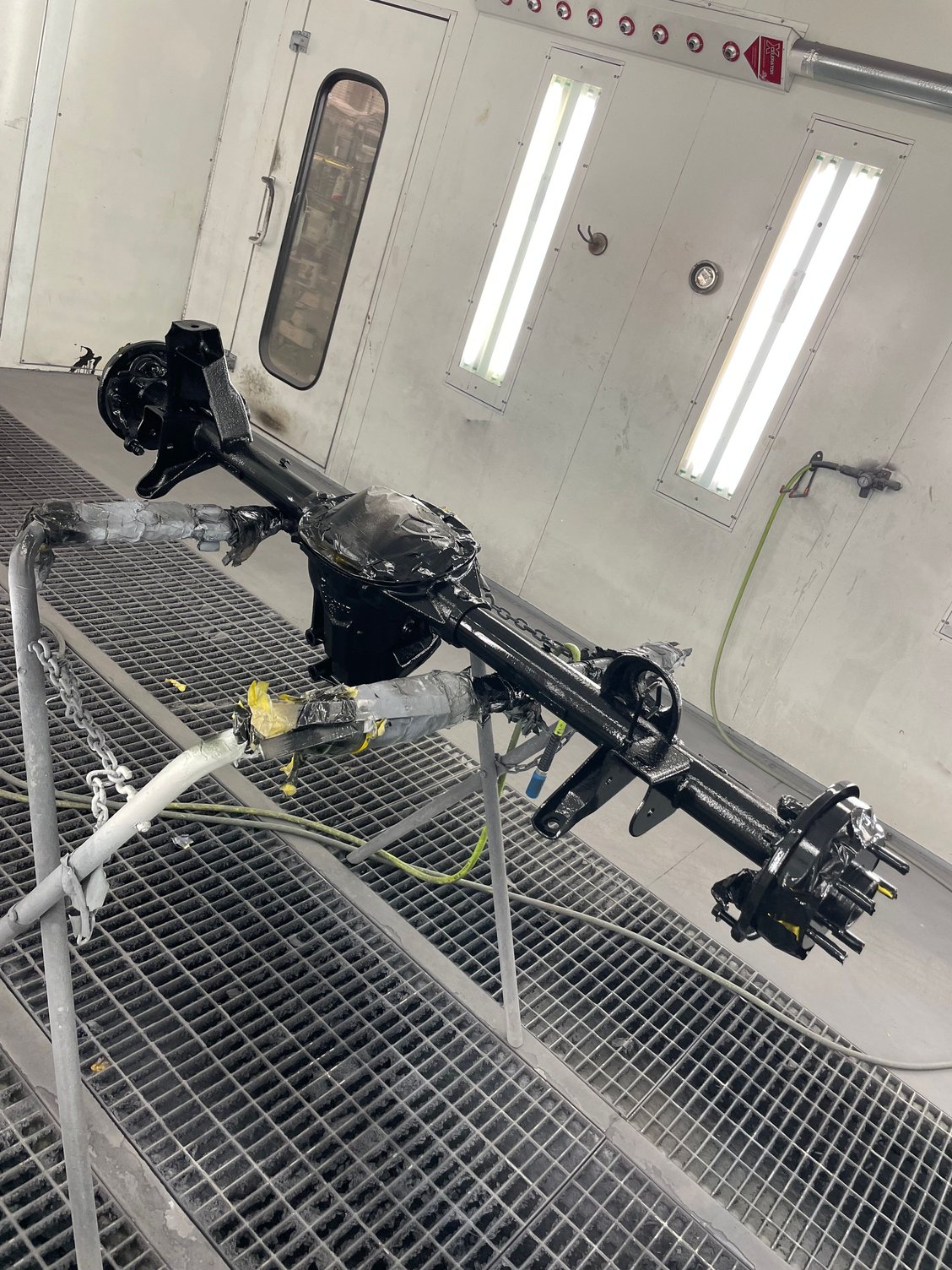

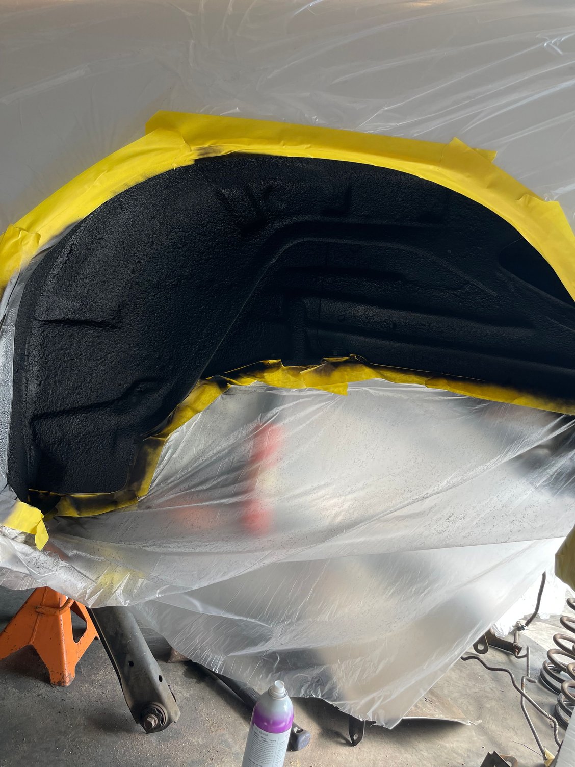

Cleaned up the housing strategically over the floor drain then sprayed it with Rustolium reduced down to spray through a 1.3 3m accuspray. I’ll clearcoat it in the morning. Just waiting on the bearings shims , crush sleeve etc . And gotta get gear oil and additive then it’s go time.
