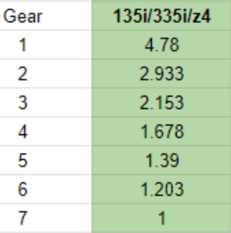

I'll have pictures later this week. Here is the information you requested:
Tire Diameter - 18x10 (265/35-18)
Compound - 200TW Vitour Tempesta P1 P-01R
Gear ratios:

Question, what sorta racing are you doing with this? Per the power level you are seeking, I would lean towards the stock crank build, but if its a drag car, cubes help. That's a midget cam for a race car, even on a stock 5.3. Give more info on what you are doing with the car and can make better recommendations.
It will be for GridLife time trials and local HPDE events. No drag racing
