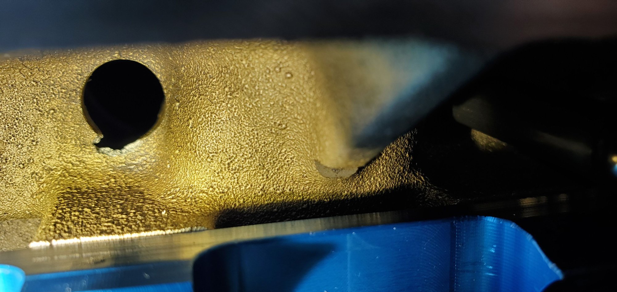

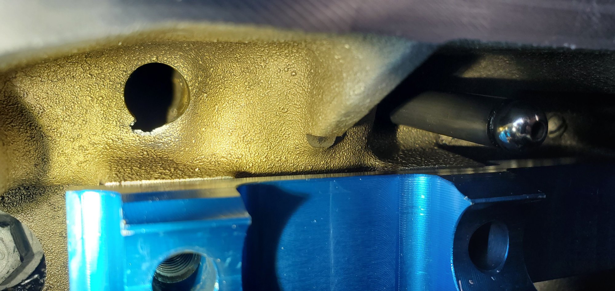

Hey everyone, one of the pushrod guide slots is chipped. The metal did not fall in the engine, it fell outside the slot and was able to be retrieved. Is it possible to still run it like this?

Since it's not really a "guide slot", only a clearance hole that the PR never touches usually, should be fine.
Looks like a PR bent or something in a past life and the PR hit it. Not an issue now.

Great news, thanks for the help!
