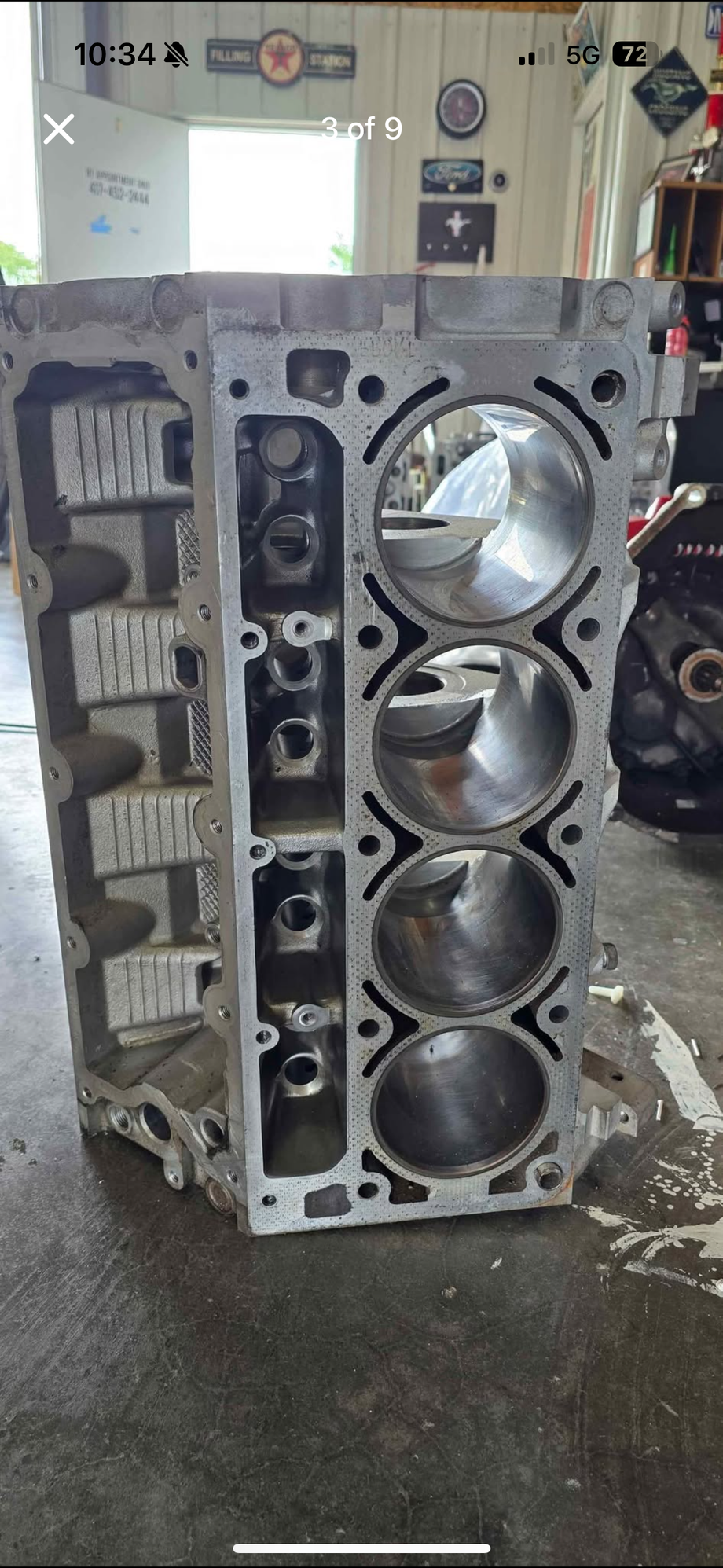

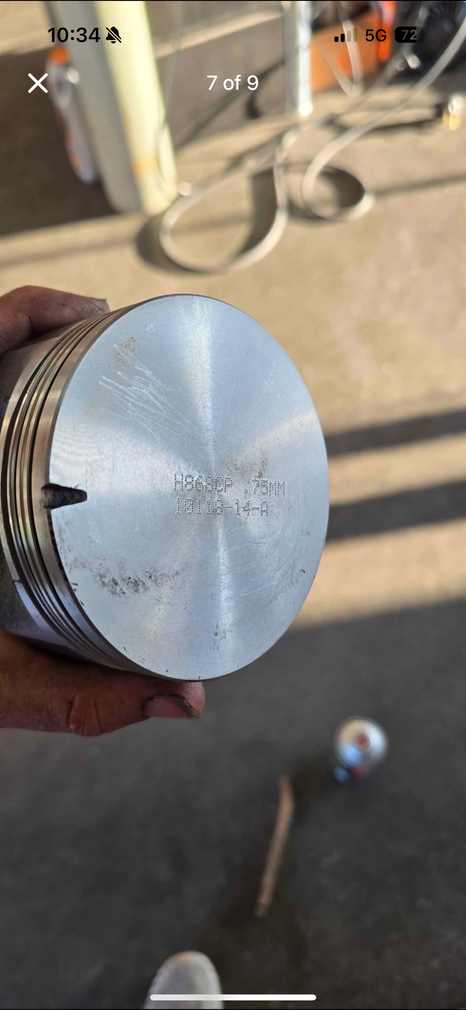

That's what I told when I bought it, Ive got pistons that are 0.75mm bigger and it 0.75mm in inches is around 0.029/0.030
block that's been bored over
Pisonts in question
Pisonts in question

I would like to see a caliper across the top of the cylinder, measuring the bore. It's more likely to be .003", not .030" over.

once I can get a gauge and measuring tool I will post what it shows... I fit the pistons in which are 0.75mm oversize and they fit so I would assume it really is 0.030 over

They do make pistons that big as replacements that are sold in .12mm, .25mm, .50mm etc etc, but the machine shop needs to know better that it will not work. I take it they don't work on many LS? That block is now a paperweight.

I'd be curious to know what those bores measure out to be as it looks to still have quite a bit of sleeve there. Have you measured to see if those pistons will go into the bore?

I found these on Summit Racing for a 3.927 Bore. 1.5, 1.5, 3.0 ring pack. These will work if those pistons fit that block and everything checks out
Hastings Piston Ring Sets 2M5097010

What is the casting number of the block? That should let you know if it's a paperweight, or it's a bored over L33.

I don't think the sleeve OD of a L33 is any different than a ls1 honestly on gen 3 stuff. I highly doubt GM had a sleeve that was a different OD based on extra parts/tooling. Back in the day it was common to open up a L33 to LS1 size sure, but not 0.030"-0.040" past that also.

Lots of L33’s out there at .030 over. Gen3 and Gen4 5.3 aluminum block liners can go .040 all day. I’d bet $10 this block is an L33.

I found a set, don't know who chanced a LS1 to go .030" over but there are Pistons out there for it.
https://www.jegs.com/i/Sealed-Power/...P75MM/10002/-1
I don't have the casting number wrote down anywhere easy for me to send, BUT I have looked it up it shows as an LS1 and the guy I bought it off of said it was out of a 2002 Firebird.
I have fit the pistons into the block on to a crank without rings and they tap in just fine, personally I don't know what to thin piston walls would look like but they look fine on my end.
