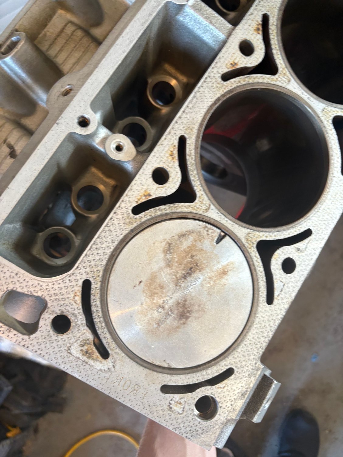

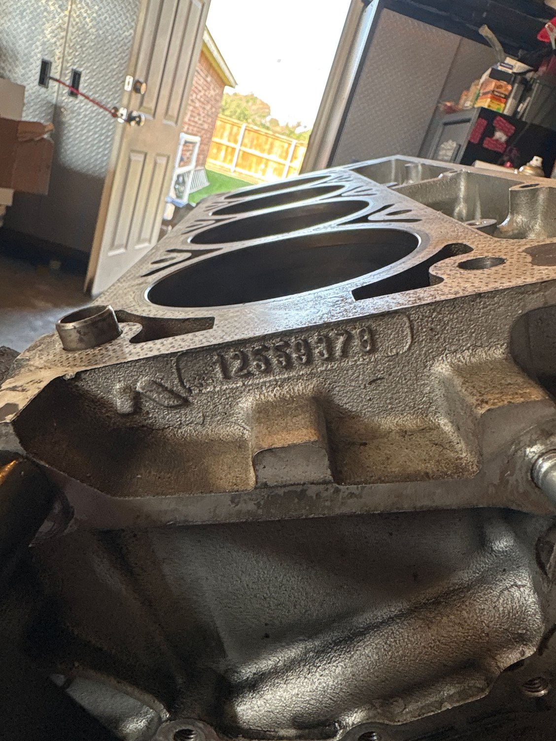

I don't have the casting number wrote down anywhere easy for me to send, BUT I have looked it up it shows as an LS1 and the guy I bought it off of said it was out of a 2002 Firebird.
I have fit the pistons into the block on to a crank without rings and they tap in just fine, personally I don't know what to thin piston walls would look like but they look fine on my end.
You could never tell, the top of the sleeve is thicker than the actual sleeve it has a "hat". The early blocks from 97'-98' were listed as 0.005" from GM and the later 99'-04' blocks up to 0.010" from GM. I could see going 0.010-0.015" on the early block and it might live, but not 0.030" Have it sonic tested if it will even pick up at least the sleeve..

I'd be curious to know what those bores measure out to be as it looks to still have quite a bit of sleeve there. Have you measured to see if those pistons will go into the bore?
I mean by all means it slides in there

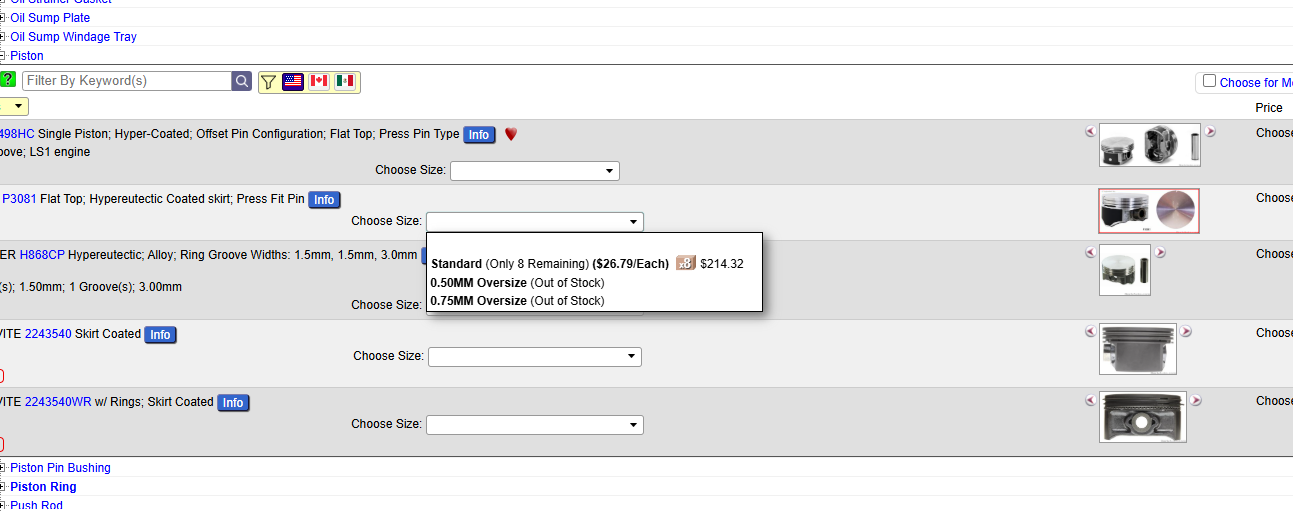

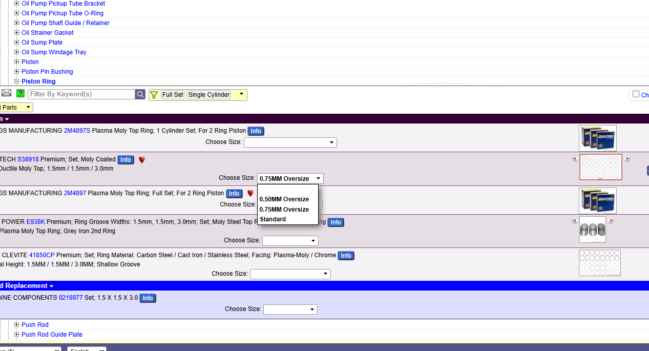

Pistons of that size are available on rockauto, ebay etc, they are probably Enginetech. Edit below are some rings and pistons in 0.75mm

yikes it looks like you may have been scammed, I would assume the guy you bought it from found out the information these guys are telling you and quickly sold it off. Definitely looks to be an Ls1

Could it be that this particular LS1 block was re-sleeved? I know that back in the day they used to re-sleeve and build 427's from an LS1 block.
At this point I'd run it with a chance that you're running this on borrowed time..

I bought a set of .030" over rings for an LS1 from Summit Racing about 12 or 14 years ago.

I mean….just because the ring package is 1.5x1.5x3mm for a 3.898” bore doesn’t label it LS1. I just bought a ring package in that exact dimension for an overbored 5.3 iron block build. I could have gone another .030 and found rings easily…but it doesn’t label my build here an LS1. Total Seal, Hastings, and just about any other known reputable ring manufacturer will build…or even prolly has in stock…any ring in just about any dimension you want.
