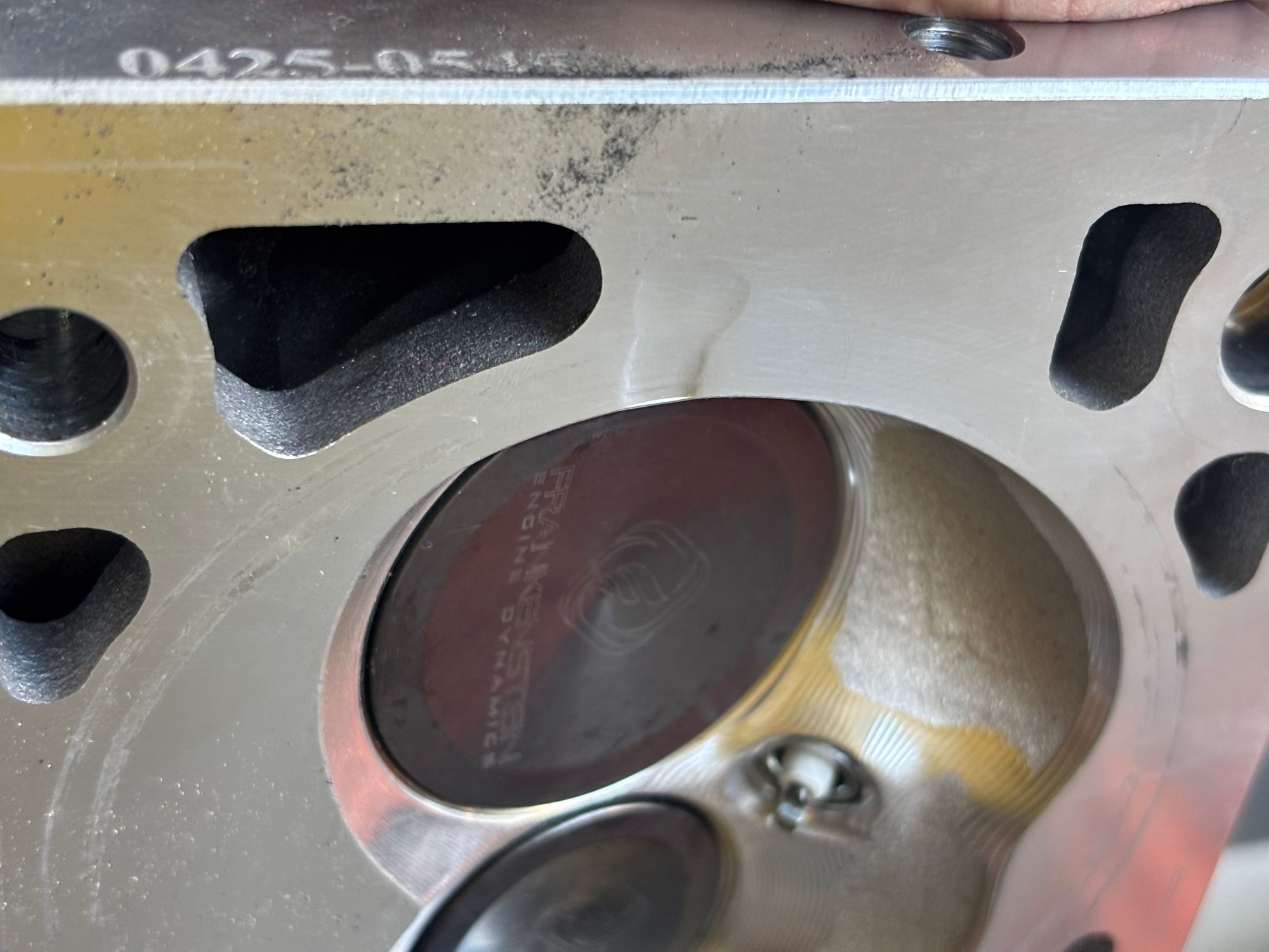

Can this head be remilled? Or is it and the block ruined?

Both can be milled to correct. You’ll lose a LOT of chamber CC’s cutting the heads, which will mess up your target static compression ratio. I can’t see enough of the block from the pic to tell how bad it is. May I ask what happened here?

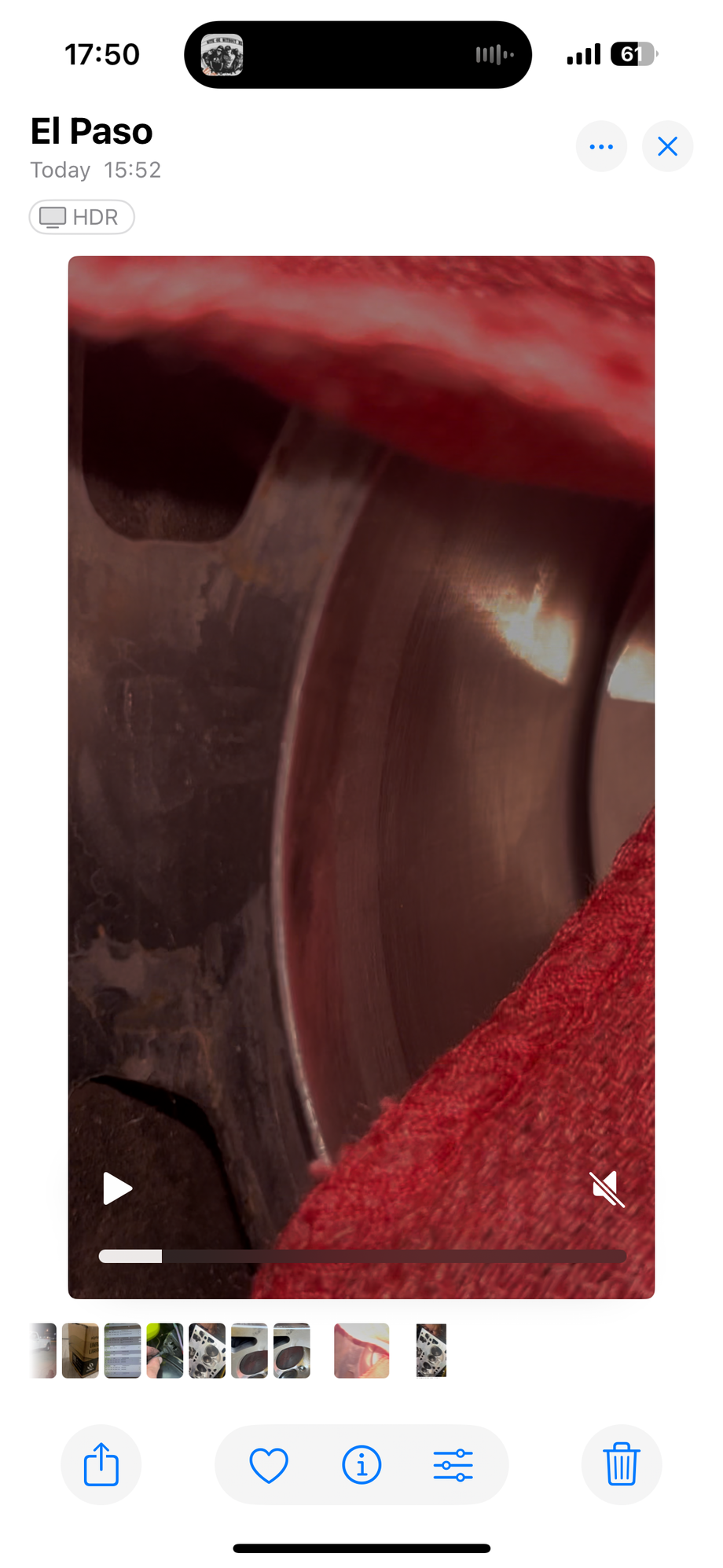

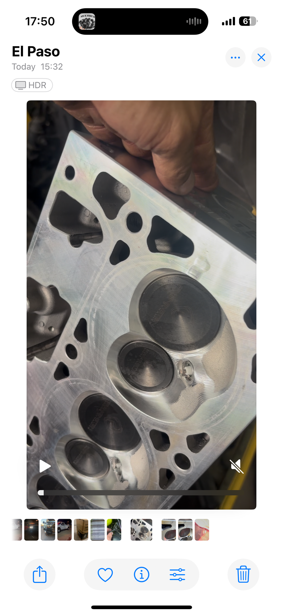

Coil ground got caught in between. I tried attached a video showing the block but it’s too large.

Had to shorten the video but hopefully you can see

I can see it, but can’t tell anything. If there’s an indention there, you’ll have to have it decked. It’s all gotta come back out and back apart unfortunately.
not in a position to take it apart right now-what’s the worst case if I mill the head and throw it back on? It’ll leak coolant into the chamber? Just need it able to drive onto my trailer for now.

Can you winch it on the trailer? It will never seal up until you have it all machined. Have your machinist check the head for flatness…it might have tweaked it if you had it torqued down with the ground wire under one end.
Worst case, don’t put any coolant in the engine…you’ll only be running it for a minute or so, I’m A$$uming, to get it on the trailer. Wont hurt it to run it without coolant for 60-90 seconds. Put a note on your instrument panel reminding you of no coolant in engine…in case it’s next spring before you get back to this and forget that there’s no coolant on it.
