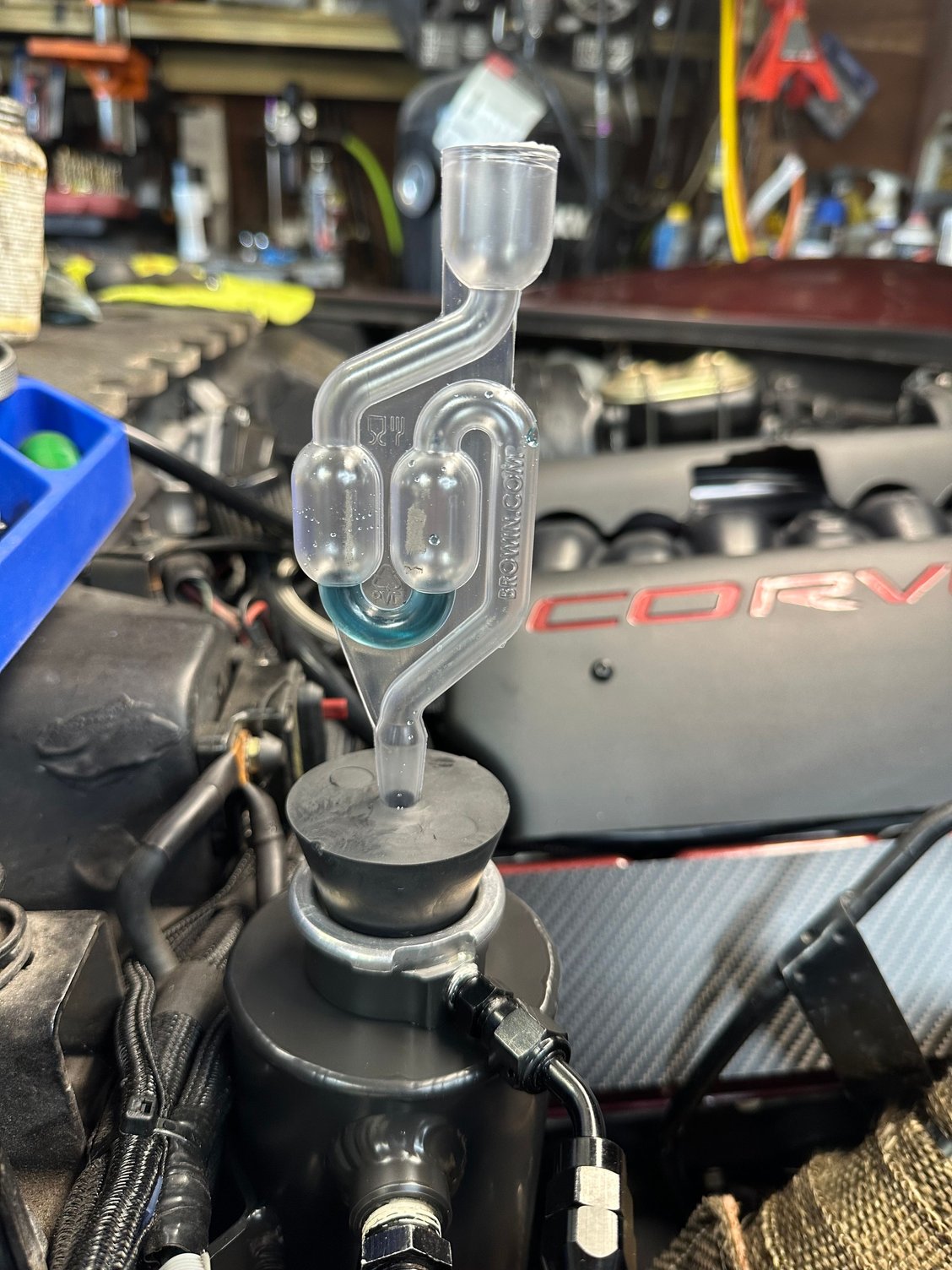

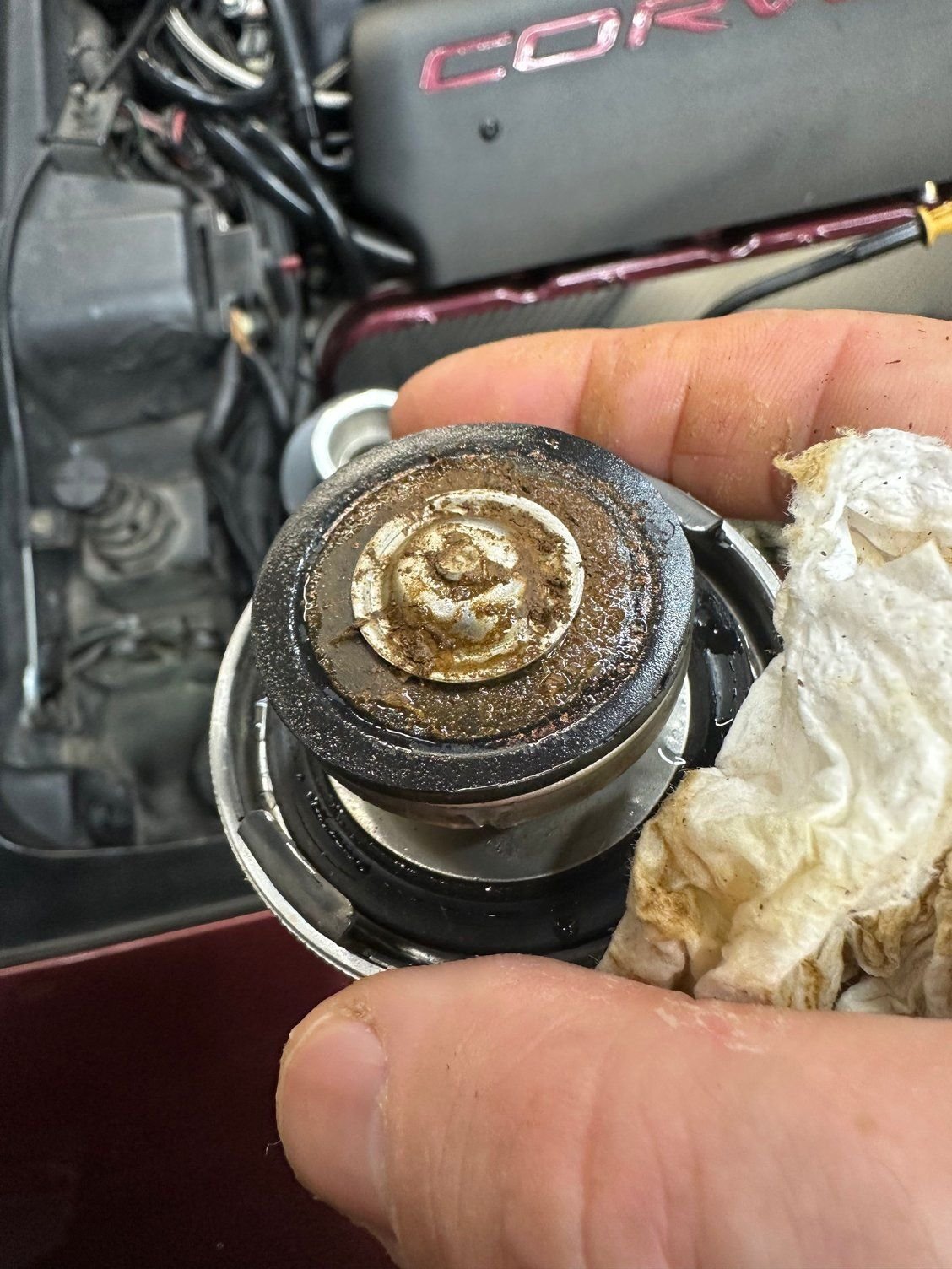

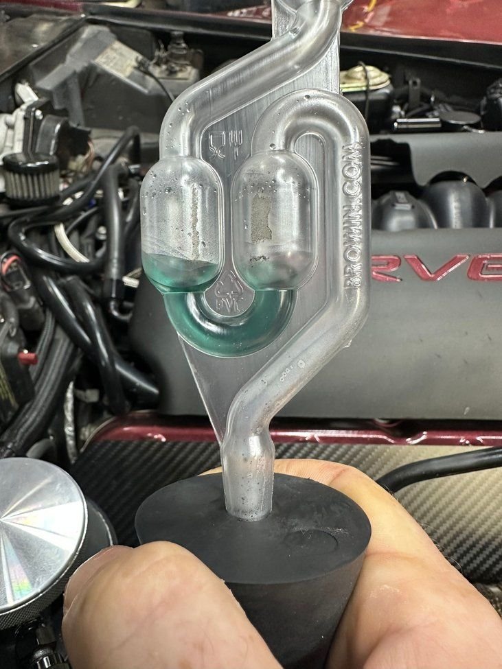

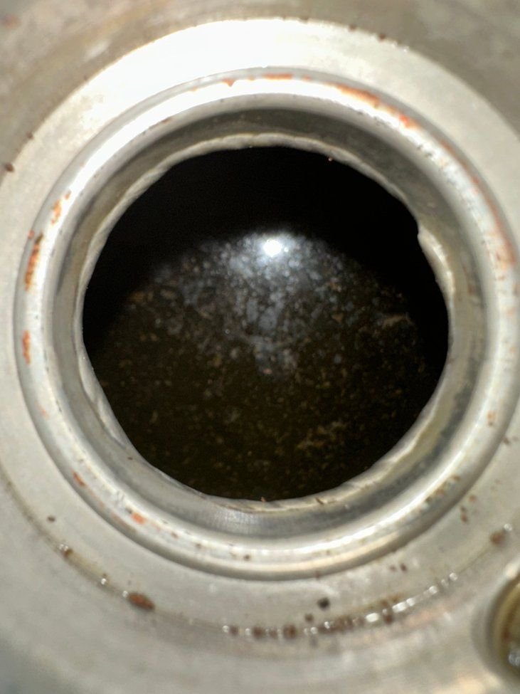

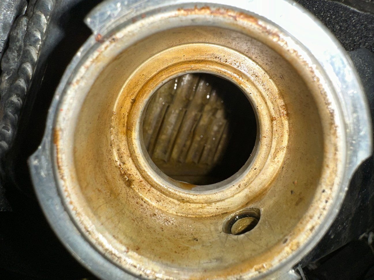

Been driving the car a lot this past week, prob 4 days and 160 miles. No issues with cooling or anything. Decided to pop the cap on the remote fill tank and got some crud on the bottom of the cap. I took a look down in the tank and fluid was slightly low and had a film in the tank but not a whole lot floating in the fluid. Fluid did not look as "clear" and more murky. I pulled the blank cap on the radiator and took a look which had the same film but not stuff floating in the coolant. I did put the coolant gas tester on it and ran the car up to operating temp for a bit, fluid color lightened a little but never really went yellow. I have to hold the rubber cap on the overflow and I will get a small bubble to push the tester fluid maybe once every 3-5s.
Overflow cap, looks not as
Overflow cap, looks not as "oily" like it was previously in this thread.
This is looking in the overflow tank (not the radiator)
Radiator
Radiator
tester after 10 min or so idling and light throttle blips.
