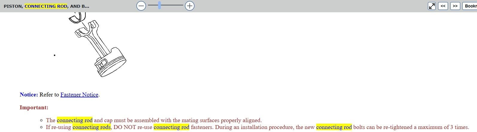

I thought gm rod bolts are one time use? Can be torqued up to 3 times to check bearing clearance during assembly, but need to be replaced after in service/use.

Thanks for the info on reusing. The GM service manual states that they are TTY, not TTA. But I appreciate the advice.

Im going to be the A$$ using GM words from that manual. State that they are TTY not TTA which is technically both one in the same if you want to argue semantics but my point is " how can one TTY a fastener 3 times in assembly if the fastener is a TTY type" ?

Agreed that a TTY fastener is a one time use fastener. You can not use it 3 times. I believe the wording is incorrect in the manual….but who reads manuals?
