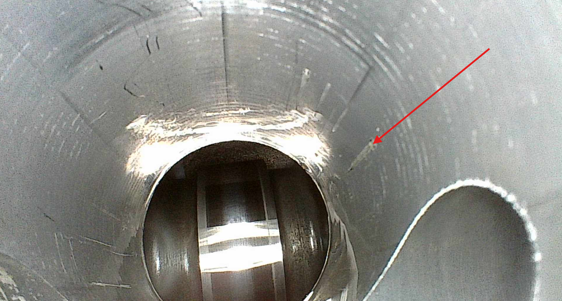

Update: well, I found where some of the tip of that valve went... All lifters checked out on the driver side, the rollers spin without issue, but cylinder 5's intake lifter had some impressions on its roller that appear to match the same steel that came off of the valve tips.
Cylinder 1's intake lifter was a different story, it was stuck in the bore when I tried to remove it. After oiling it and spinning it, I was able to get it removed. However, I found tiny chunks of what I theorize to be steel (I sadly didn't save the debris to check it....). Those tiny chunks were causing the lifter to not want to come out - however, nothing was found on the roller of the lifter, and since cleaning out the bore, the lifter slides in and out normally now.
The bore does have one spot that I can feel (the one I point out with the arrow), the other markings in the bore are smooth (and appear to be cosmetic marks)

If you had the engine tore down, I would run a cross buff down that lifter hole at a medium rpm with quick up and down honing motions, a few strokes. You don’t want that burr you can feel to cause binding…which it will if you can feel it by hand. It will gall up and cause you binding issues if it’s not addressed. Typical lifter bore to lifter clearance is .0015.
But since you don’t have this thing tore down, I don’t know what to tell you, as far as getting that burr out of there. I measure every lifter hole on every build with a dial bore gauge to tell me what’s going on. Never assume it’s going to work out by itself…it never does.
Would you pull the motor if this was your motor?

Hmm, been doing some thinking, it does seem possible to smooth it out with the motor still in the car. I would just need to set up a method to catch any metal after smoothing it out.

Sorry guys, I had to go out of town for the weekend. I would absolutely pull this engine and tear it down IF the burr is as you say it is. I can measure that burr and make a determination at that time…it’s impossible to tell over the webz what to do here, from my location.

That is the entire issue at hand…cleanliness. Oil gallery is right there. Sticky, oil covered camshaft is right there. You’re not going to be able to keep debris out of harms way…just not going to happen. Having said that, I see guys doing sloppy rebuilds and almost purposely leaving dirt, grime, debris in an engine and it turn out ok in their videos. That’s fine if it’s only gotta run for a few miles. If you want this repair to involve reliability, then if it’s in my shop, it’s all coming apart.
I agree, very hard / basically impossible to prevent debris from getting in.
My current theory is to take photos of the oil gallery with a bore scope to reference to check if it gets contaminated, then take a microfiber towel stuffed at the base of the lifter bore, and use 400 grit sandpaper that has been oiled up with a dowel and make only a few sweeps over the burr. I will check clearance before and after to confirm.
I would then try to carefully clean around anything that may have been left behind over the towel and pull it out. Then I can use the bore scope again to check the oil gallery for any debris that I missed, and then clean it out if I left anything. (Again, this is no where near as good as just pulling the motor, and a massive risk that may not be worth it)
If I do it carefully like open heart surgery, I might get away with it.... maybe. Although I am not a surgeon, but I do have small hands, not having a beer before doing it, should mean I have good chances of success.
