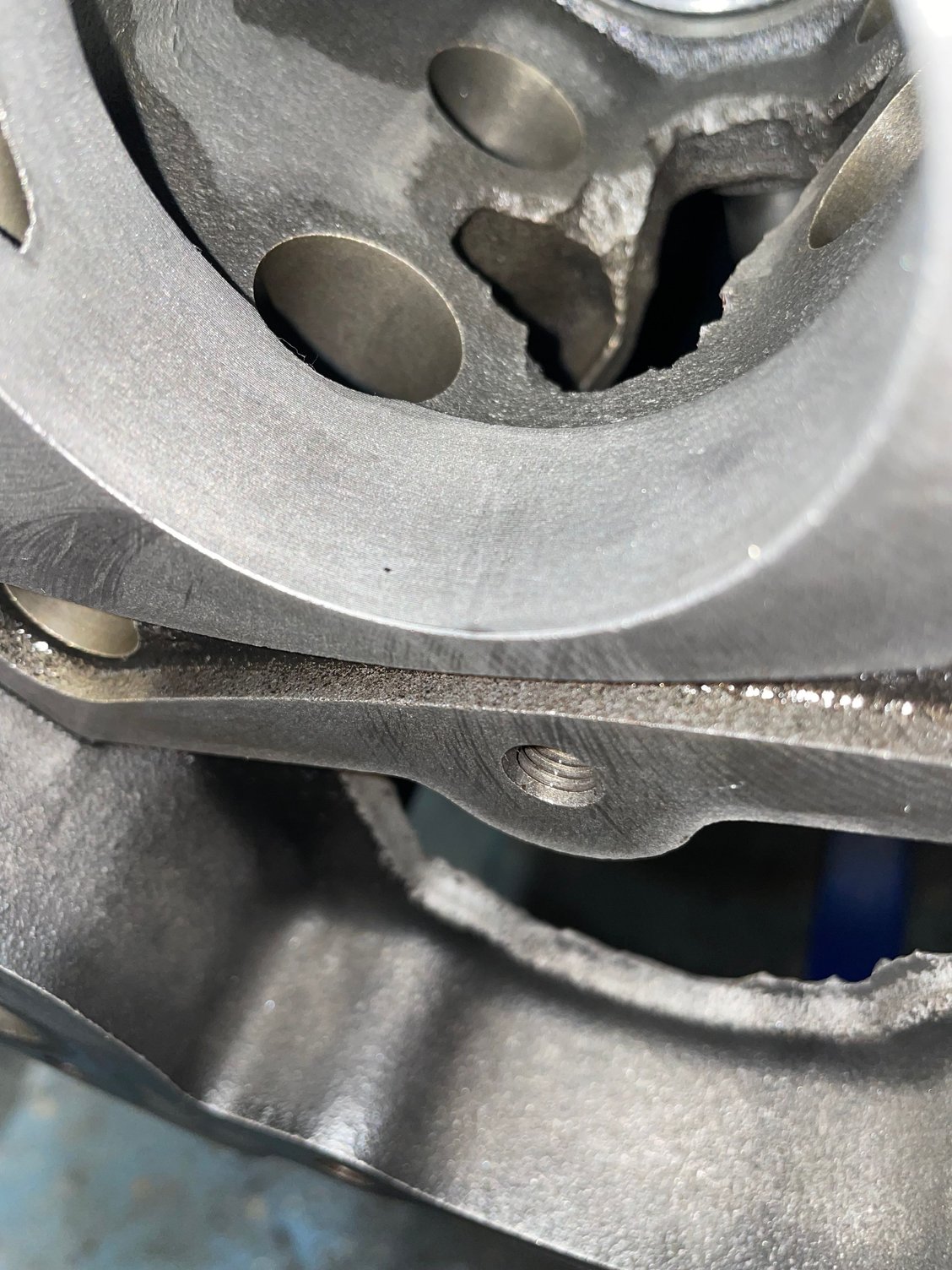

but, my mic is infact calibrated, have blocks on my work that is tested and calibrated down to 0.001mm/ 0.00004in and I test my mic with them. The bore in the block is larger than the spec. No way around it. But what can I do?
yes i know it’s weird that I can see the machining marks and still be out of spec, but here you have a photo of it ( hard to get a good photo)
Old Mar 9, 2026 | 09:29 AM
grinder11's Avatar
Posts: 3,212
Likes: 1,612
From: Michigan & Florida
What caused you to measure the bores? Sorry if I missed it....
