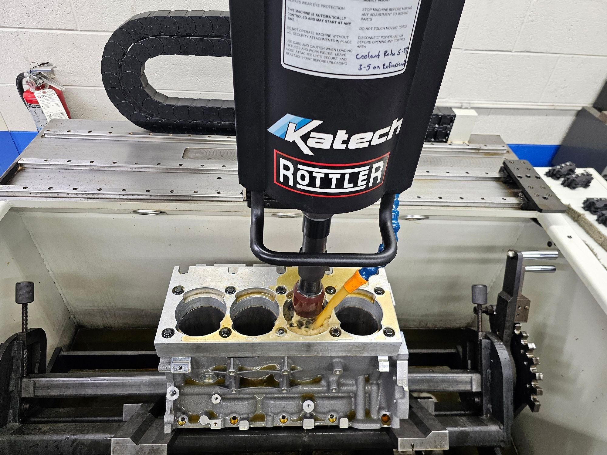

The block came back from CNC for rod clearance and is currently in the hone!
